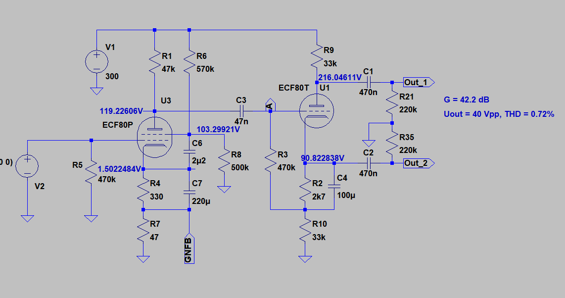

An example of ECF80 amplifier/cathodyne.
The only thing that the simulation shows a bit odd is that the screen voltage of the pentode section should be fine tuned to optimum THD (R6 or R8).
It is possible that in reality this is not needed.

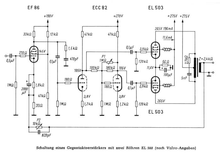

Here are similar phase inverters.

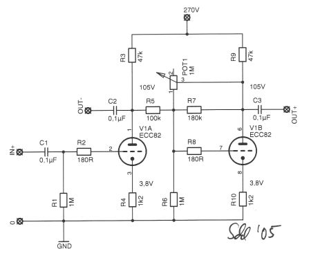

Are the schematics right? Isn't there a coupling capacitor missing somewhere? I would think that the grid of the right hand triode will sit at almost 100 V.
Addition: I think the schematics are wrong (see attachement).
You are absolutely correct. Whoever did those drawings forgot to include a cap to the 2nd grid. Also missed by the proof reader,
something I was exposed to while authoring articles for publication. I often got the sense the proof readers were college level English majors with no experience in electronics at all. In one case they had me inventing something at a time I would have been about five years old, Luckily I caught that one. In another case part of a line was left out by the printer, The meaning was entirely different, And on & on.
In spite of the greatest care there was still an error in the printed final paper product occasionally.

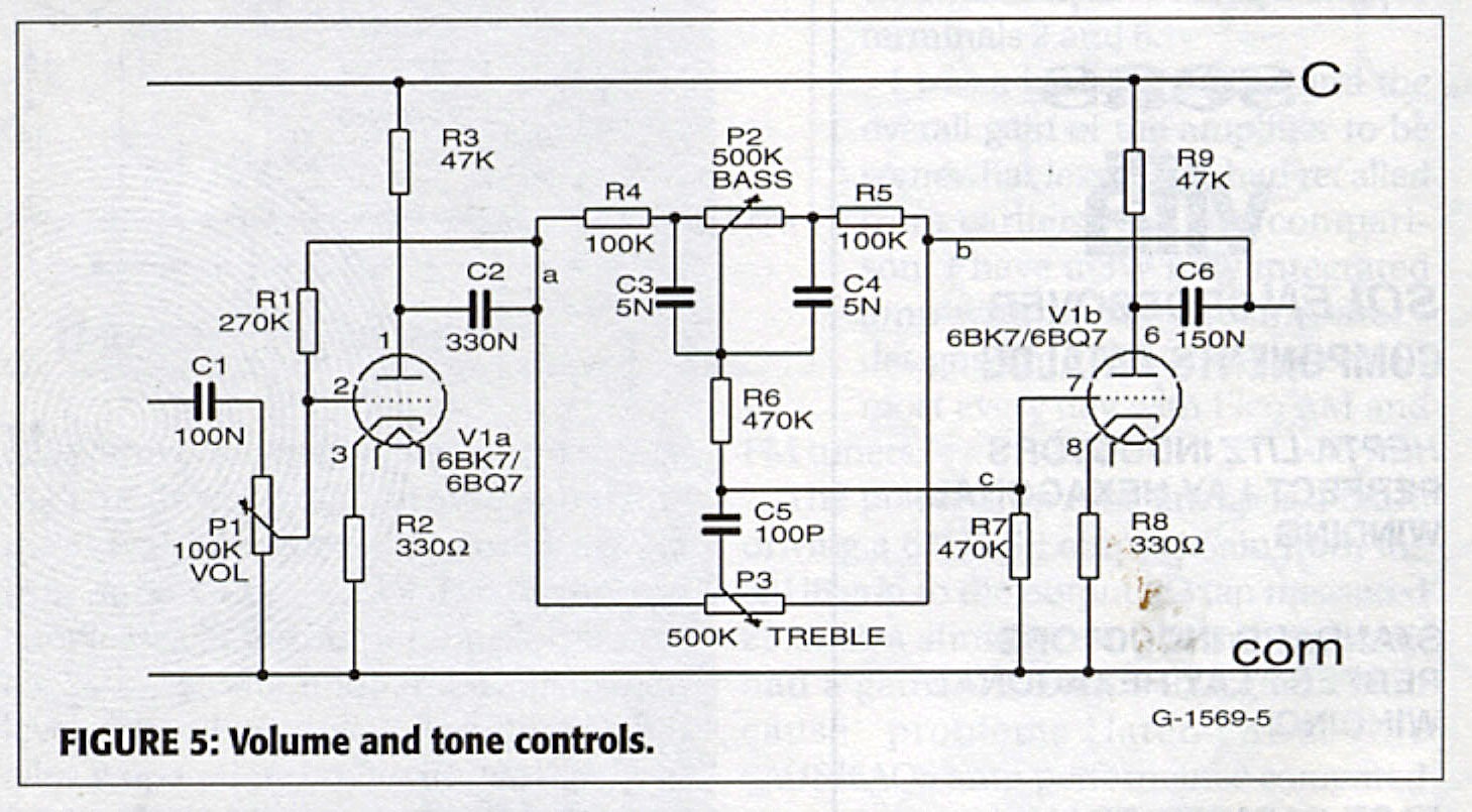

The configuration of those circuits is fairly common. Here it is with frequency selective components where it becomes a Baxandall
tone control.
