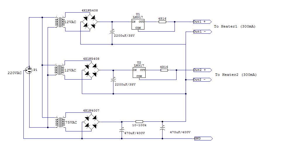

Hi to all,
I made a simple schematic for elevating the heaters of two PCC88 tubes. The cathodes in my CF application have voltage about 70V above ground. I calculated heaters elevation about 30V above cathode voltage. The current sources are calculated for 300mA. Do you have any suggestions for improvement?
I would suggest far more filtering on the heater elevation power supply.
Coming straight off a diode bridge will have some pretty severe spikes, and their HF content will go right through the heater/cathode capacitance and into the signal path.
Result: a 50/60Hz (or maybe 100/120hz) buzz you can't find and certainly can't fix.
As this heater lift power supply will have minimal/zero current drain, I'd put a big R after the diodes but before that big cap you have to gnd. I'd start with 10k, but try even higher,like even 100k.
Regards, Allen
Regards, Allen

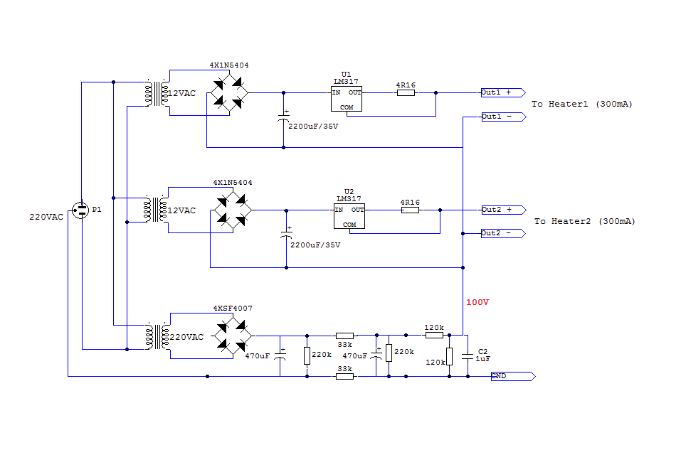

Hi Allen,
Thank you for your reply, i changed the circuit following your suggestion, but made C-R-C filter for even better ripple rejection. I now feed them with floating AC with no audible noise, so i thought that it wasn't critical.
I finally made the following heater supply. The strange thing about it is that the last smoothing capacitor (marked as C2) has an impact in sound.
I have tried capacity values from 0.1μF to 100μF and all sound different.
Large values > 10μF do something like a HF sound rolloff, not dramatic but clearly audible. Smaller values favor HF and subjective audible resolution but i can describe the sound as thinner.
The GND is connected directly to the common star ground of HV power supply and this one is the only connection with the rest of preamp circuit.
Is anybody experienced similar behaviour?
Does it has to do with the fact i'm using seperate transformer for heater elevation or something else?
What do you think ?

Because it SOUNDS better - that's why!
Regards, Allen (Vacuum State)
