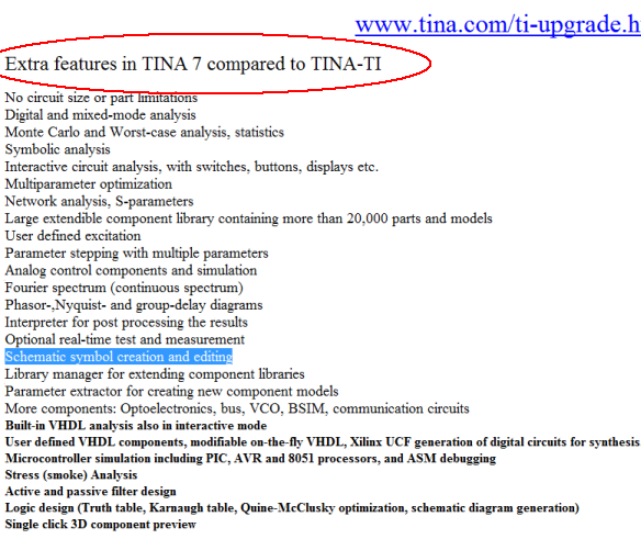

I wanted to use New Macro Wizard in TINA-TI to add ECC88 from the library but in the shape folder-when I browse it- there is no tube shapes. So my question is how can you put symbol corresponding to the models ?

But if you want to edit your own symbols, it looks like you're out of luck unless you fork out some $$.

When selecting Macro shape you get the choice of
(Diode Tube)
(Triode tube)
(Tetrode Tube)
(Pentode Tube)
What more do you need?
I have added 6V6, 12xx7, KT88 etc, you can get an error with shape selection if you don't follow the pin naming convention as described in the link above.
Also to Simulate you MUST include at least one item from TEXAS Library - ie OP-AMP with all pins tied to Ground
I attach zipped folder with some examples put in C:\Program Files\DesignSoft\Tina 7 - TI
You may need to recreate the Macros from the .cir but they work
