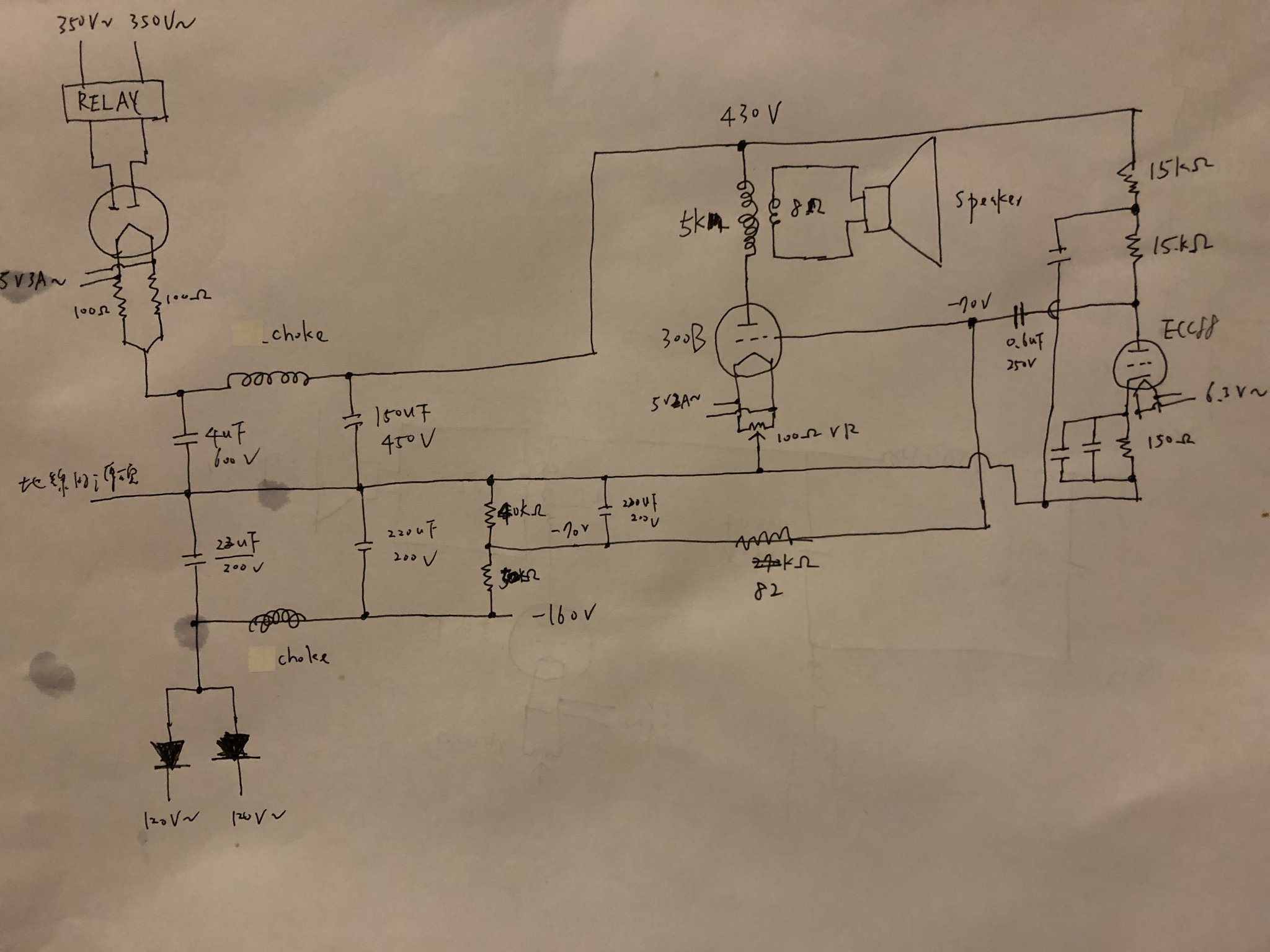

ECC88 (or E88C) 300B SE amp I make
I am making 300B SE amp.
Chassis is 44cm x 36cm
Power transformer is EI 97mm , power is insufficient
Choke is UTC 8H 180mA
Output transformer is EI 86mm
I order the transformers from a forty years old store
I reserve three 9-pin tube sockets for one ECC88 and two E88C.
Currently user can choose ECC88 or E88C to drive 300B by solder.
ECC88's gain is not enough for 300B but there are many brands available so user can find your favorite tone.
I use a small choke (underneath chassis) to build luxury fixed bias voltage for 300B's as you can see in my drawn schematic.
Any comment or suggestion welcome.

I use two-stage ECC88 cathode follower to drive 300B, there are tons of gain ! More than I need.

The 100 Ohm VR affects the tone of the amp quite a bit.
I bypass each arm of the VR with good quality resistors.
I use 5U4G rectifer, my B+ is only 310V, higher B+ yields too bright of a tone for my taste.

a. CCS plate-load is beneficial, i.e. upgrade your 15K resistor to CCS !
b. ECC88 tends to oscillate, add grid-stopper and ferrite bead to alleviate the problem.

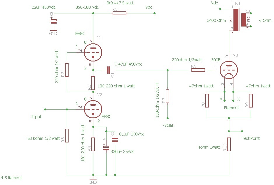

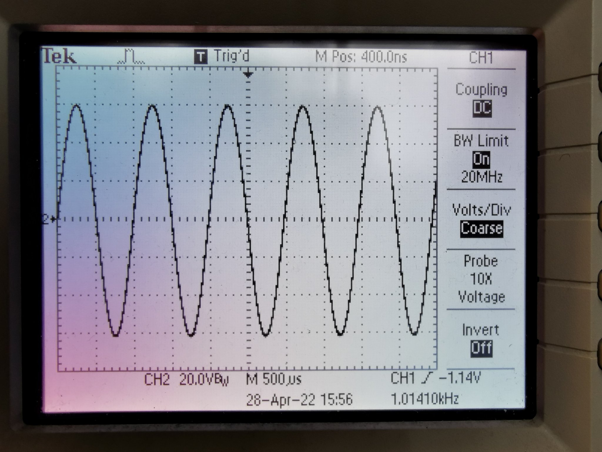

I have tested a circuit with E88C (two) in Srpp, very fine.
The freq. answer is the input stage at 20Vrms out, gain is 45 and his Zout is 1k5 ohm, very good.
Walter
