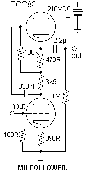

Hey guys, I need to know the output impedance of the attached schematic.
TIA

The original designer?
To calculate the output impedance you need to know the valve operating point so you can find the mu and ra. Then plug these into the formula which Merlin gives on his site.
Then remember that output impedance and optimum load impedance are not the same thing so be clear what you actually want to know.

I haven't looked in detail at the formulas but if DF96 questions them, they might be fishy.
In any case I would consider a 300 or 400 output impedance way too high for a 300 Ohm load. That would mean you loose 6dB of signal. For such a load you'd be better off with 100 Ohm or less, ideally even 50. Which would require a huge coupling cap, bad idea IMHO.

I would not load it with less then 10KOhm.
It can drive a lower impedance but then distortion goes up.
I have build an ECC88 mu follower where i got the output impedance down to 140 Ohm.
You then have to run more idle current.
I find a mu follower a really good circuit :
High gain, high bandwidth and low output impedance.
It was used in output stages of measurement instruments from Rohde&Schwarz and Wandel&Goltermann.
The problem with the SRPP (and hence mu-follower) formula on the linked page is that the author appears to simply put the upper and lower arms in parallel and assume that this is the output impedance. He doesn't take account of the lower valve driving the upper valve, which is the whole point of the circuit!
For the SRPP (and mu-follower) the output impedance and optimum load impedance can be (and usually should be) quite different. It is even possible (I think) to design an SRPP with an output impedance which exceeds its optimum load impedance - so you automatically get a significant reduction in gain when you load it optimally.
