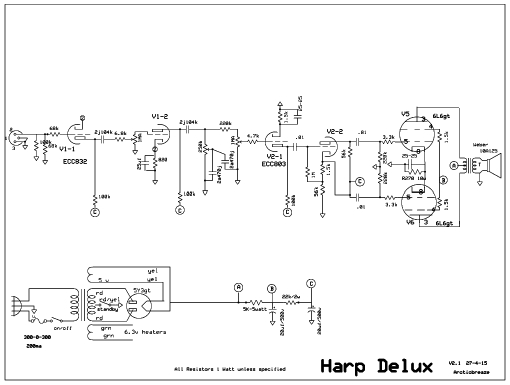

Just got back from jam sesion at our local muso's club amp really nails that chicago sound. lots of grundgy honk and no feed back and loud, sounded great. at the last minute i subed in a JJ 823 as tube 1 (weird tube 1/2 12ax7 1/212ay7) was gooood, but..... it's a bit of a one trick poney dosent do cleean too well, getting there tho.
also it got rid of all the buz and hisssss😀
schmatic
ok this is how the amp sits at the moment 😛 have a look and see what you think. any suggestions on improvements will be a help. its really nailing the Chicago sound, but I might hav to add a clean Chanel and I'm not sure there is room .might hav to build a bigger one really want to add a re verb tank too
