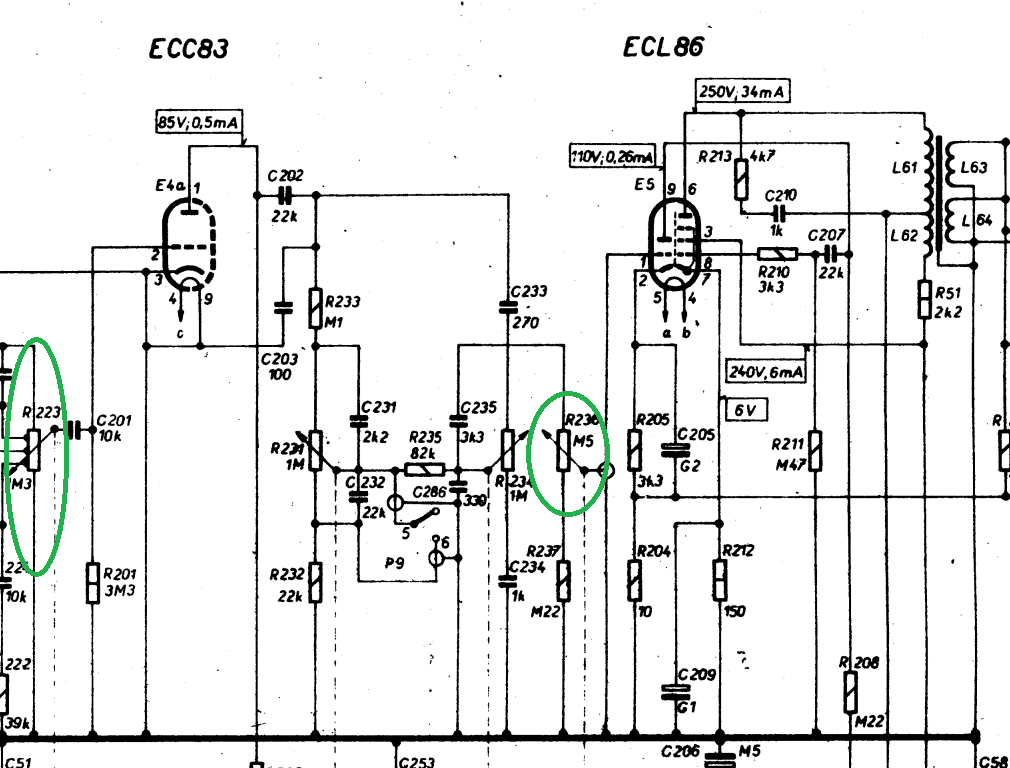

The ECL86 already has a high gain triode inside. Two more stages would create a huge gain and the related issues. What kind of signal source would you have? You can make a single tube single ended amp with an ECL86.
To be honest in page 24 you have a separate PCB board with the stereo audio amplifier. You can probably throw away the radio part, and just use that board. Adding a volume control there is very easy.
PS You do have a volume pot already, the left one. I'm not sure about the pot on the right, seems like also a volume control, but weird, and could be part of the tone control instead.

Thank you for your reply :)
That's exactly what I ment to do.. take the amp portion out .. but there is something wrong with one of the channels.. and alas something broke or shorted when I was pulling it out. to identify what exctly would be a challenge for sucha noob as i am. That's why I have more or less decided now to do a point to point wired ecc83-ecl86 amp for guitar. That ecl86 has a lot of gain is good news for me..I understand the ecc83 too. I like a lot of distortion :) But as it was in the radio i ment to use ti with a distortion pedal.
The poit on the right is the stereobalance - balance between one 86 and the other 86 - between left and right. That's a pot that I would have removed.

I have been staring at it for hours dude.. i have been also trying to isolate or track the signal path from the gramophone input (which i would use as the guitar input) to the ecc83 which i might have but i dont see clearly what happens to the signal after it.. does it go to the pin 1 of the E5 -86 ? then i am lost completely.. there is so many connections and there are so 15 switches on the radio all kinda interconnected... so the schematic to my noob eyes is a maze. That's why i might really and up point to point wiring only the two tubes. Even though I first thought what you suggest would be fairly easy..

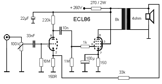

Could i do , for instance something like this (with the two triodes?):
and then from the out it would lead to the IN pin of the ecl86?
The voltages are way different tho.. would it make a big difference in sound? or would lower voltage (in my case) than the ona in the picure just mean fewer Watts?

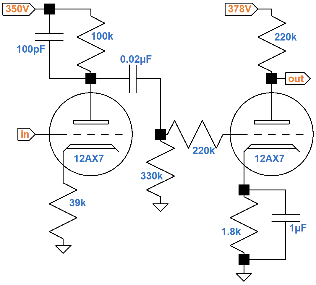

could this kinda preamp be just put in front of something like this (i understand the little bullseye symbol means an input)?

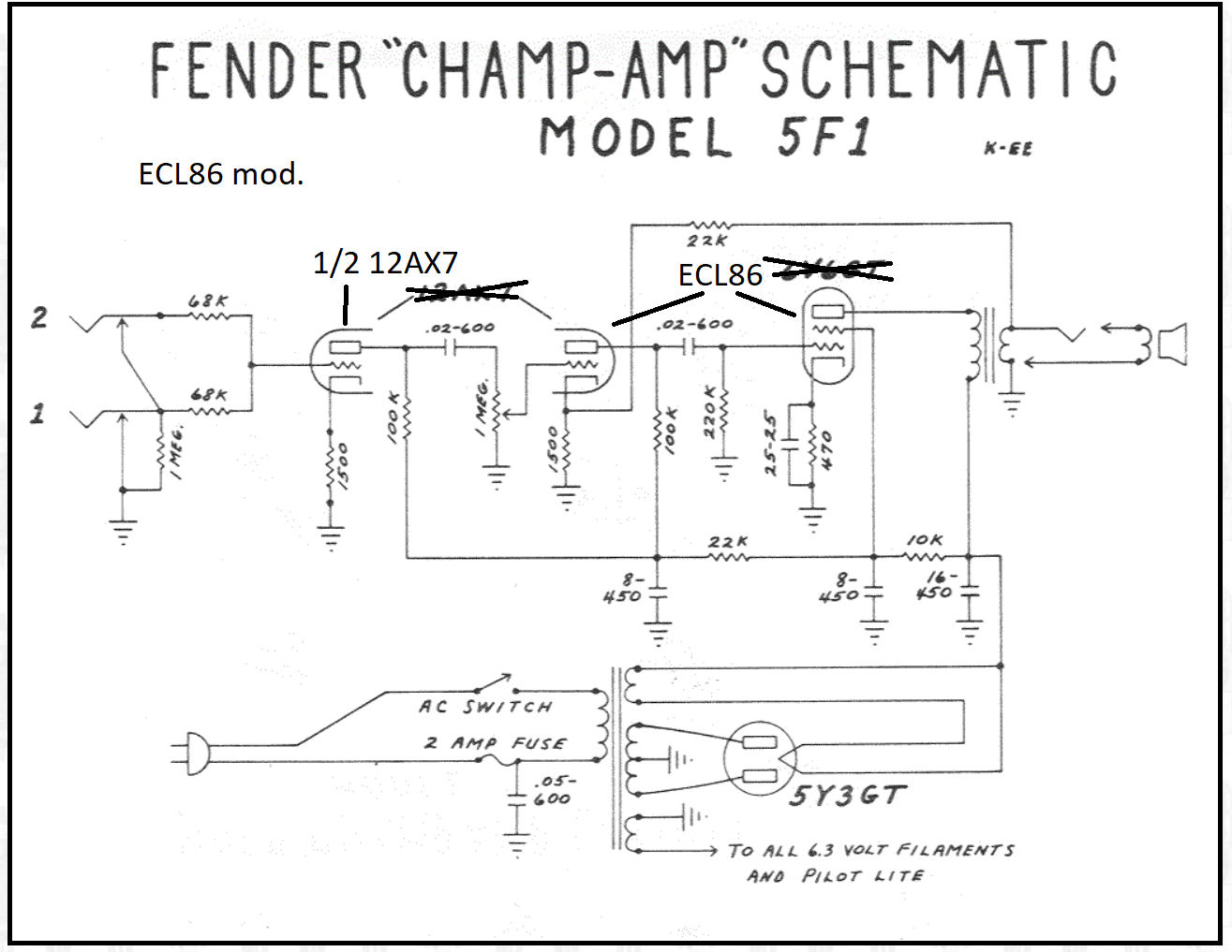

About the schematic you suggested, you got the right idea, but the execution is not right. I would recommend first to have a good reading about the basics, for example:
https://robrobinette.com/Reading_Tube_Amp_Schematics.htm
There is even an schematic of a Fender amp that could be the base for yours (I pointed out where can you use your ECL86):
You could even use both channels with two speakers, more power. In total you will need two ECL86s and one 12AX7.
This is just a suggestion of a person not familiar with guitar amps, it would be better if you follow the advice of someone who knows this well.

. 02 is 0.02uf. 600 is the maximum voltage. A modern common equivalent will be 0.022uf 630V.
And yes, that was my suggestion. The ECL86 already has a high mu triode inside.
Or you could replace the ECL86 with an EL84, and use both 12AX7 triodes. There are endless possibilities.
But you already got the ECL86s, maybe better to stick to that.

In the princeton there is one triode of an 12ax7 used as a phase inverter for the following tubes to be push pull, do you think it would be possible to use (in my case) the first ecc83 triode for preamp then put a tone stack or just volume and then its other triode to do the phase inverting so that i could use both 86s as push pull? in my radio they work as separate stereo channels one for each side..
EDIT : ... yes.. looking at the DELUXE now and it is just in there :D sorry.. and thanks a lot for the page.. :) its so good !

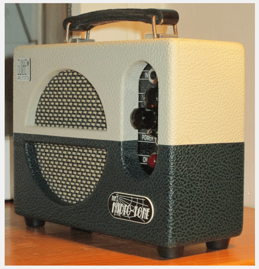

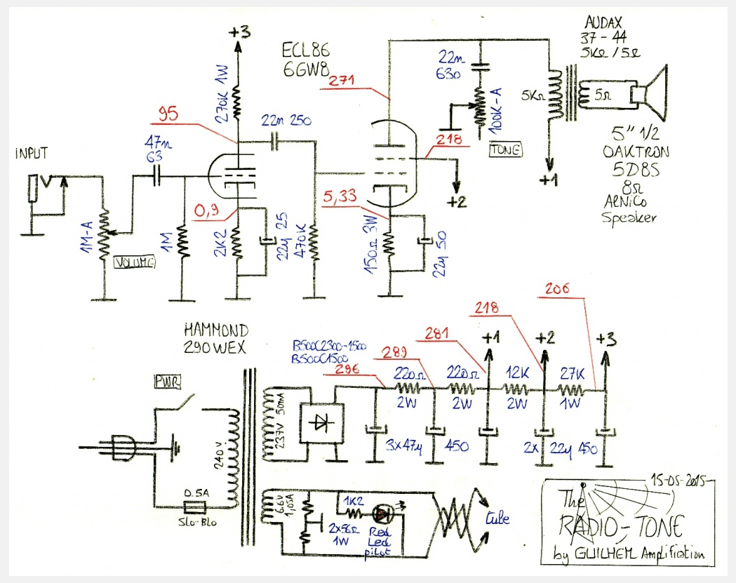

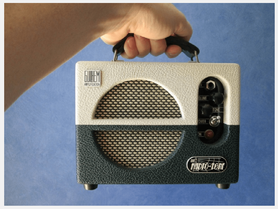

@Klingy : have a look to the MAGNATONE guitar amp schematics (i.e. Model 411) : they much used the 6WG8 / ECL86 in SE or PP...

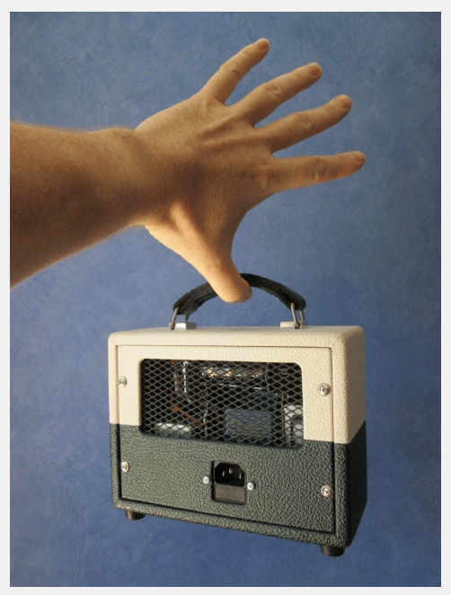

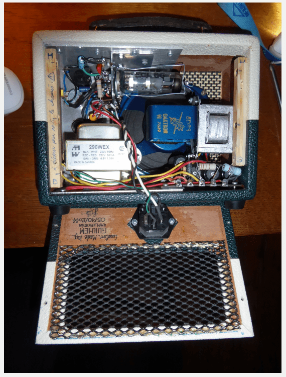

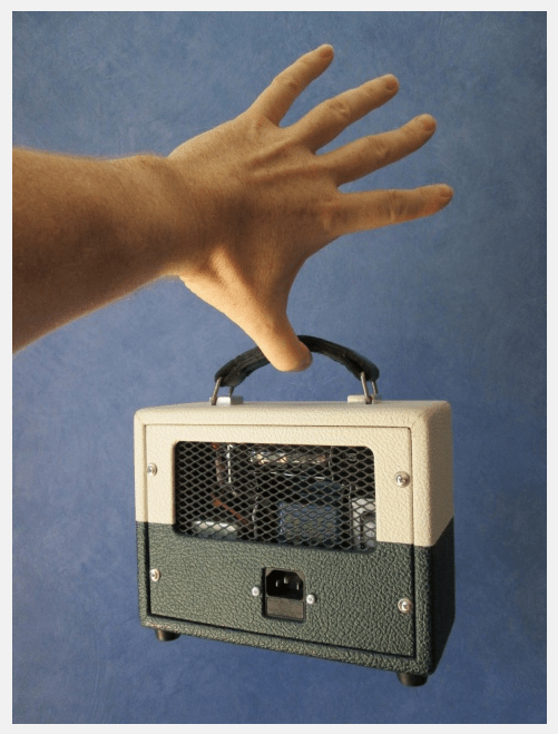

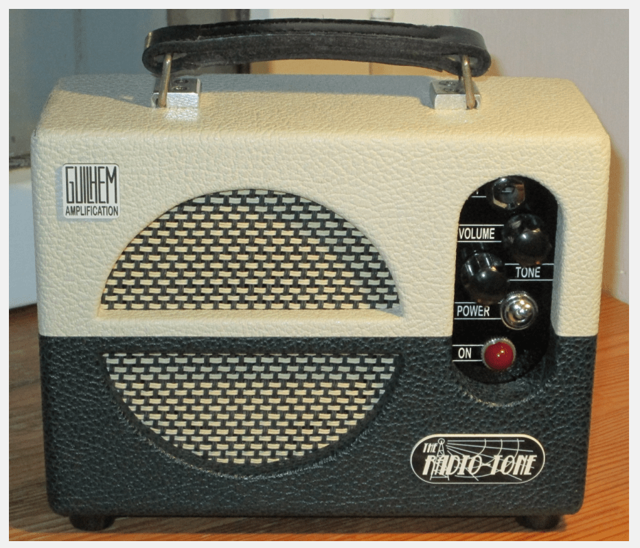

My RADIO-TONE (below, DIY) uses a single ECL86 in a super small but standalone package :
Here is the schematic - derived from the Magnatone model #411, by the way :
Here is a sample of the Radio Tone. Guitar = Squier Std Strat, with a touch of EHX Cathedral Reverb.
https://soundcloud.com/tubelectron%2Fr05-0002-radiotone-squier-cathedral-bluesmp3-1
