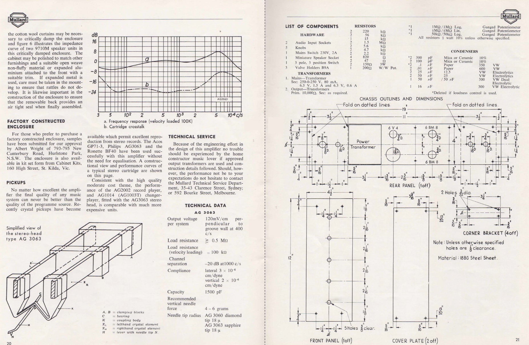

Still reading, watching, learning! Thinking about chassis layouts and materials to use. An easy and cheap source of sheet metal is obviously cake tins/pans and baking trays from the pound shop. How much of an issue is it using a magnetic material for the chassis?

This is the kind of thing I'm aiming to build (pic bellow). The cake pan is literally a source for the flat sheet metal as it's so cheap in Poundland etc (UK). I would just cut the sides off and cut the flat part down to required size. I want the transformers to sit on top. I'll have have a think about ways to cover the transformers as the ones in using are definitely not designed to be exposed. The tea/coffee tin idea is a good one. Or something of the same principle but more aesthetically pleasing.

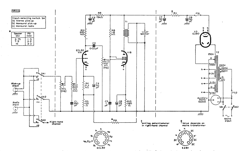

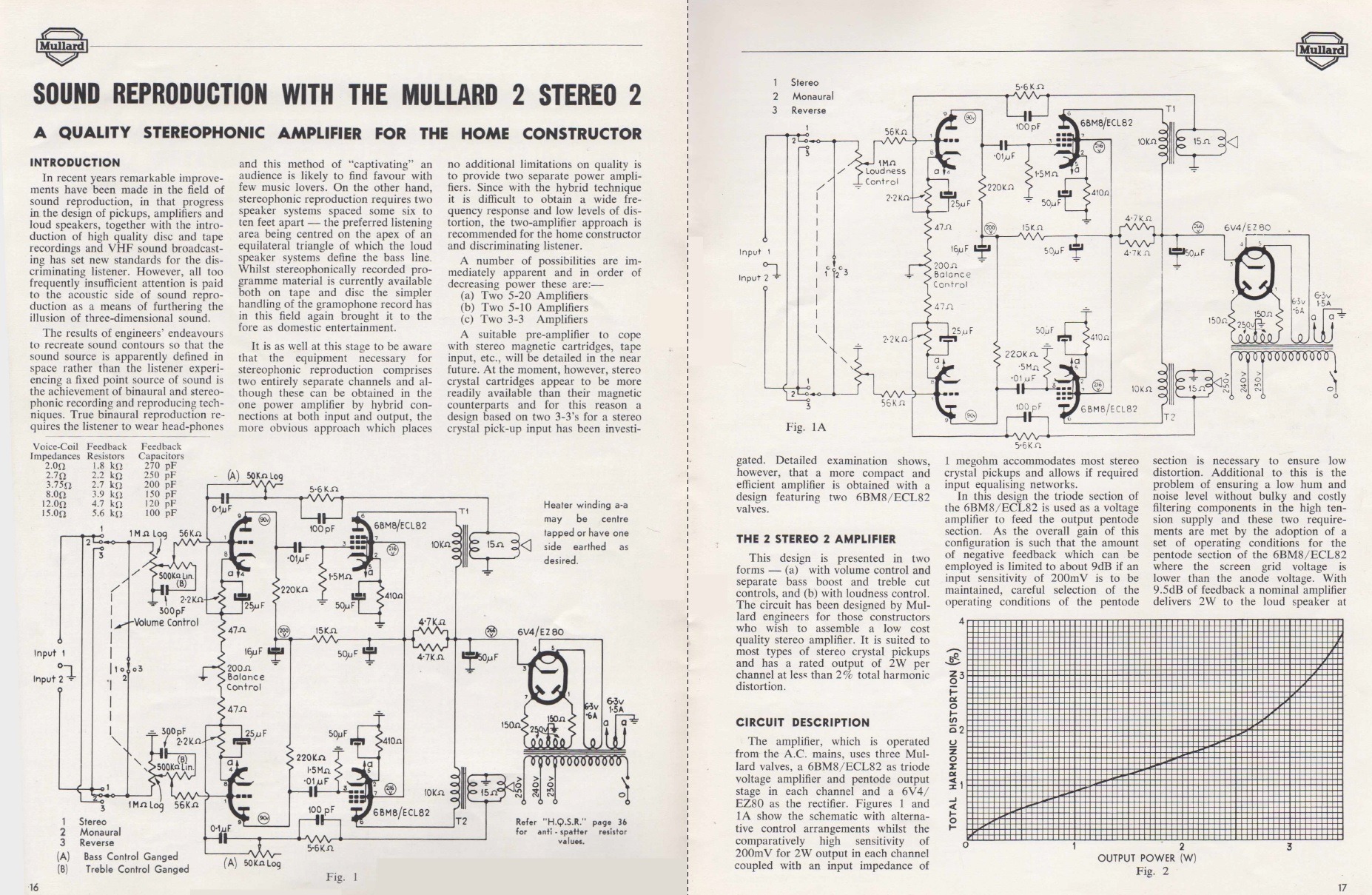

I've decided to go with the Schematic bellow
https://www.experimental-engineering.co.uk/wp-content/uploads/2019/02/ecl82.jpg
Don't know if this can be improved on so I'm open to suggestions! Seems like a good starting place. I'm planning to use a DC-DC boost converter in place of the tape recorders MT and bridge rectifiers for the 200v anode supply so I can make it one stereo circuit rather than having to use the 2 MT's for 2 mono amps in the same chassis. I am also planning to use a buck converter for the 6.3v filament supplies.

The motor run capacitor you linked to is 'overkill'. Although the site doesn't mention this, the voltage rating of 450 V is most likely the rating for AC, so not the DC rating. The DC rating of these type of capacitors is much higher than their AC rating.
Since the B+ (= supply voltage) of the amplifier you want to build is only 200 Vdc, you can safely use capacitors with a 400 or 350 Vdc rating.
The capacitance of the capacitor on the left side of the schematic is not so critical. A value of 22 uF will still do fine, so anything between 22 and 50 uF is OK. The value of the capacitor on the right side of the schematic can just as well be 47 uF (or even 33 uF), especially when using a well filtered power supply that provides the B+ of 200 Vdc.
