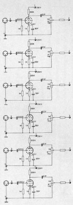

Yes, I did find data sheet , and I thought to use it as an replacement in my EAR-834P phono preamp (revireing required unfortunatly). But I wanted to try them in some preamp design. Didn`t found any shematic. Dusan Klimo used those tubes in his preamp I heard. Only stuf I found was this.

What kind of prices does this tube achive on the market?

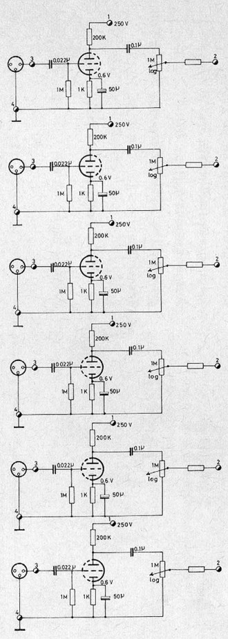

Thank`s for the shematic . I supouse that the second stage of this phono preamp useing ecc808 is a gain stage which can be used as a stand alone line preamp section? No? Do you think that tube rectifier PS useing 2x280V transf. - AZ1 tube - CRCRC filter section would be suetable for this kind of design, or it will demand kind of regulation circuit?
@Coffin: in your previous post you state that the preamp is regulated. I don't remember that. AFAIK it was just a well filtered CRC B+ supply using Roederstein caps.
The heater supply was regulated using a chip, LM317 or a 75xx, not sure.
Have you built one?
Cheers, 😉
Have you built one?
Cheers, 😉
check this:
