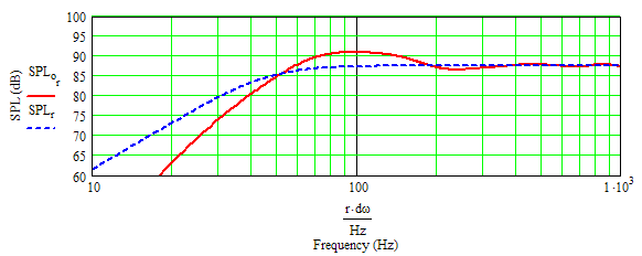

No, while an EBS is an over-sized cab tuned low, it requires a < 0.55 Qts cab tuned no < 0.707*Fs for best performance and won't have any audible peaking at Fb. Bottom line, just because you can load this one into a huge cab tuned well below Fs, it's not a good plan, especially with so little Xmax.
The specs are ideal for a max flat impedance TL in a modest size tower though:
L = 48"
WxD = ~91.5"^2
zdriver = 10"
zport = 91.5"^2 cutout at the bottom
All dims i.d. and 1.0 lb/ft^3 polyfil stuffing density simmed. With an easy load for a tube amp and a nice pumped up mid-bass, then if positioned close enough to a wall or corner to help boost the extreme low end a bit it should be a pretty decent performer.
GM

Interesting you should mention TLs. Presently , these speakers are being used in what I'd call an aperiodic rear loaded horn as I had to stuff the compression chamber a bit to tame some shoutiness. The wife's been pretty patient with me over the last 5 years these 4 ft behemoths have been in our living room. To add insult to injury, I purposefully made the tops slanted so they couldn't be used as plant stands!
So you're saying a (roughly) 25x11x19 enclosure moved back towards the wall would do me? Sounds mighty tempting. The speakers would sit on either side of a fireplace with heavy drapes covering part of the back wall. The enclosure I'm thinking of would have the line terminate in the front under the driver. Or would a terminus close to the floor (hardwood with area rug in front) be preferred?

??? You're putting a ~full range driver into a box height better suited for a sub? I designed the TL to put the driver at ~seated ear height. Regardless, TLs benefit from floor loading, though with such a short height I doubt it matters much where you put the terminus short of down-firing.
GM
GM
You're absolutely right, that's probably carrying WAF a bit too far.
Actually, what you're proposing is a larger scale version of some 1/4 wave pipes I made for the PE 269-469 which I have on either side of my desk as computer monitors. And yes, considering the small footprint and placement close to the rear wall, they won't be nearly as intrusive as the old speakers.
Plus it can be done with one sheet of ply. Right on! I'll give it a go.
