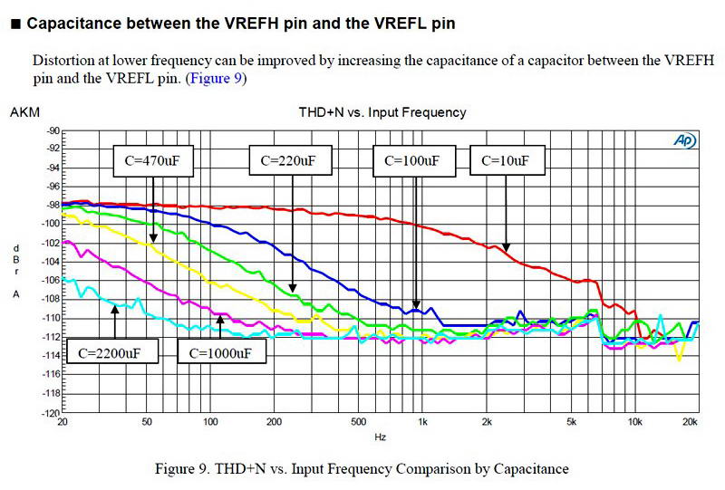

recap as AK4490?
here boys they suggest a crazy cap for decoupling VREFs upp to 2200uF! AKM's recommendation is still 10uF!
any idea? or may someone culd test in on our chip? mine is caputti now.
