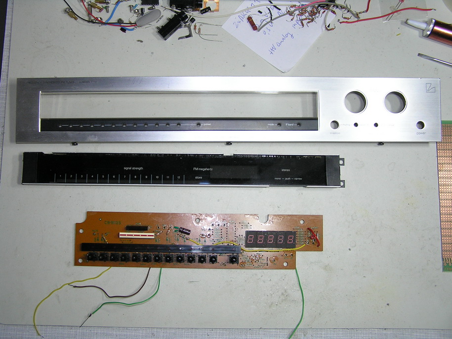

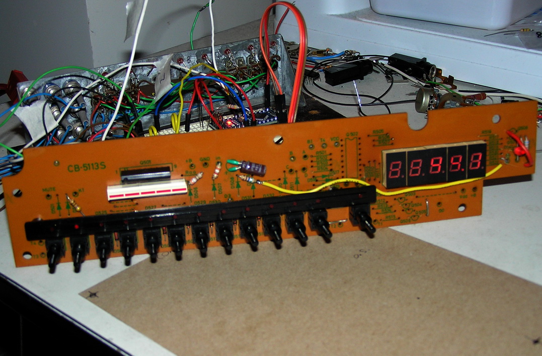

I'm building my 2xAK4399 DAC inside an old Luxman T14 digital tuner. It took me some courage to take out the fine Luxman electronics inside, but I finally did it. I'm going to use it's original LED display, indicator LEDs and switches on the front panel.

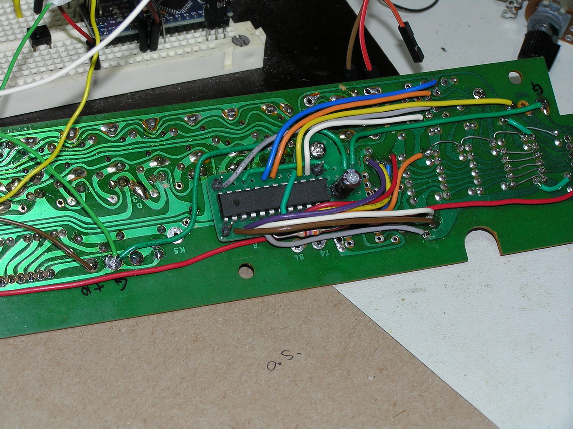

Currently I'm programming an Arduino micro controller, to control the DAC and display. User interface is already working fine, soon I'll connect the DAC and test the whole thing. Display is off when DAC is playing normally, to prevent any interference with analog circuit. In fact, the micro controller is in sleep mode most of the time and only wakes up on user input or change of the digital audio input signal. This requires hardware mod also, I'll keep you posted on that.
First picture is of the front panel PCB. 5 LED bar gradually goes to 5 LEDS on when DAC has locked on a valid sp/dif signal. 7 segment LED display shows sampling frequency.
Second picture is the backside of the PCB, with the new LED display driver.
Nice way of recycling uh?
