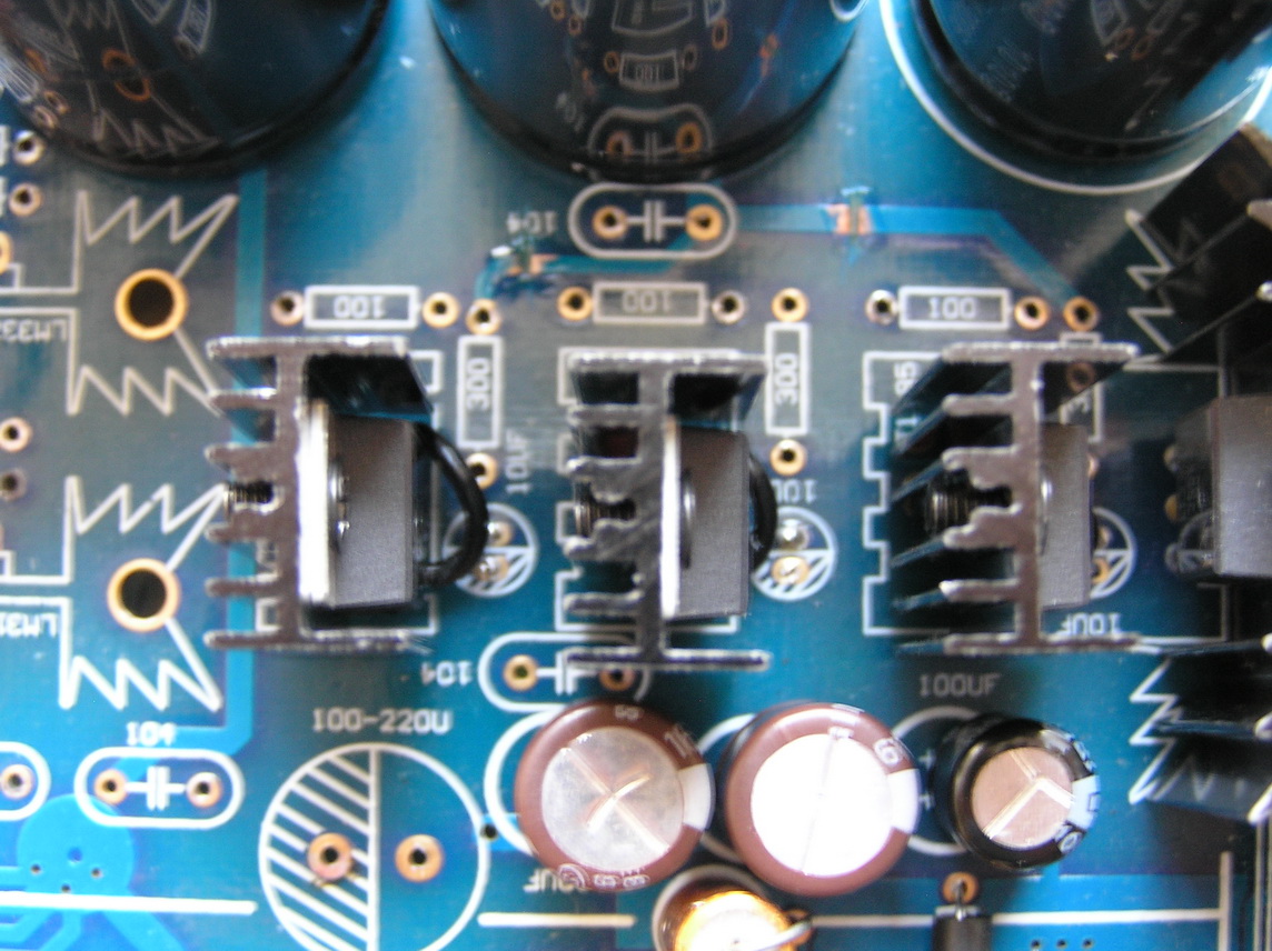

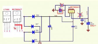

I would like to ask you to give very detailed information on replacing Lt1085 per MC7805ACT. If it is possible, with a photo of the board. Not quite clear about the resistors. They simply need to do to remove or jumper?
Please give more information about times of nominal electrolytes you put some stabilizers.

Thank you very much! How I understood it is possible to change condensers in 7,6,4 areas only for the sake of esthetic interest?!Magicwolf: I checked your pictures.
magicwolf: If you want to use MC7805ACT, 100u capacitor in area 4 will do. Pick your favorite brand, I use Elna Silmic II for the 2 analog regulators (your option 2).
area 7: Aren't those blue caps 47u? Anyway, just a matter of taste IMO, these 4 caps are important though. Experiment.
area 6: digital lines, no need for audio grade caps. Read this thread, I posted some mods regarding psu of AK4113. The capacitor right after the LT1085-3.3 I replaced by a bigger 220u, if I remember.
730user: Do you have the schematic? Just look at it, it's not that hard. You can do it! [for version 1 schematic] Remove the two resistors (R3+R4) and the capacitor (C35). In place of the capacitor a bridge, shorting it. This way pin 1 is connected to ground, pin 2 to out, pin 3 to in. Now modify the MC7805ACT as in the picture and remove the 4th pin inside the heat sink, and solder the new regulator. If you have some patience, I'll post some pictures later.

Aren't those blue caps 47u?10uF. Area 4 - 10uF. On a board it is written 100uf - caps 10uF.

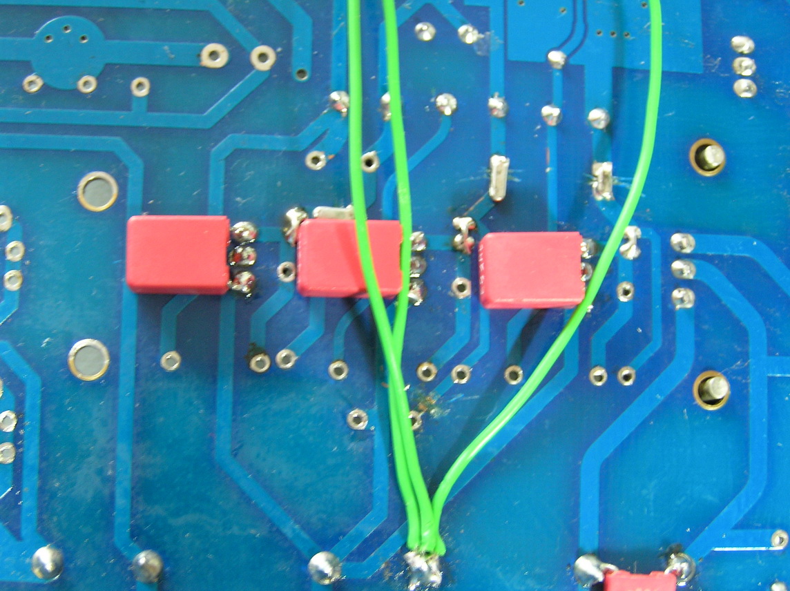

The regulator doesn't need a big output cap, just try yourself. With a too big capacitor the regulator can oscillate, which is not good... I have soldered a 1u Wima polyester cap between input and ground of the regulator, on the backside of the PCB, to avoid possible oscillation.Can С36 be increased to 220uf or anymore?
Nosian: The MC7805ACT has 50 uV noise.
You can use the MC7815/MC7915 for the dual rail, or set the LM317/337 to +/- 15V. I don't think 15V alone will improve the analog stage psu, which is the weakest part of this DAC IMO. LM317/337 can be further improved and perform better with higher load currents.
I had thought about adding an 18v transformer for the I/V stage on mine, but just bumped up the existing one to 15v from the as-delivered 14v, in an effort to improve the results from the discrete op amps. I can't say it made a difference however, since I also changed the caps in the feedback loop at the same time.
The jumper really made a difference though, applied from the 47uf to the power pin, lowering the impedance to .1 ohm.

I agree with you, it's a good regulator, but the the datasheet states 10uV/Vo, which means for every 1 Volt output, 10uV noise. So total noise is 10*5= 50uV
One advantage of this ON-semi reg is the ripple rejection, typically 83 dB at 120Hz, around 70dB until 10kHz. There's probably far more noise coming from the power supply than from the regulator's voltage reference after all.

What jumper do you mean?The jumper really made a difference though, applied from the 47uf to the power pin, lowering the impedance to .1 ohm.
This has been discussed some posts back. Two answers I can think of:I/U conversion? I'm allergic to resistors in audio path elsewhere.
why are they sitting there? is there any logic, or just old school books?
Orpheus bless us
- resistors are for short circuit protection of the op-amps in case op-amps are used with no internal protection
- resistors prevent op-amp output from accidental oscillating. This depends on how it is loaded, just a safety measure.
