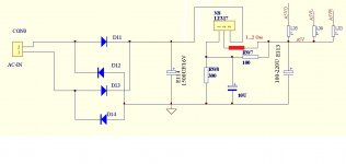

Hi!
What can you say about the next alteration for lt1085 & lm7805 - resistor of 0.5-1 ohm output stabilizer and increase output capacity after a stabilizer to 470 and 3300?
And about output.

Hi!
And about output.
Hi 730user,
It is hard to predict result. I think it won't reduce HF noise which is hard to eliminate with RC filter with electrolytic capacitors.
In this DAC there are 3 regulators which use common rectifier. I remember that I have seen somewhere advice to use is such cases RC filters at input of regulators because such kind of regulators see HF noise (above 100kHz) in its control pin and try to compensate it creating also noise at input of all regulators. This advise sounds for me logical but I didn't try it although it is not difficult. It just requires to make 3 cuts and solder 3 resistors + 3 capacitors on bottom side of the board.
