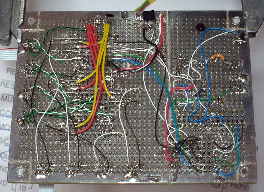

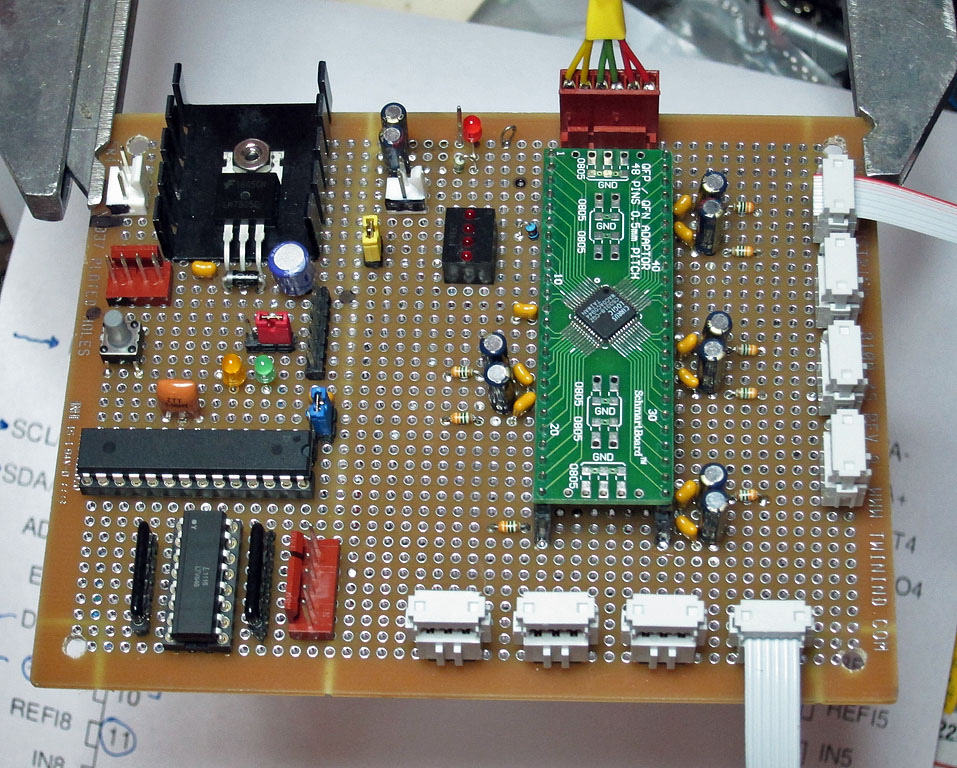

fwiw, here is my current setup using a pair of the ak4399 dac boards. each board is a single ak4399 chip and so I'm not using the software based dual-mono things; just regular 4399 boards sharing a single set of trafos.
I'm doing the vol control using that silver box with the lcd 'large font' display. that's my DIY cs3318 box and it controls a lot more than just volume.
the reason I'm using a pair of the ak dac boards is that I am running a fully digital crossover system. my source is spdif (always always always) 😉 and that goes directly into the spdif-in of the behringer dcx2496 (top fancy box). from there, I split high and low audio into 2 spdif-out streams, using a board I designed and built. it sits inside the dcx box and I have 2 bnc's on the rear that give me spdif-out.
those 2 bnc's go into that middle black box that has the 2 ak dac boards. 2 spdif's go in and 2 stereo pairs of line-out come out 😉 there's more than that going on, but that's another thread (selection between phones mode and spkr mode; a bit more complex than you might think).
after the pair-of-dacs box, the line outs go to my multichannel DIY vol control, the lcd red display box. that varies volume in analog domain and gives me up to 4 pairs of line-out. I use 2 pairs, still high/low for my 2-way DIY spkrs. the vol controlled line-outs go to the parasound multichannel amp and each of the 4 amp channels goes to a woofer or tweeter in my 2way cabinets. no passive XO used; just 4 wires going to each cabinet with clean HP or LP signal for each spkr driver.
it did not cost a lot, but its extremely high performance, this whole setup. keeping things pure digital for the XO helps a lot and keeping the HP/LP separate the entire way also helps.
