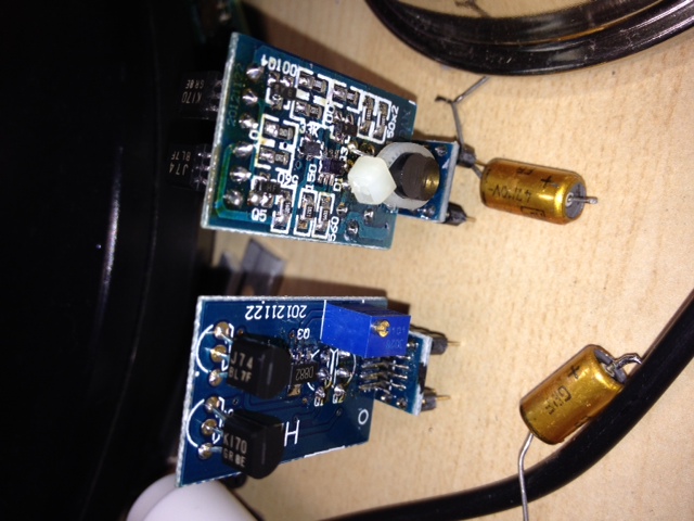

HDAM jfet swaps
I obtained the jfet Idss figure from HDAM supplier and changed them to K170 and J74. Without burning in, the opamp sounds more airy, open and detail than before. Although, it is still not as good as the UTO; especially in terms of airy and density, I believe the HDAM will further improve over time.
The Op01 supplier is not that helpful, I think I have to dismount the J103 and measure Idss by myself later.
Please bear in mind the pin out between the new and old jfets are reversed.
