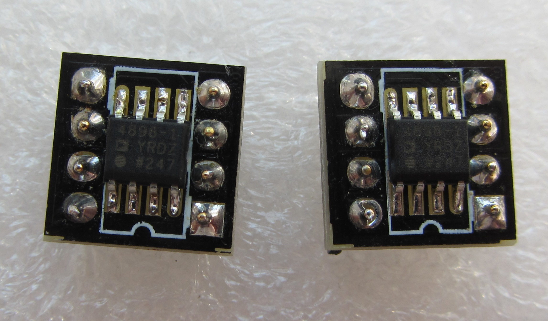

latest update, I made some additional upgrade with Caps as below, analog supply part has now all caps as per schematics with Nichicon KA version, top of that I change those BC aluminum esr caps with ultra low Nippon Chemicon version, I couldn't hear any audible difference, but last week I upgraded analog part with HDAM modules as visible on the picture, hard to describe it properly but it's amazing, more dynamics, more punchy bass, no harshness at all, absolutely happy man 😀
