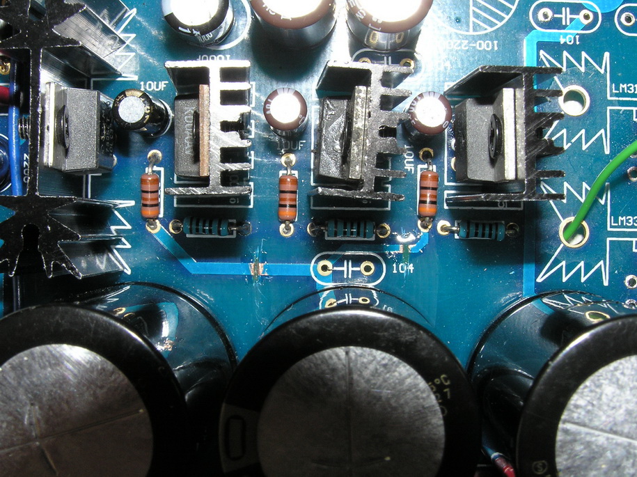

Unfortunately the pcb isn't very good designed, I must admit finally. The regulators are not connected to the load the best way. But don't despair, I've found a simple solution!
The sound of the DAC becomes more dynamic, but not in a harsh way, the oposit: It's much more quiet, less noise, less agitation. I'm very happy with the results.

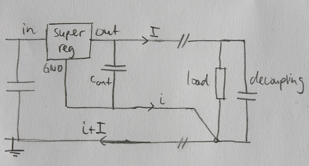

The problem is that the regulator adjustment circuit is connected to the same ground trace as the one carrying the ('dirty') current that has gone through the load. So it cannot 'sense' the right ground potential at the load, and thus it cannot regulate the voltage over the load properly. See the first picture.
The mod is to isolate the adjustment circuit from input ground, and let it's current flow via the load ground, back to the input ground.

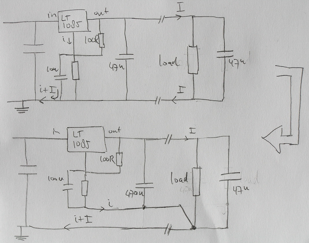

The output capacitor value is raised to 470u/6.3V, for better stability. Just pick a big cap (no low ESR type, preferably audio grade) and decide for yourself. The capacitor in the adjustment circuit, across the resistor, is also raised to 100u/6.3V (or higher voltage rating). There's not much room for bigger, 220u would be even better I think. This cap influences noise performance.

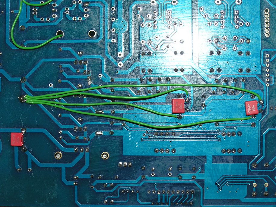

To isolate the adjustment circuit, you have to cut 3 traces (for modding 3 regulators). Two at the front, one at the back of the PCB. Finally you must complete the circuit by connecting 4 wires from the load-decoupling capacitors ground terminals directly to the - terminal of the big psu cap (2 for analog, 2 for digital, see picture).
IMO, this mod can also be very rewarding if you're using super regulators for 5V analog and digital DAC supply. I included a picture of the circuit, it's practically the same method.
Analog output stage with the LM337/317 regulators suffers probably from the same, so can be improved the same way. To improve analog stage you can also try to mount (super)regulator very close to the load (op-amps), to have the same effect.
