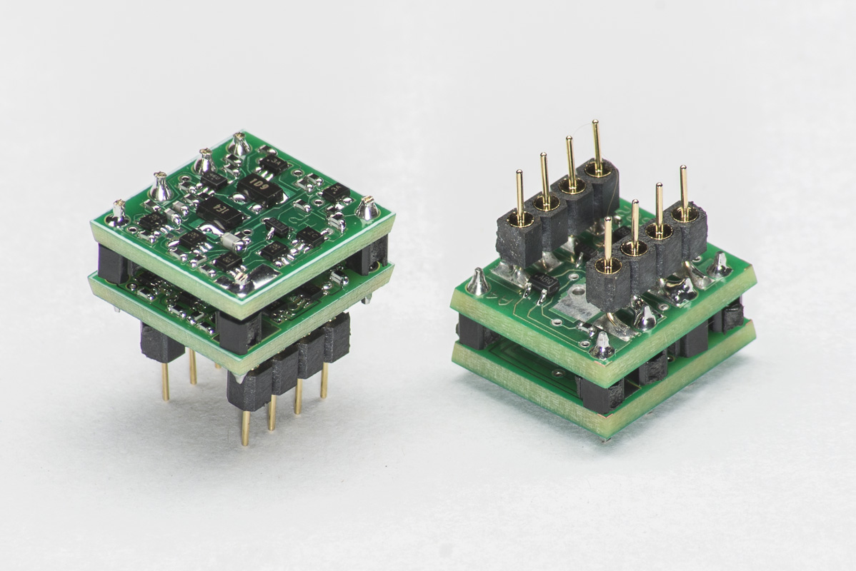

Discrete Op Amps | Sparkos Labs.comSparkos Labs.com
Yes, yes, the Sparkos Labs Discrete op amps are a fine product.
I see that there is some experimentation going on with some DEXA devices. Those have been reviewed against the Sparkos Labs Devices that you mentioned. If anyone is interested it can be found here.

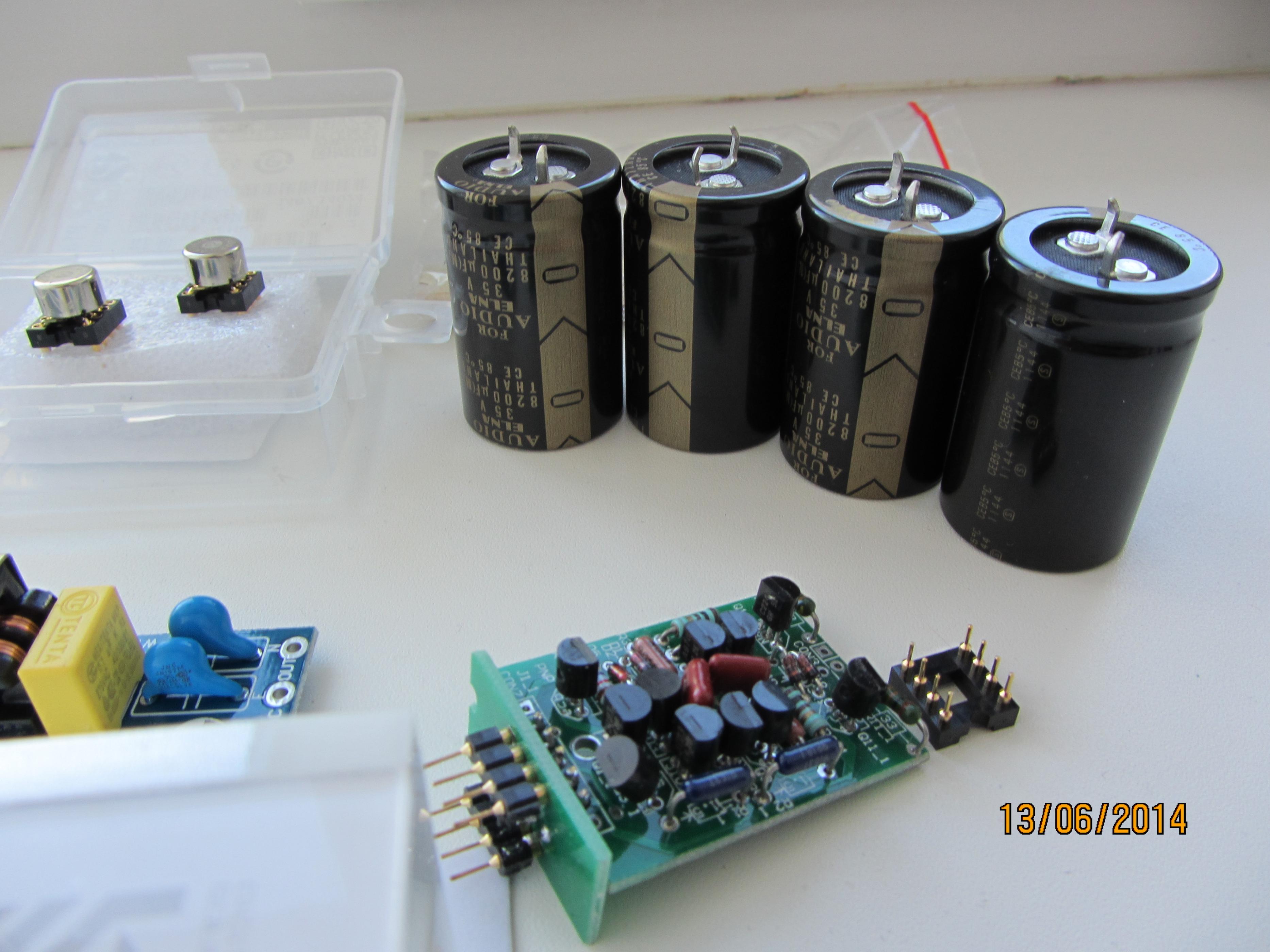

Nino: any chance you could make -3db version ? my current version is still too loud compared to my other DAC, what should I do than with those 2 pairs of Wima 0.1/100v? these aren't in version 1 just in v.2
finally big Elnas arrived, so changed them instead of original 6800uf BC, top of that I changed aluminum 220uf/25v next to analog regs. to 1000uf/25V Nichicon KA as mentioned in schematics.
Harshness and background noise is gone but it's still bright and cold, like typical Pioneer sound, I hate that, tried also new OPA627BP which arrived in the meantime but sound with these is somewhat boring lacking crisp and dynamics even if harshness is gone, I will give it a last chance with AD797BRZ next week and will see if it make any sense continue...
In the meantime all the upgrade I did on my 2xWM8741 burned in together with AD823 and I can honestly say I never heard such a pleasant and relaxing sound which doesn't lack anything other than wider soundstage, especially vocals are stunning, like listening singer front of you, amazing
