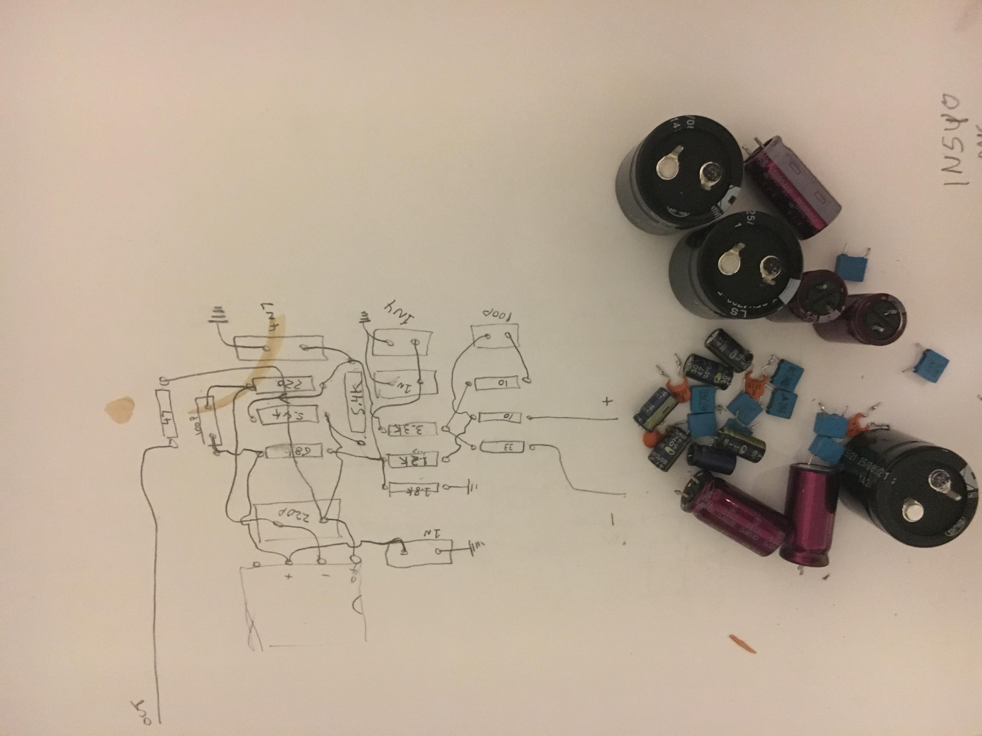

Here are pictures of the project thus far, as well as the offending capacitors...
I agree that as delivered, this really didn't sound all that great, still plenty of detail, but the iPad sounded better overall. This has been my experience with past boards from China.
No complaints now however, and I still really don't care about the other boards, am too busy to invest that much time honestly for diminishing returns. I make prototypes for a living and am well aware of the time that can be consumed with integration, that thread is telling. Looks fun I suppose, and much closer to diy than di buy.
These boards, warts and all, will go from mail box to music in minutes with a transformer and some juice...

That regulator settled down after a day or so, still need to try and put some thermal grease behind it here one of these times, but it's much better now. I would be interested in getting out the scope to see if it is misbehaving.
I really should look into another source, for now it's a laptop. There's another thread that's based on a similar board that uses a 12s and there might be more there as far as finding a better source.
I suspect that the switches are in the same arrangement as on those boards as well, haven't checked that however. The current setting now works well with my magneplanar speakers. I do have some jumpers and pins here if I want to expiriment with that later.

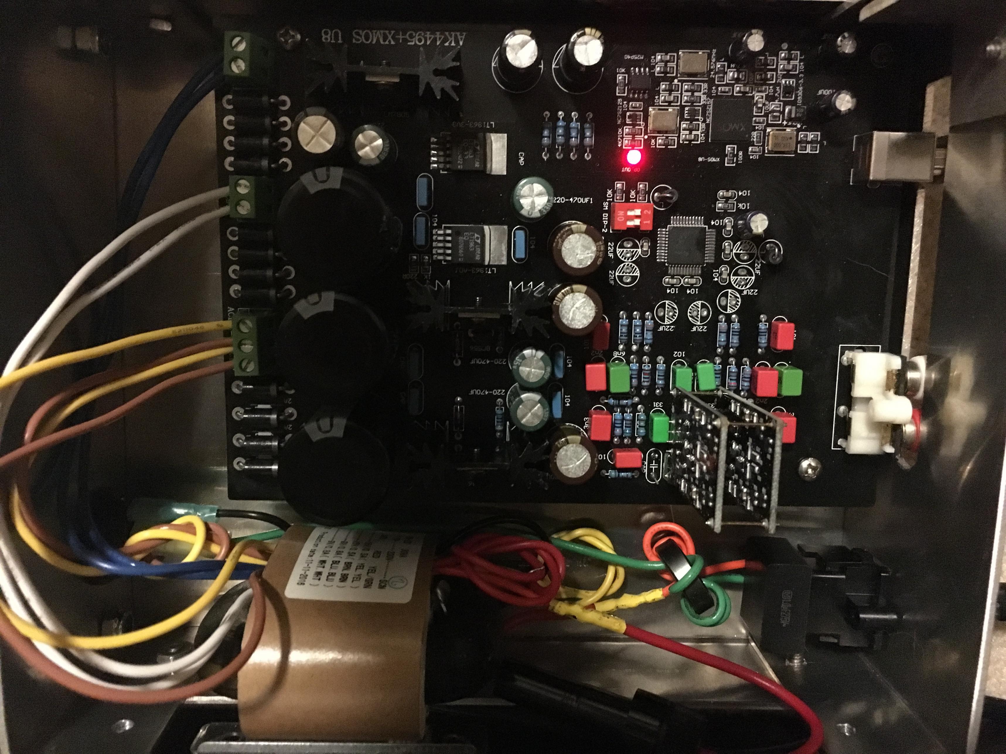

After looking at the last dac I made, where the capacitors for the snubbers on the rectifier diodes were attached to the case, am thinking that this time that the snubber circuits can be directly attached to the underside of the board.

I managed to get the snubber circuits on under the board, used some Russian polystyrenes that I had. While these are great parts at bargain prices, they tend to take an extra long time to be at their best.
The values of .1uf in series with an 18ohm resistor, that combo in parallel with a.01uf on each transformer winding just fit, with the larger caps peeking out from under a bit. These values have worked very well on another dac with the same transformer.
Now to let it run for a good while...

The difference in the resistors value will affect the offset from the filter circuit, as the pos/neg inputs will be altered. I did listen to the board with no op amp installed, wasn't half bad.
I plan on replacing the odd value that's on mine when I can get to the parts store.
The vref callout I had made regarding decoupling was off, the pin I was noticing had a lack of small ceramic cap was in fact the vcom or pin 35. So my bad there, is apparently no need for that there.
I like the arduino for control, good way to tap in to things that aren't available on this board otherwise. Maybe someday I will take the time to dig into that, when I have more time to spend on hobbies, sounds interesting.
My board came with some purple elnas, just after the regs, and samwha wf for decoupling, the more I replaced, the better it sounded, until they had all been replaced.

The 3.3k resistors have been replaced with the correct 3.6k, and the dc offset is down now to 15mv from 120mv.
It would be great to hear from others who have this board and their experiences.
I get <2mV on both channels. USB plugged in, no signal, unmodified board.
