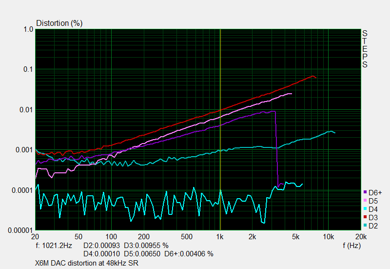

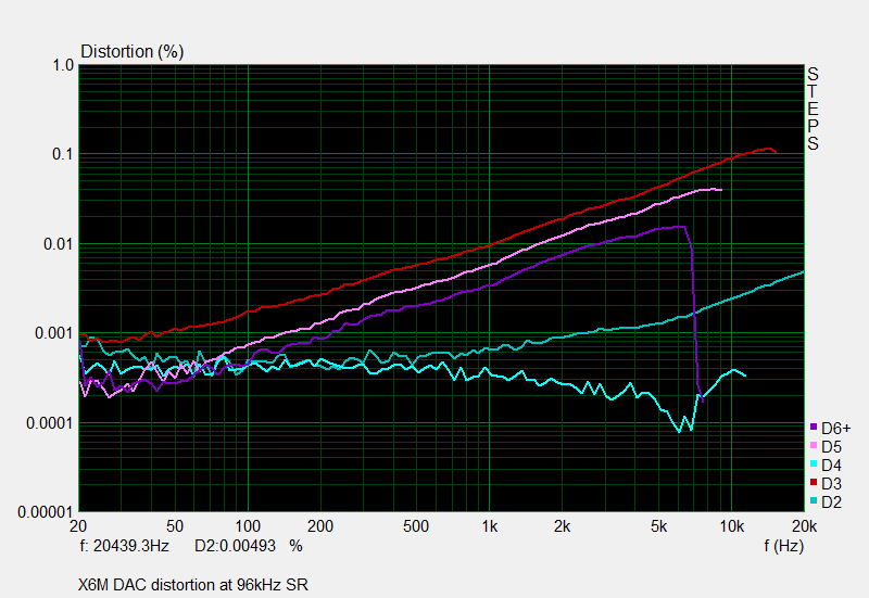

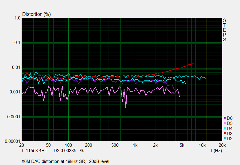

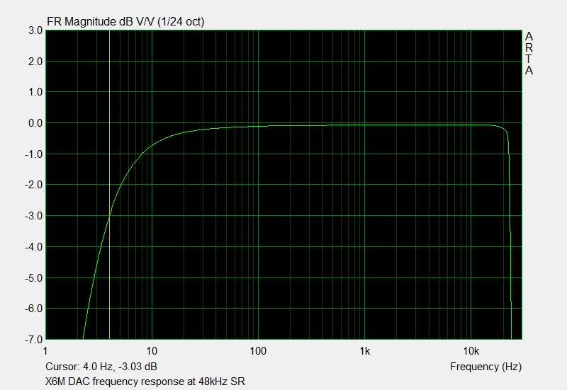

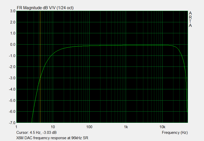

I connected a dual secondary 12VAC transformer to the board, and used an M-Audio ProFire 610 to run some tests. I connected the SPDIF output on the 610 using a short section of Belden 1505A cable that I had lying around (75 ohm characteristic impedance) and then one channel of the analog output section back to the #3 line input of the M-Audio.
I ran frequency response and distortion tests at 48kHz and 96kHz. I could not get output from the DAC at 192kHz although it is listed as 24/192.
As you can see from the attached files, the frequency responses at 48kHz and 96kHz look fine. No problems.
The problems appear when you look at the distortion. I first measured the distortion at 48kHz and 96kHz at -3dB level. THD starts low, around 0.001% at 20Hz, but increases with frequency and has reached a whopping 0.1% by 10kHz, consisting of odd order products. The even order distortion products are significantly lower (See plots).

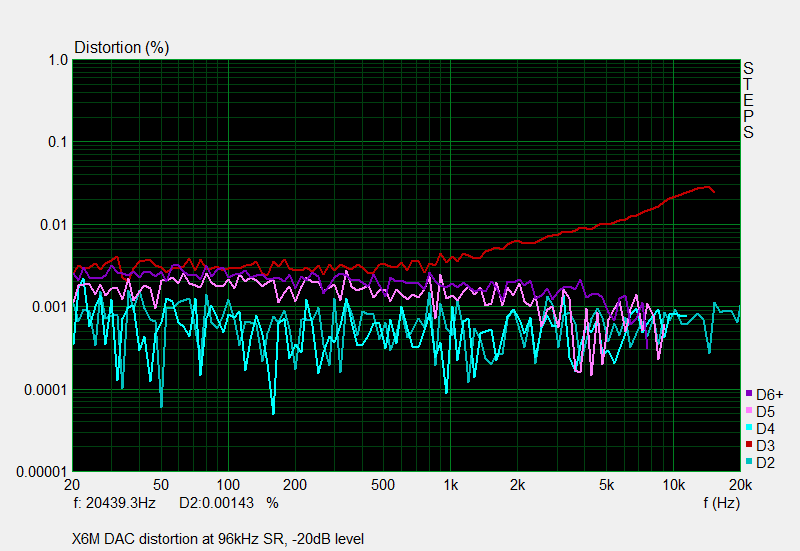

Next I re-measured the distortion with the level 20dB lower for both sampling rates. The results were quite different - this time only 3rd order distortion was rising with frequency, only reaching about 0.02% by 10kHz. All the other distortion products essentially remained in the noise floor.
Seeing that this is a bargain basement DAC, I am wondering if the two larger grey caps labeled 10uF 63V that are on the analog outputs are junk and what we are seeing is primarily distortion from these caps. I might try and replace them with something else, although the only 10uF film caps that I have are physically too large for the board.
If the question is "can a $20 DAC perform well" I think the answer is a resounding "no" for this one. The rising distortion performance is really unacceptable for this kind of equipment (a DAC). I would not use this DAC for full range listening.
On the other hand, if your requirements are for a very low cost DAC that will only be used at "lower" frequencies this board may still be passable. For instance if you only need this for a subwoofer, below 100Hz, the distortion is very low (circa 0.001%) and the frequency response is -3dB at 4Hz. Excellent. You could even use it below 1kHz if you can live with distortion levels rising up to about 0.01% at full scale output, less (<0.003%) for levels around -20 or less. This would be fine.

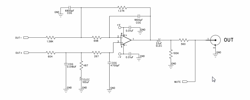

Hello Charly,
If i had read your thread before, i would't have bought the PCB.

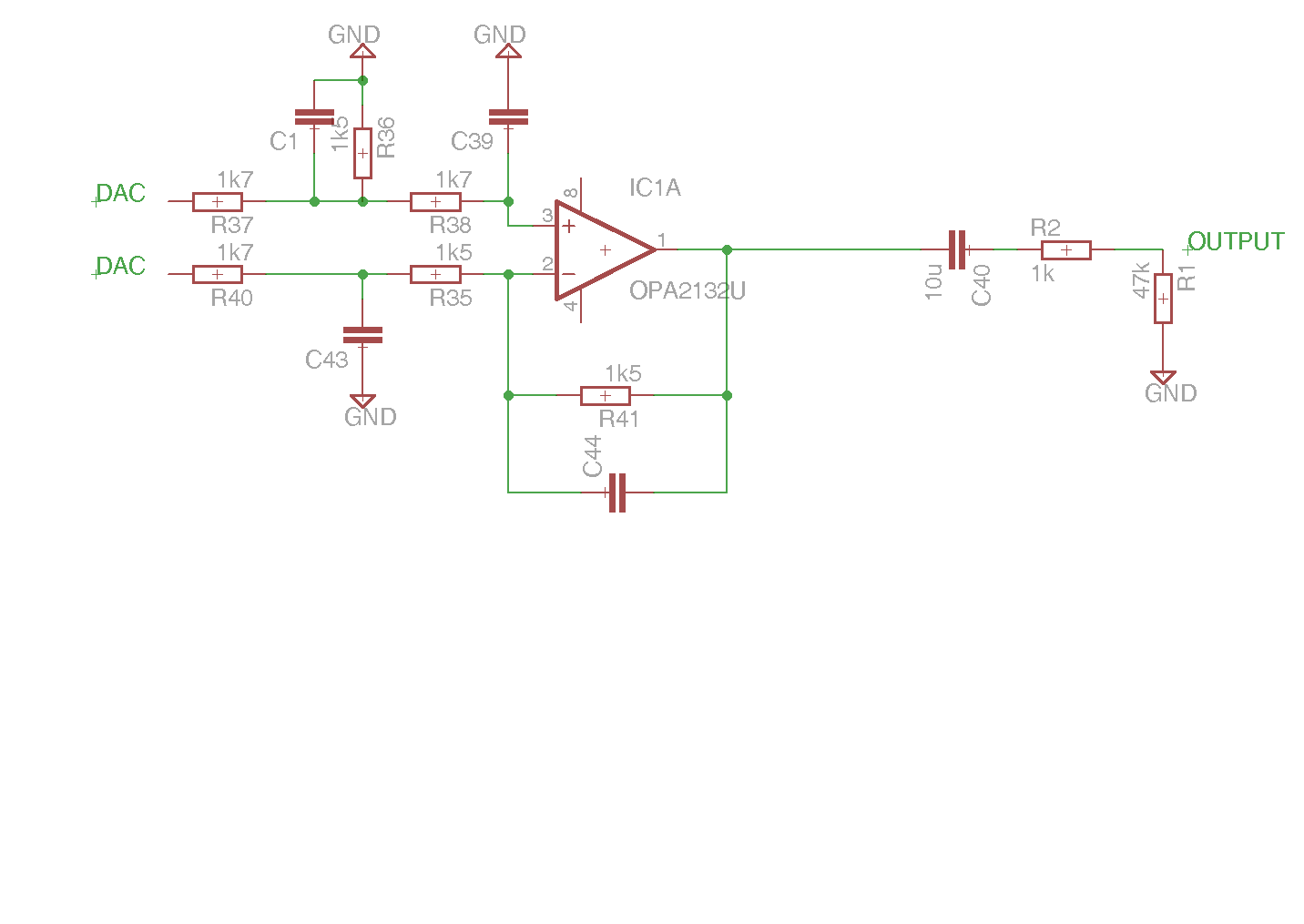

I have got an idea why this dac performes so bad.
In the attachment is the suggested "minimalistic" filter.
As you can see, there is a second cap preventing the DAC driving a permanent DC current.
Adding this cap would be a easy tweak (all in all i'd like to modificate SMD more than DIL)
To you have the possibility to check, if the PCB has the chematics of the datasheet?
I can count 4 ceramic caps per channel and 6 resistors. The part's count does fit with it.
My second Idea is, that those ceramic caps are so bad, that they couse the "outstanding" disturtion.
My PCB will arrive in a few weeks and my goal is to tweak this little pcb to the datasheet performance (even then, jitter performance won't be very good, but for such a cheap dac?)

I traced the Analogue Filter chematics for the Right Channel.
At least that, there is no CAP in the positive DAC output does stress the DAC with a permanent 3k Load.
A little bit tweaking, and it's the original one.
Sorry for my very bad written last post!
If you compare the original schematics from CS and the ebay dac schematics you will notice that both are using the same topology.
There are slight differences:
The CS one does have a second elec cap to avoid DC current. I will add this cap.
The values for parts seems strange in the CS chematics, but they are making sense for low noise.
The values of the resistors are "hard to find" (farnell does have those values but i'd like to go to a local store!). So i give a try with other values:
R40-> 1,58k ----> 1,6k
R35-> 698 ----> 680R
R41 -> 1,27k ----> 1k2
R37 -> 604R ----> 619R
R38 -> 267R ----> 270R
R36 -> 487R ----> 470R
R2 --> 560R ---->100R
This gives a CMRR which is better than the 1% resistor tolerance.
What's harder to find are good npo caps with the suggestet values in SMD. So i will go for MKS02 RM2,5 Caps.
I choose:
C44 -> 1n8 ---> 2n2
C43 -> 6n8 ---> 6n8
C39 -> 4n7 ---> 4n7
C1 (this number seems to be wrong) -> 18n ---> 22n
All Parts are for one channel, the other one is mirror inverted on the board.
This will give you not a perfect filter response, but we are talking about a cheep dac, so i don't like to spend too much on presision parts.
Parts are around 5€ in Germany
I haven't finished the modification untill now, but i will do the mod on the weekend.

My problem with the DAC was only the performance as signal level approached digital 0dB (maximum output). Within about 10dB of this, the distortion performance had a rising character that exceeded 0.1% distortion by 20kHz dominated by odd order products. But at lower levels (e.g. -20dB) the DAC had more of a flat distortion profile with THD levels well below 0.01% except for a slight rise of 3rd order above 10kHz. You can see my measurements in post#9 in this thread.
I got some feedback that this distortion behavior is characteristic of non-NP0 type ceramic caps. So it's good that you are replacing the SMD caps with better types (MKS) in addition to adding the elcap.
Can you do some distortion testing after adding the MKS caps and before adding the elcap? It would be interesting to see the relative influence from these two modifications on any improvements that occur...

If you do some modifications on the resistors, the elcap is necessary because the DAC can only drive 1k and will be saturated by the DC current.
I think changing the caps is the best (and most easy) modification. Ill try to measure the original ones for you.

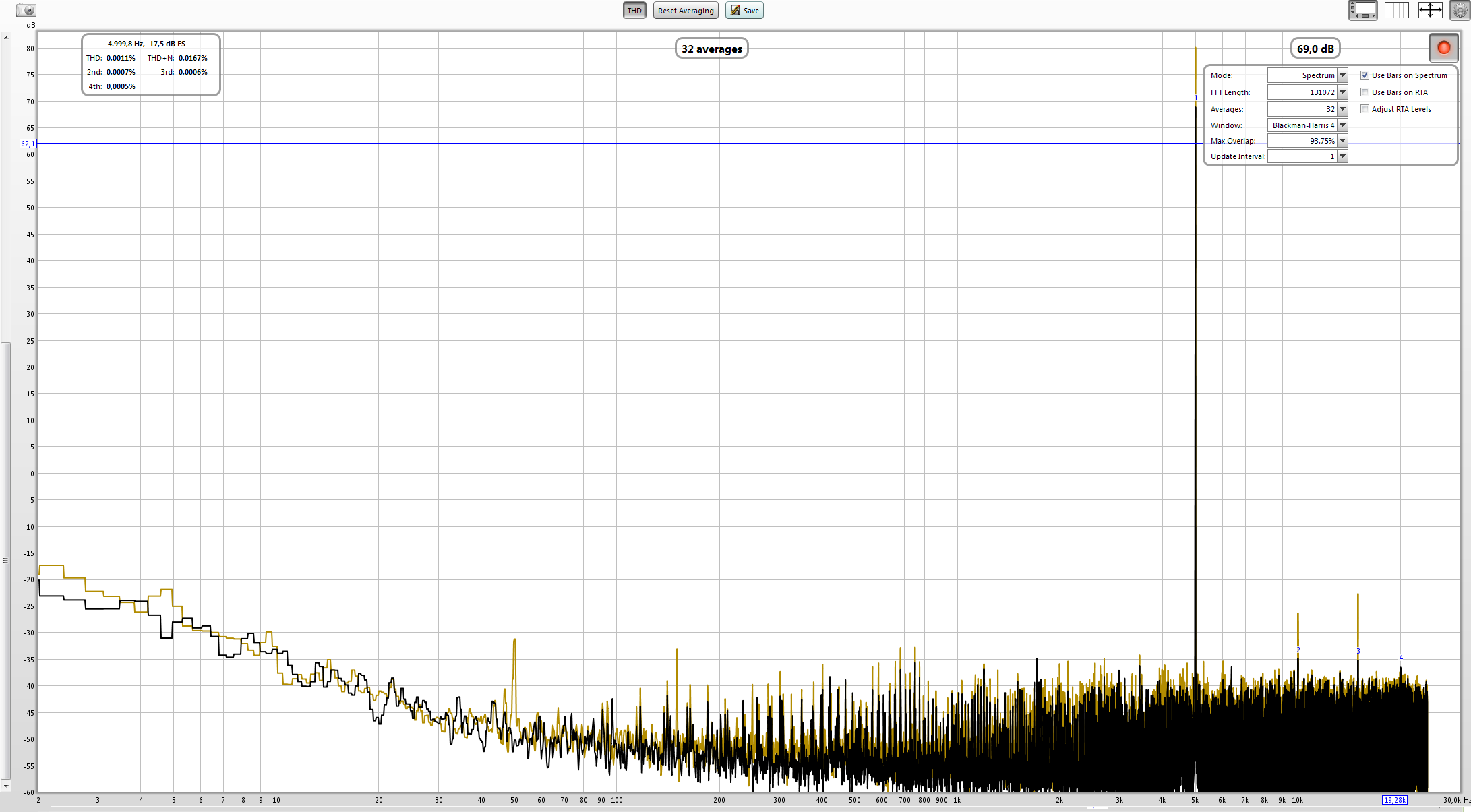

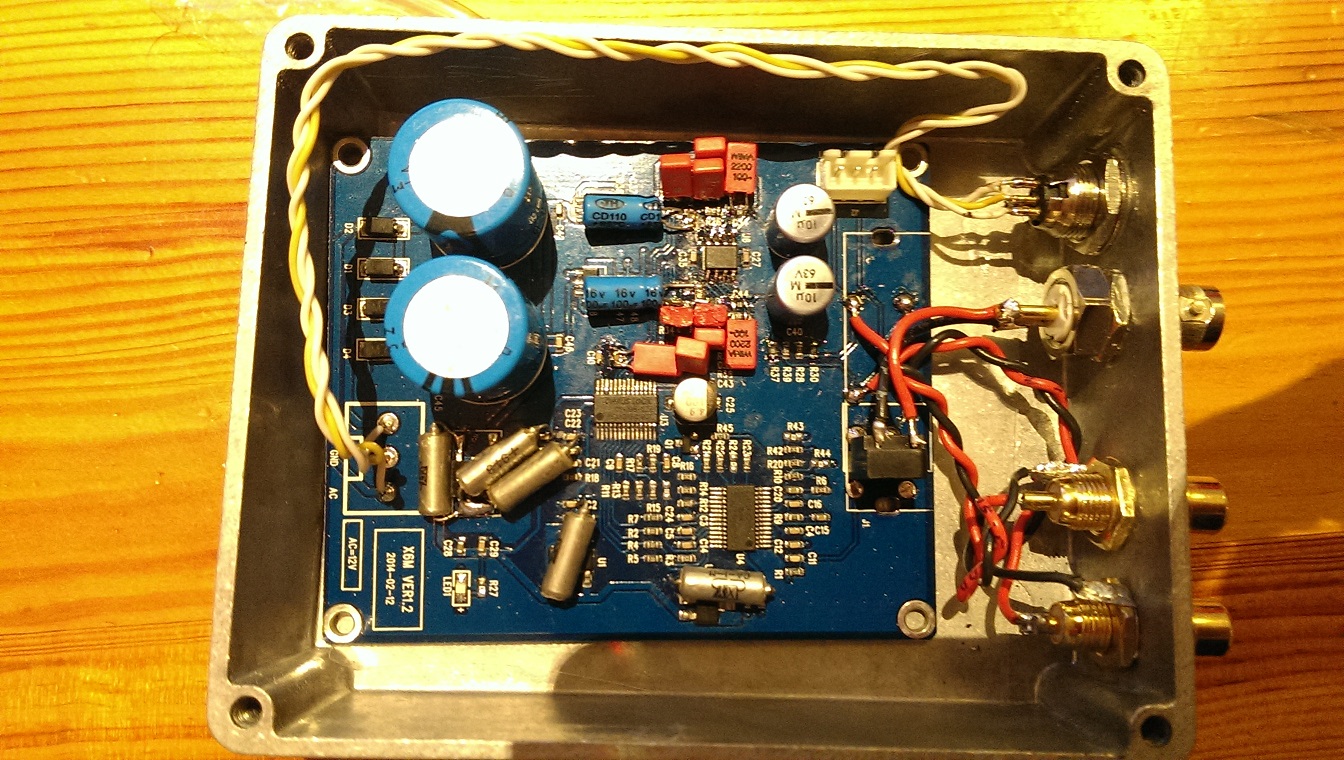

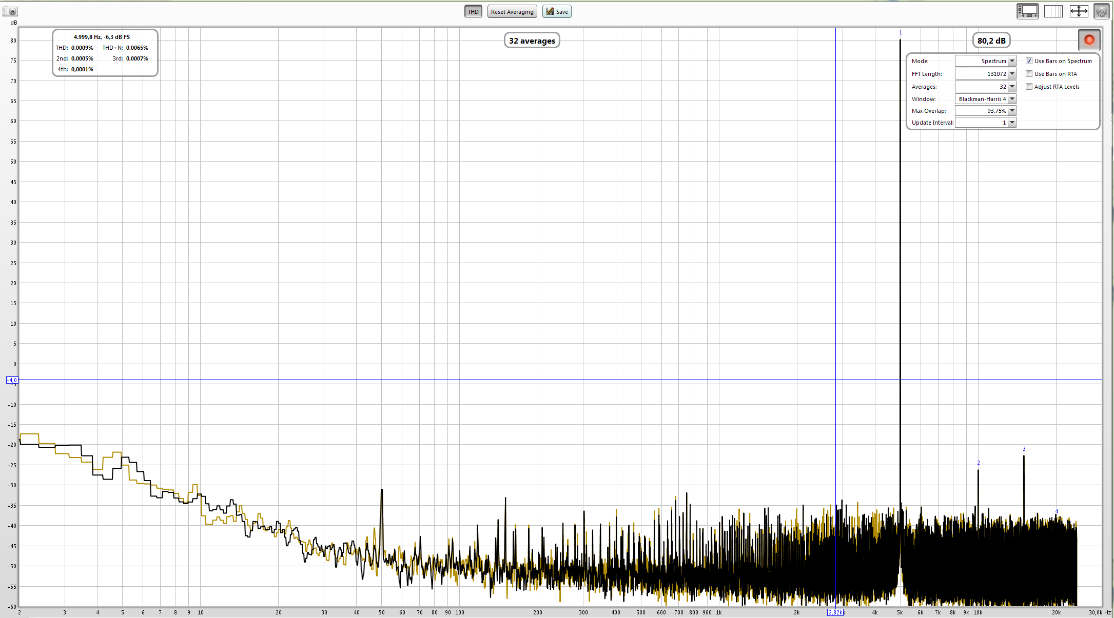

Hello out there!
It takes a long time for me to get a running Setup.
In the moment i use the ADC of a Terratec TS22 Soundcard (i think it was a AKM Chipset).
Because i had a OPA 1642 in stock, i changed the NE 5532.
Aditionally i added a few Tantals on the board and bypassed the output Caps with foil ones.
The first screenshot was measured with 2vpp
The second screenshot was shoot with a load of 100Ohm (with a output resistor of 270Ohm). You get around 10db less output voltage but the THD did not rise at all.
I think the THD is limited by the ADC and think i am on specs now.
Can anyone help me out with the right grounding?
In the moment the Case is grounded with the chinch connectors to anal. ground. The Spdif input went trought a transformer and isn't earthed at all. The Powersupply is not conneced to the case.
I did another modification on the DAC:
I power it from a single wall mart supply and noticed that the ripple on the positive voltage supply was around 500mV with the typical peaks (If you supply it with a dual supply the ripple decrease, but even 250mV are a lot!).
I decided to use a CRC Network with aditional 2200uf and a 10Ohm Resistor. That takes the powersupply ripple down to 50mV with much less peaks in it.
This help's to remove the 50Hz Humm on the output.

Good job! This is definitely an improvement on the performance.
Usually you would ground the case to earth ground, but with a wall wart power supply that isn't available. Using the PS ground like you are doing is second best. I'm pretty sure that the spdif input should not be earthed.
