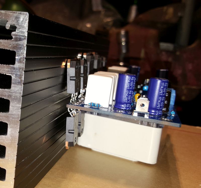

so the L25 board from eBay got delivered and I compared the item picture to what I received.
attachment.php
some components were different styles (no issue), the four large electros are 220uF instead of 150uF (probably not big issue?) but the biggest thing is the missing heat sinks on two of the smaller transistors.
attachment.php
in the original pictures the mini-heatsinks seem to be attached simply with white compound & the faces om the transistors on my board seem to have been sanded to form a rough surface.
so I am sure these are be required for proper operation without letting any smoke escape...
I have found self-adhesive ones: H0600 Mini PLCC Chip Adhesive Backed Heatsink - 10 x 10 x 10mm - Altronics
do these seem OK to use?
also - I am mounting on a bigger heatsink, should I reuse the soft transistor pads that came with it - or get new ones? also can I add some PC CPU paste to each one to improve the thermal transfer?

Should be ok to test, just see whether they get hot. If they get too hot to touch, they can probably use a heatsink.
Just a note - the intent is that you attach the piece of angle aluminium which the outputs are tied down to onto the actual heatsink. This makes life easier and better supports the PCB physically.
OK, I see - yes, makes it seems to make it easier but isn't it less ideal for heat transfer? the power devices literally sit back to back?
attachment.php
attachment.php
I am going to support the PCB with stand-offs either way.

The heat transfer only has to be sufficient, and it should be through the angle aluminium.
Ok, i wasn't really sure - it just looked quite weird having them back-to-back like that!
it will certainly mean less drilling and thread tapping! I had really only read one direct comment about this issue:

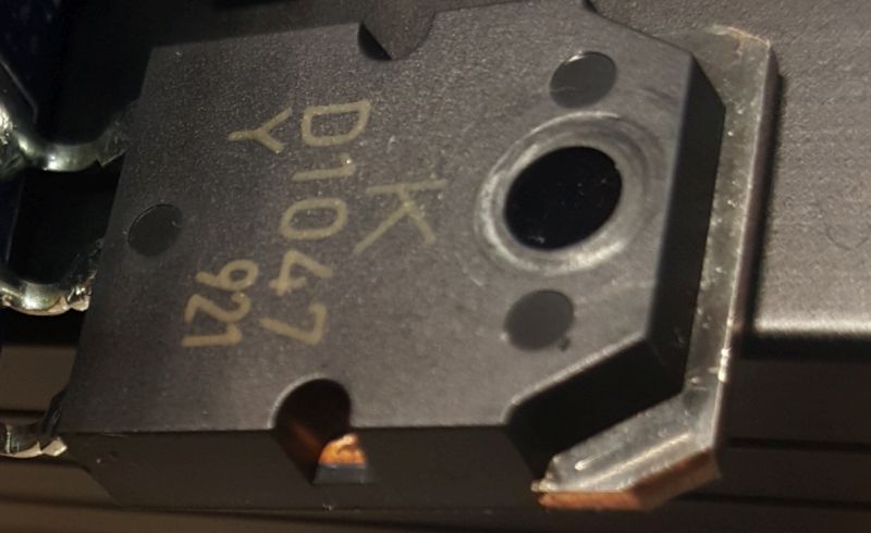

Try rubbing them with IPA on a Q-tip for 30 seconds and see if the black colour rubs off....
I rubbed and I rubbed, but no genie came out - nothing on the tissue either?
attachment.php
could you please post up the pictures of the genuine ones you are comparing these to? that would certainly help in getting a eBay refund!
or are you just comparing them to the original picture I posted, with the dark shiny square where the printing is placed?? they do look quite different...
What MOSFETs? I see 2SA1186, 2SC2837, 2SD1047, 2SB817
And they look like they are re-marked fairly crudely, so probably fake/reject/recycled BJTs I'm afraid - sanded and black-coated, laser etched. Try rubbing
I don’t see how one can make a conclusion that the power BJTs are crude counterfeits based solely on a grainy picture where you can’t even see the mold markings inside the tiny circles in front.
Here are the KEC marking guide for the still active KTD1047 and KTB817
https://www.kec.co.kr/data/databook/pdf/mkg/eng/M ktd1047.pdf
https://www.kec.co.kr/data/databook/pdf/mkg/eng/M ktb817.pdf

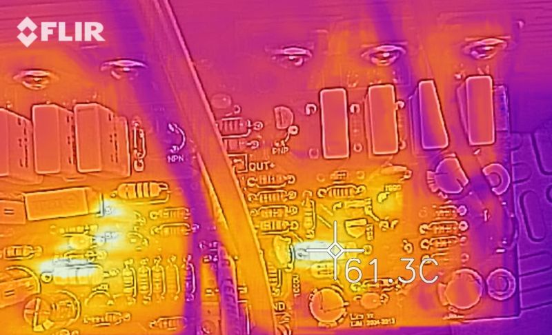

so I fired it up last night and everything seems fine.
just put a dumpster speaker on it but played for 20 mins at medium levels and seemed to last the distance.
the heat sink warmed slightly, but didn't have the fan hooked up.
attachment.php
I put the FLIR camera on it and seems that the smallest transistors (labeled 5401) on the LHS of the amplifier were getting the hottest @ around 60'C
attachment.php
the other transistors on the RHS of the board (547 & 5551) were less hot.
but the transistors at the back that were missing the heat sinks barely got hot at all - which is great!
also - the large 3.3k resistors (which must be a 3W ones?) got well over 60'C - is that getting too hot? what is their purpose?
