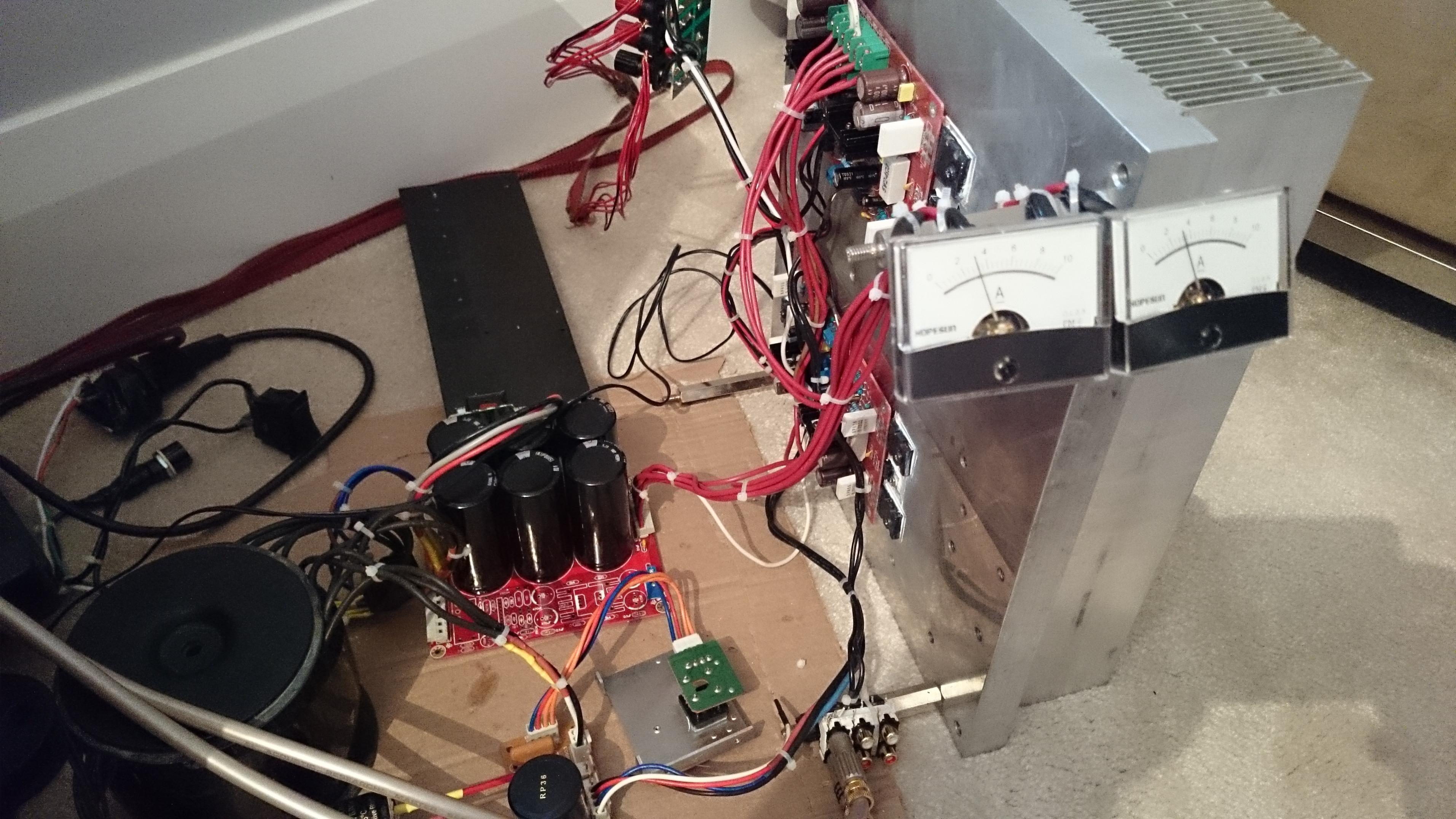

Photo and update
Here is is so far. More of an experiment than an amp. It does sound nice so far. Very effortless. Problem is that the Arcam A75+ that i am using for a pre-amp kicks out before my meters even move from 3 amps. I Think the output may be too low for the amp's input stage. Just guessing there though.
Toroidal heats up some. If I am drawing 8A across 80V does that equate to a 640VA?
the toroid is good and warm but not what I would call hot by any means. How would I calculate the max VA of the transformer?

I have to put some load on the speaker terminals of my Arcam A75+ or it trips at mid volume. I don't think a low watt resistor would last too long. What else is 4 to 8 ohms that would make a good dummy speaker?
Need a real pre-amp.
I think you have a fault with the Arcam amp, I wonder if the zobel network has gone open circuit. Open the box up and look for a burnt resistor.
I have had both the A75+ and P75+ apart and they are both clean without burnt components. Actually neither amp can be pushed at all with no load or the small load of the tweeter in my bi-amped configuration. Both amps perform the same and have since new when I bought them. Oddly, when I bi-wire to iether of the two the problem goes away and I can get a lot more volume from just one amp. Low sensitivity Spendors but still an apples to apples experiment.
