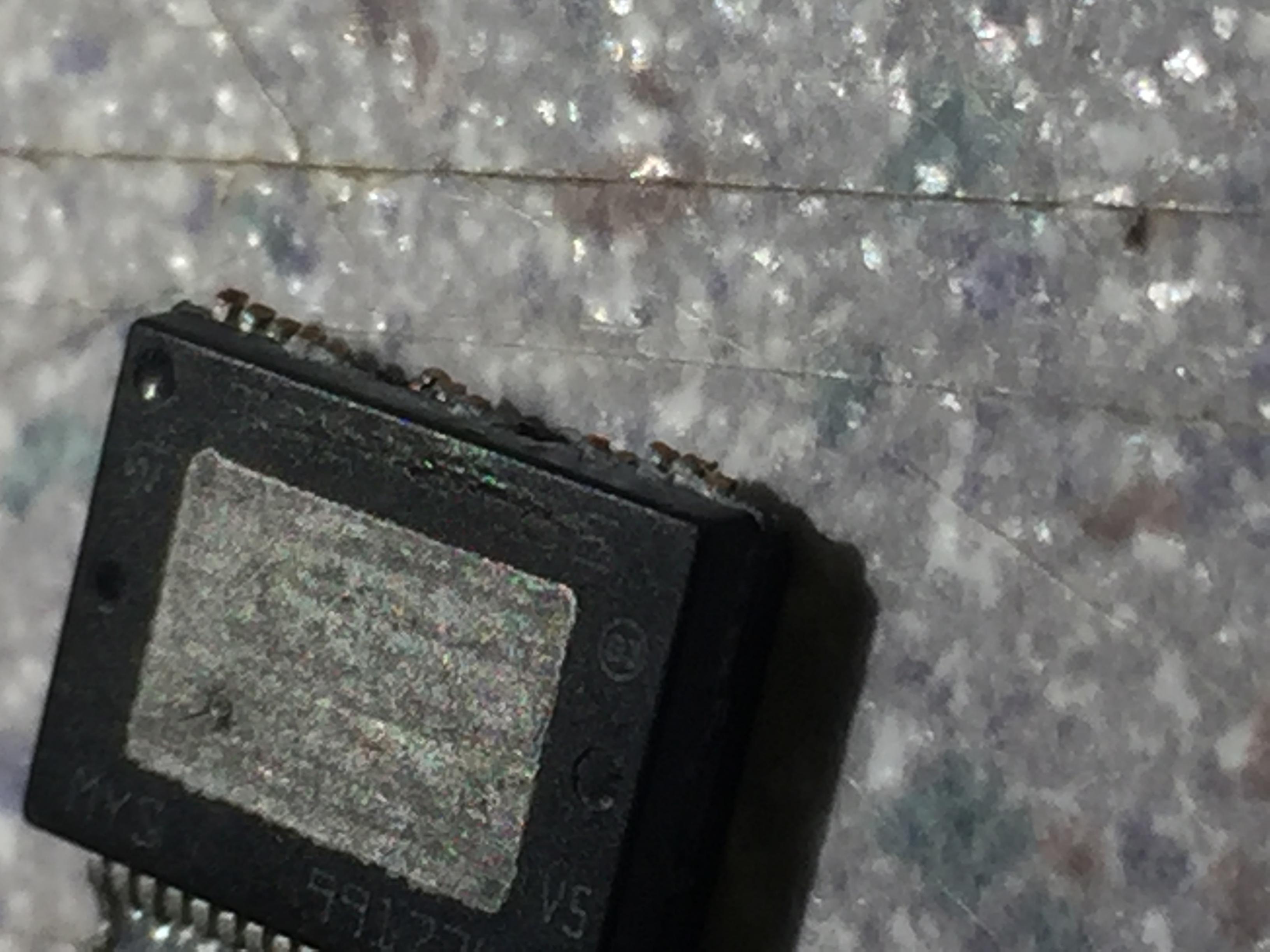

Mine exploded after <1 minute of party power.
4Ohm @ 36V BTLmono melted all 4 of the power pins on the chip.
Looking closely afterwards it really looks like a very poor reproduction, so I'm not surprised.
Question now is where to get an original IC?
Shipping to IRL by recognised suppliers is many times the cost of the chip.
oh...sorry to hear that....but can you post a pic? i know it hurts if something is bunring but i want to see the manufactoring quality. mine was realy good made (maybe there is a difference ...mine is from amazon...i´m not willing to discuss over CN if there is a problem...)

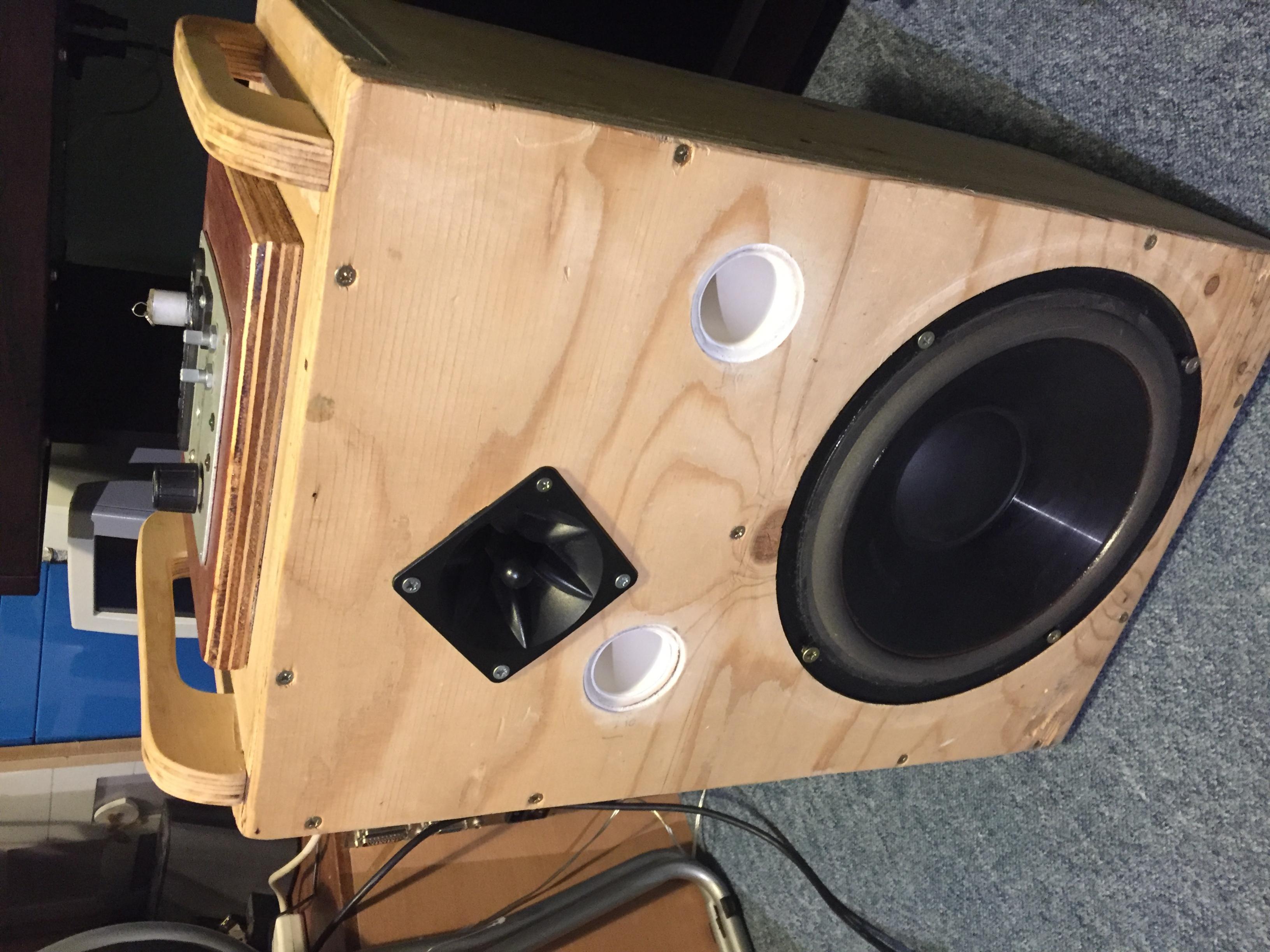

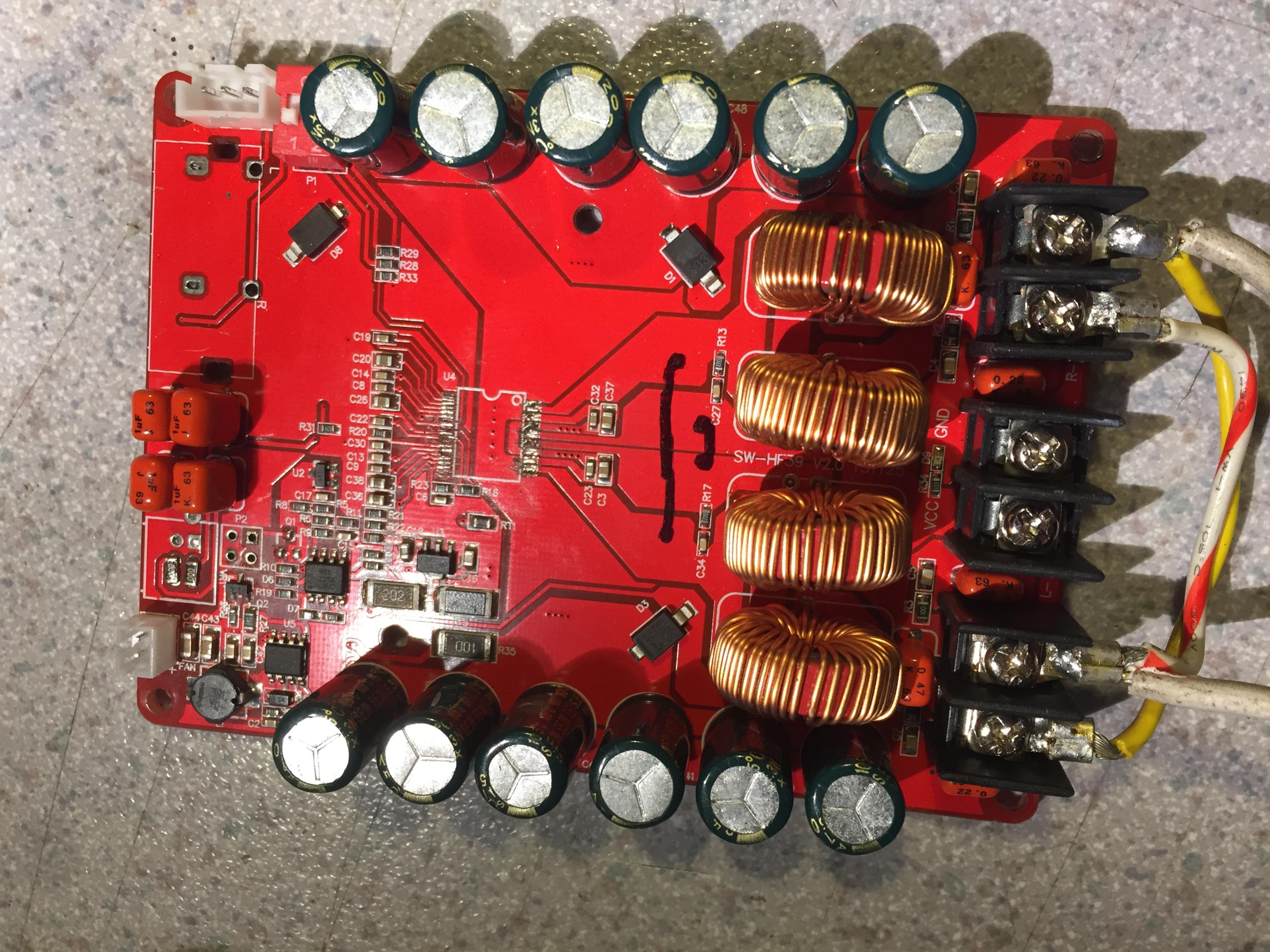

Sorry about poor quality, I cant get much closer..
I cut the remaining Legs to remove from the board easily.

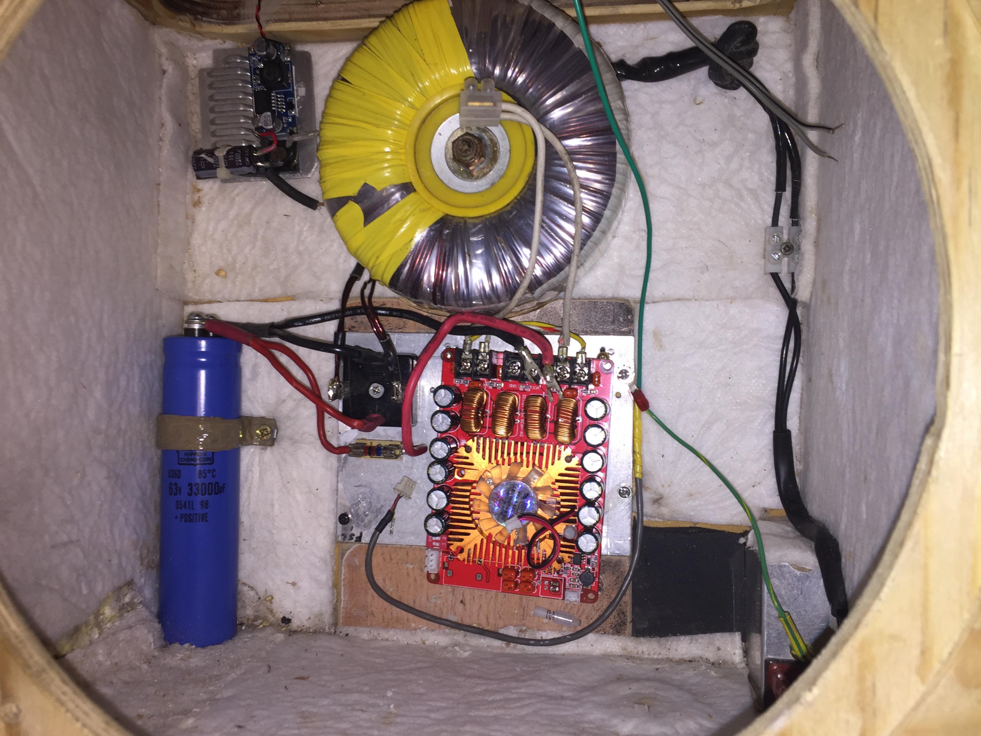

This is where it lived, i used it very lightly for a couple of months as a sort of Proof of concept, the final plan was into a suitcase type box with wheels.
The Board sans smokey the bandit.
Inside the box.
I think you've incorrectly connected the speaker outputs on the board, and that's why it burns.
For amplifiers in the D class, speakers output can not be connected in parallel.
