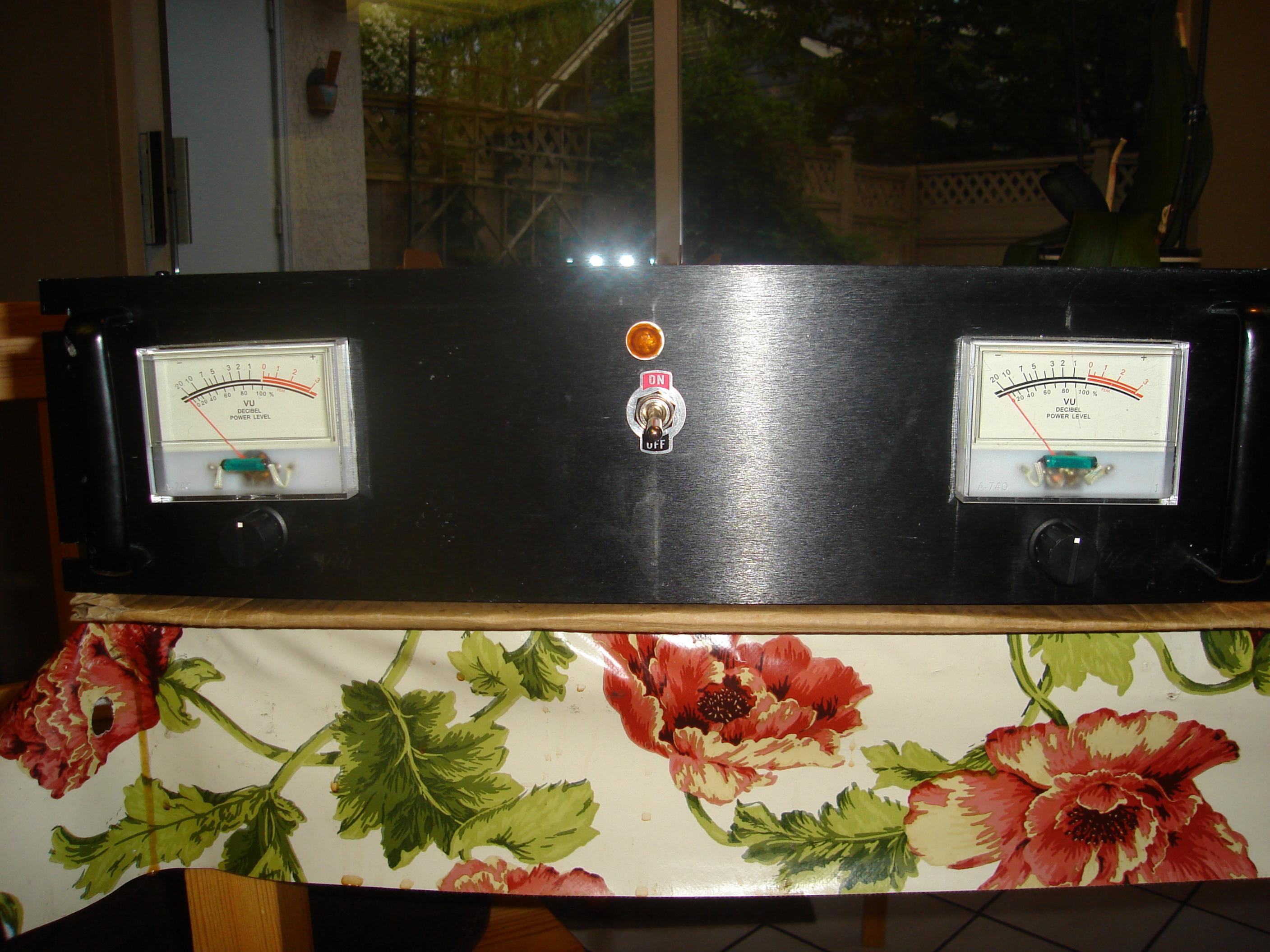

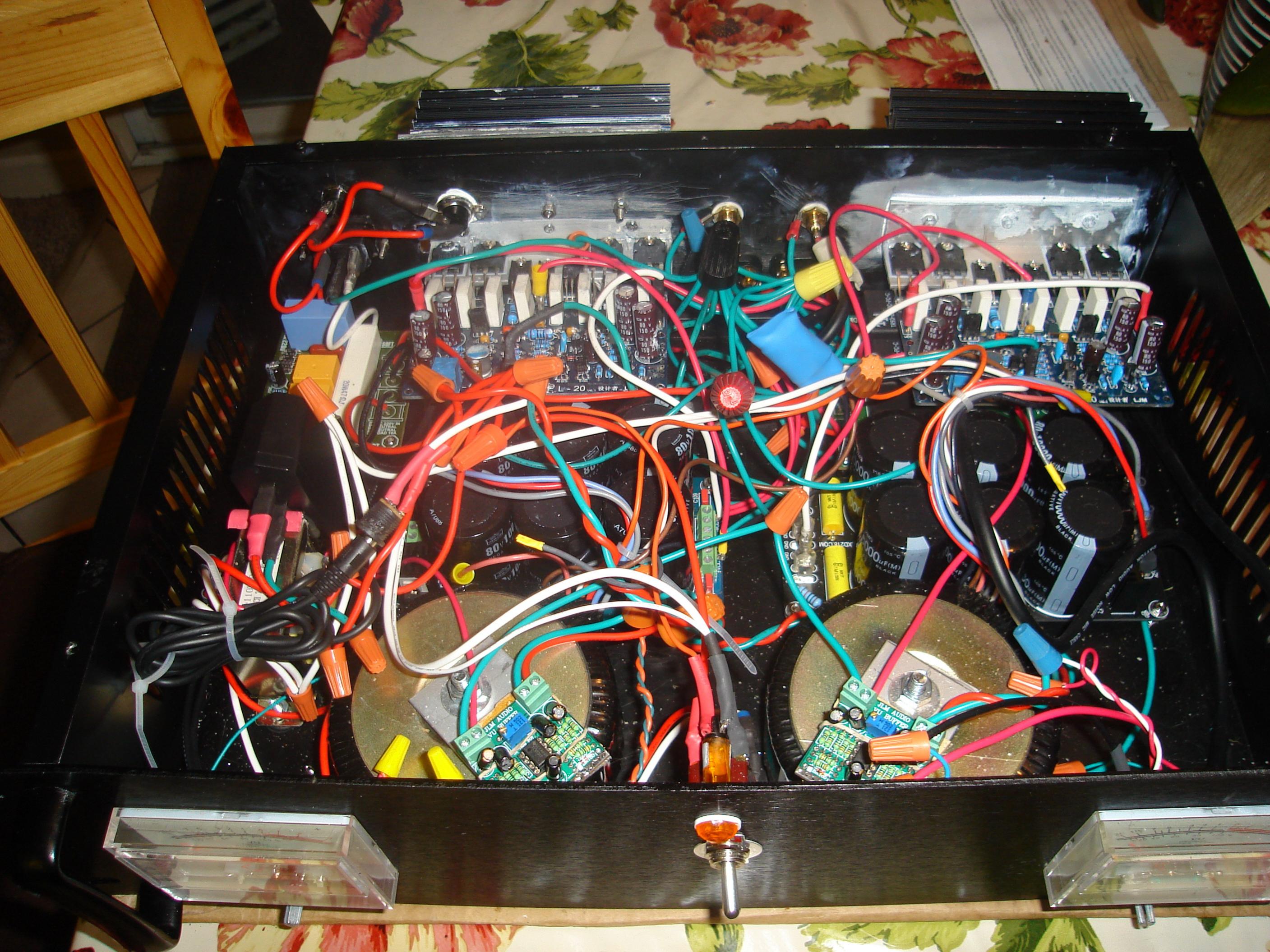

I just finished building an amp using the L20 boards with dual Plitron 40-0-40V @ 2.75 amps and 6 x 10K uF capacitors per channel in the power supply. I also used a soft start module and a speaker protection relay board for start-up. I had pipe dreams of using peltier devices which would allow me to get by with less heat sinks but my experiments with peltier devices were failures. So I have a thermal switch set to 85 degrees Celsius that will cut the AC if the temp by it reaches 85. So far the heat sinks have got quite warm but not too hot to touch. The maximum length of time I have had it on is 2 hours. I don't feel like tempting the fates by leaving it on.
How does it sound? So far quite good. It was built to replace an aging Yamaha M-70 that been in the shop 3 times in the last 2 years. My math says it was cheaper to build than repair. The L20 to my ears sounds slightly more detailed than the M-70 so I am a happy camper about this project although I should have had bigger heat sinks.
I am going to try to insert a picture of this project. My handy work is not so handy! I call this project the DB amp, DB stands for Dog's Breakfast in honour of ny chaotic wiring.

I am looking at this amp PCB I got here - and I dont see where the Vcc+ is even used.
I also rather shockingly see that the output+ in the center of the board has nothing connected to it ?
Has anyone had one of these work ? I guess yes, but then again stuff just happens to not work with me ...
Anyway I will look in the pics and see what it looks like.
If Vcc+ isn't used, can I just run voltage to Vee- and ground ? Sorry for all the dumb questions. I am trying to learn this stuff.

From this pic I dont think anything is connected to Vcc+ and the red wire coming off the center of the board does bring sound huh.

I can assure you, the wires are connected. I succumbed to criticism and from a few helpful hints about grounding, I rewired the amp. Doesn't sound any different but it is a little easier to follow what goes where. I also installed better potentiometers for the level controls. I like this amp and will be building a third iteration soon. Hopefully I have learned something from the first two.
Oh yes I see it, its etched on top too. The trace is on the top of the board.

Ground is the center tap of all transformers you have connected, soldered, attached to the chassis..the commom point...the ground point... a central connection that sometimes is called "star ground".... there all ground wires goes, or all ground wires exits from this point... ground from amplifier pcboards goes there...ground from speaker black wire goes there, all transformers secondary center tap goes there..pre amplifier ground goes there.... potentiometer metalic cases goes there....wll ground joined together as a single wire...the same way you have in your car...all chassis and metalic parts are a big wire..the negative wire in the automobile..the ground wire.... this is the way we use to do.
+ and - must of coarse be connected at DC side of the PSU/rectifier board.
Speaker GND connects at center (gnd) PSU/rectifier board. also this connection goes to AMP L20 board GND connection. Audio In speaks for itself.
Make sure everything is Gounded as with the picture of the nice GREEN spaghetti (I LIKE THAT....) because it is well done!!
GOOD LUCK
