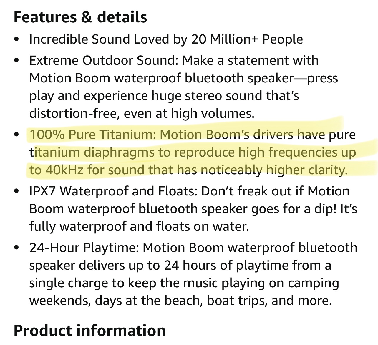

The Anker Soundcore Motion (predecessor and less expensive bluetooth stereo than the one I have) says that it is capable of producing up to 40 khz (photo attached)—— and the “Plus” version I have possesses the same Titanium diaphragms if I’ve researched properly.. so I’m thinking there may be a ‘chance’, ha.

I would regard "[reproducing] high frequencies up to 40 kHz for sound that has noticeably higher clarity" as pure marketing speak!
You could try a super tweeter, which must be protected from damaging lower frequencies by a series 1 uF film capacitor.
This sort of thing: https://www.madisoundspeakerstore.com/bullet-tweeters/fostex-ft17h-horn-super-tweeter/
However, I would source a less expensive super tweeter to use for experimental purposes before making a large financial outlay.

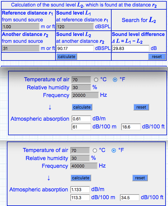

My question is this: Is it possible to do a DIY high-end tweeter that is either powered by the 3.5mm Jack, or could be powered by an external battery/amp of some sort?
Yes, but unless the source recording/playback contains sound above 20Khz, there is nothing there to amplify that high.
And even if it does, and you have a tweeter that can produce 120dB at one meter above 20kHz, in addition to the inverse distance loss of 6dB per doubling of distance (-30dB at about 100 ft, 31 meters) there is additional high frequency absorption, another -18 to -34 dB in the 20kHz to 40kHz range.
Unless the coyotes are within near range and in line with the tweeter, the VHF won't make a difference.
http://www.sengpielaudio.com/calculator-distance.htm
