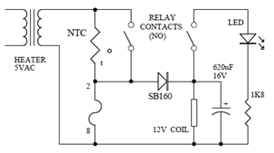

I read this yesterday on diyAudio:
For those who do [not] like [a particular directly heated rectifier tube - in this case a 5Y3], only because it does not have delayed B+ . . .
Then add an additional 6.3V filament winding (a rectifier dedicated winding, not for the other tube filaments), and . . .
Then connect a 0.65 Ohm 5 Watt resistor in series from one end of the 6.3V to the [tube's] filament, and the other end of the 6.3V to the other end of [its] filament.
That makes a Slow Start B+.
Is this true and as straightforward as it seems?
I have a 5U4G (actually a Svetlana 5C3S / 5Ц3С) that I am proposing to use (I like the coke bottle shape and its voltage drop suits, and I have a few) in an RH84 amplifier, using 6P14P-EVs. I may have a spare 6.3V secondary that I could use this way. Is it advantageous for me to do so?

You might get away with this for a very low current application.
But even one 6P14P needs 40-50mA+, and this will cause arcovers in directly heated rectifiers, if the 6P14Ps are already warmed up. (if they are starting cold at the same time, the B+ will rise immediately, even with this circuit).
Once a DH rectifier has arced over, it will repeat this trick in the same location at every startup, each time adding gas to the vacuum. Outcome: dead rectifier
Damper diodes may not be so pretty, but they provide a very smooth and slow rise time, and are much more reliable than the older big bottle types.

Typically a relay contact is needed to short out any added series resistance in the rectifier heater, in order to obtain nominal voltage for the rectifier heater once enough time has elapsed for the remaining valves in the amp to start conducting. That can be done in a few ways, such as with a cheap ebay 555 timer with rely pcb. The way I do it now for a 5U4 is to use a particular NTC resistor (5D-15) and a common 12Vdc relay (Carlo Gavazi MZPA002 44 05).
Given this is adding complexity, imho there should be a good reason for doing it, such as your filter caps will get stressed because you are using a choke-input filter. If your reason is to reduce some concept of surge, or shock, or to improve valve lifetime, then I think they are typically invalid and unsupported reasons for common valve amp applications.

The idea came from post #2 in a thread about substitutes for a 5Y3 tube. The poster proposed running a 5 volt DH rectifier, the 5Y3 from an ISOLATED 6.3 volt winding with a suitable resistor in series. The DH rectifier has a much lower heater resistance when cold that it does when warmed up. Most of the heater supply voltage will appear across the resistor at power on, but the voltage will appear across the tube as its heater resistance rises with temperature. This provides a slower start than the typical DH rectifier, but it's not as slow as a big damper tube with a large fat cathode. There is no need to short the resistor with a relay since it is sized to put 5 volts across a hot rectifier tube.
The 6.3 volt winding used by this method will be elevated to the full B+ voltage so it must not be shared with other tubes, or their H/K breakdown ratings will be severely violated leading to lots of burnt parts.
Virtually zero 6.3 volt windings actually produce exactly 6.3 volts today due to higher line voltages and a bunch of other variables, so this resistor value will likely need to be determined empirically. Math says 0.65 ohms for the 5Y3 and 0.43 ohms for a 5U4. Since it will see a big surge at turn on, the resistor should be rated for 5 watts or more for a 5Y3 and 10 watts for a 5U4.
Voltage drop across the slow start device may need to be taken into consideration. The damper diode will have a lower drop than a 5Y3 or 5U4 would have.You might get away with this for a very low current application.
