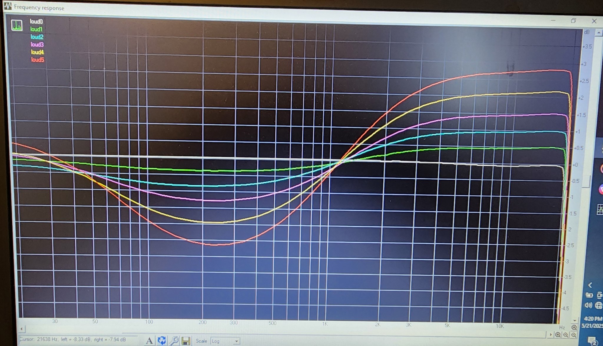

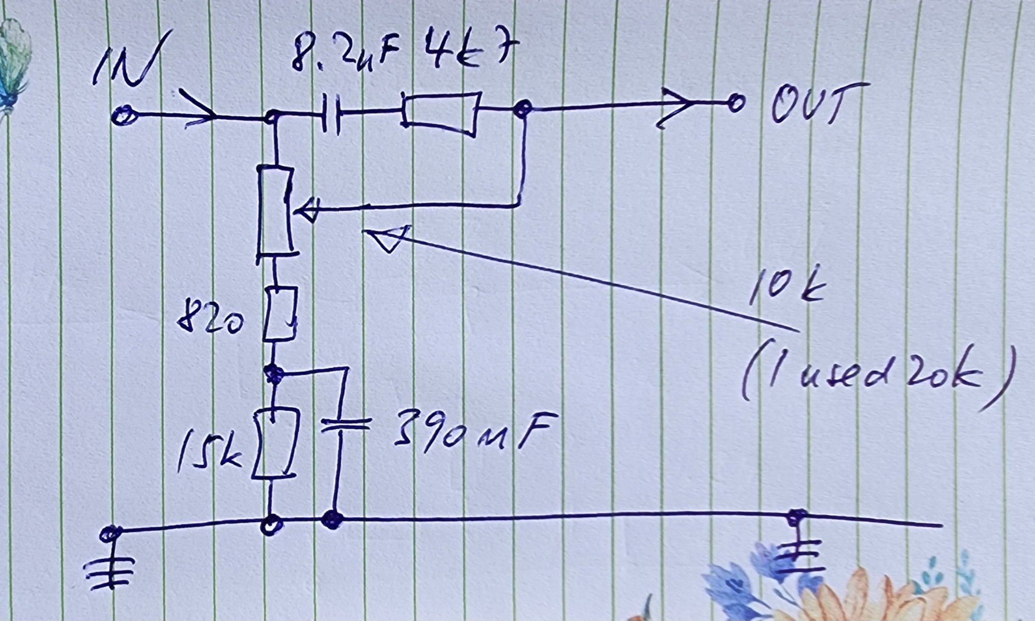

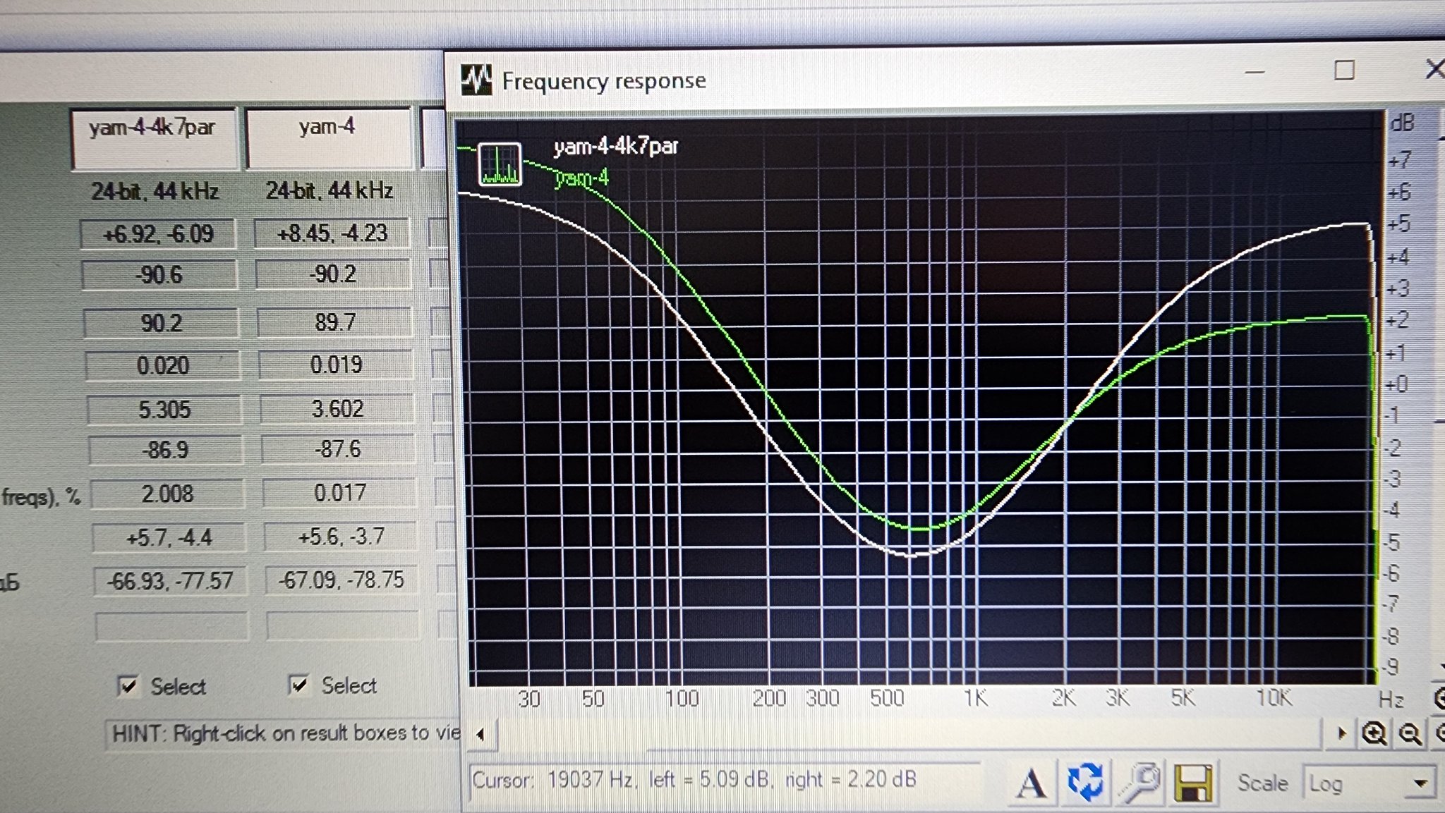

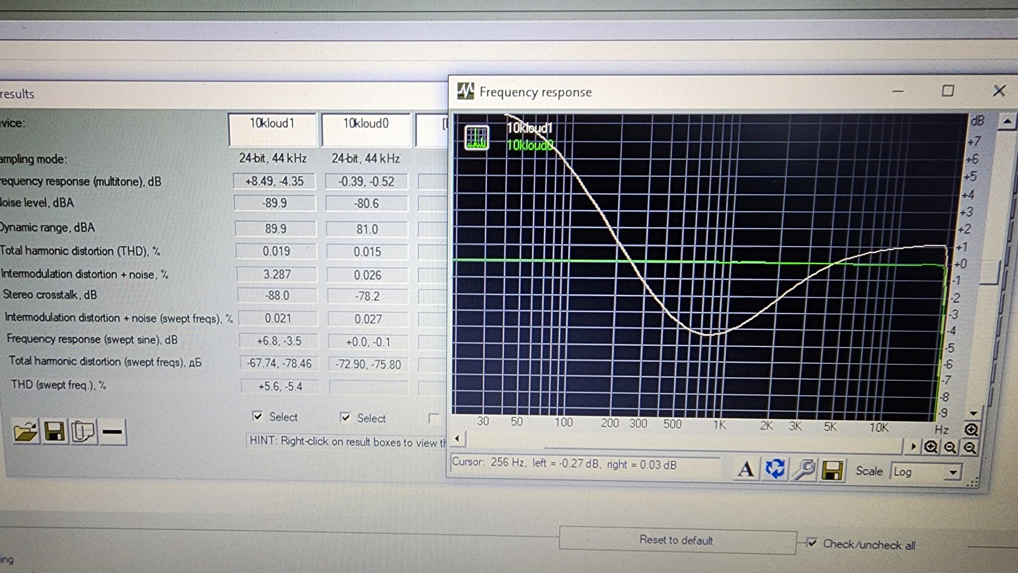

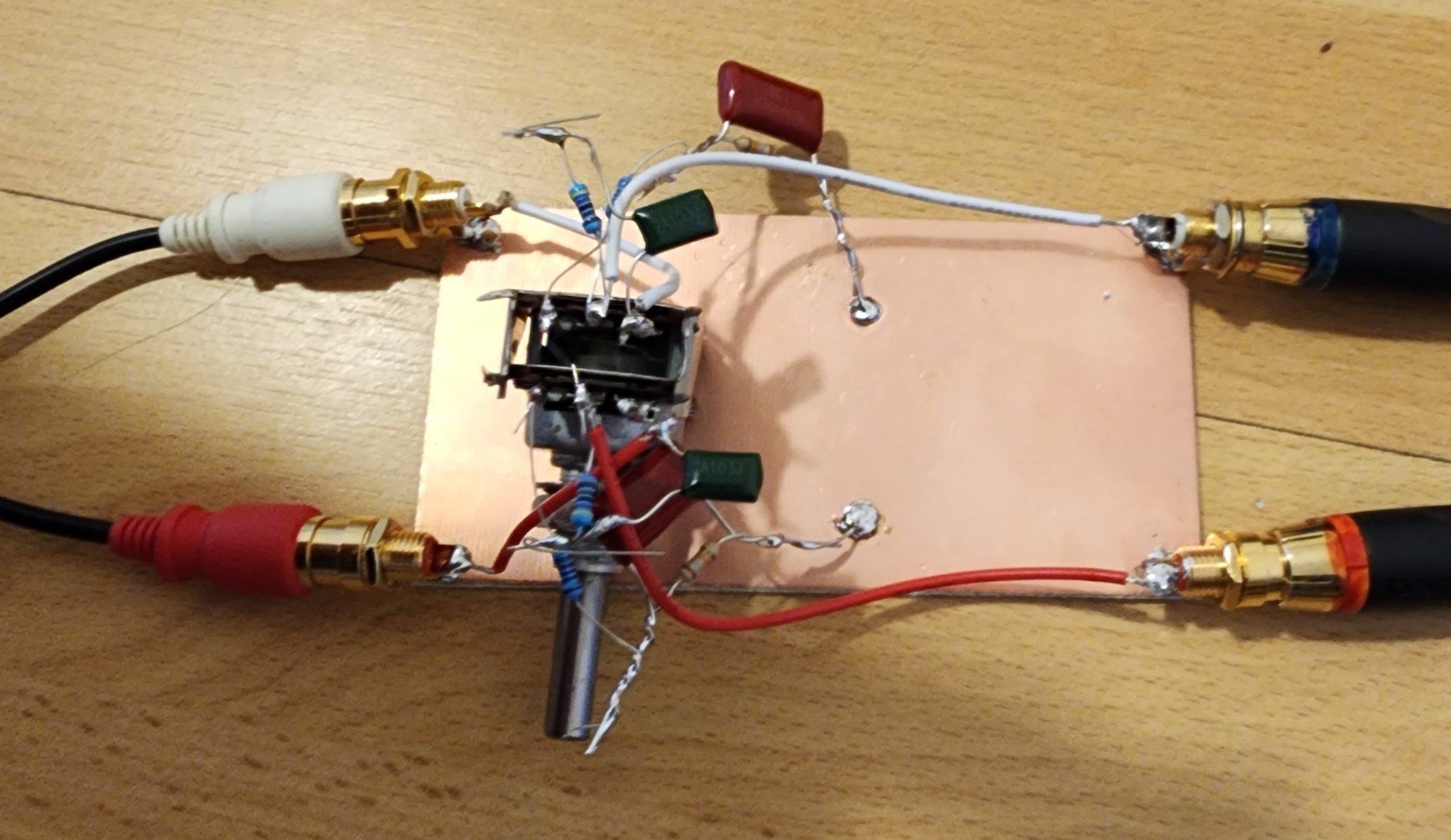

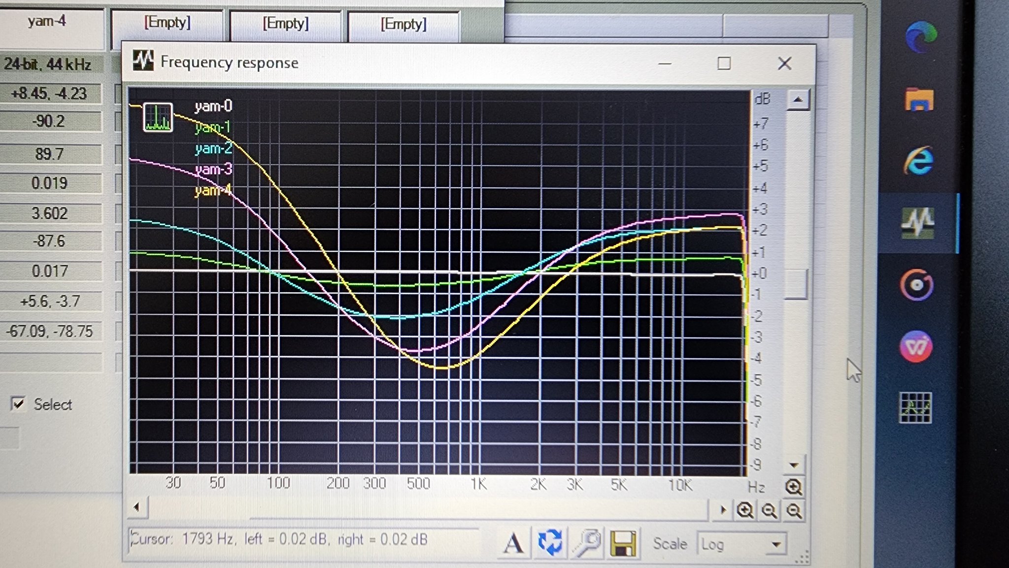

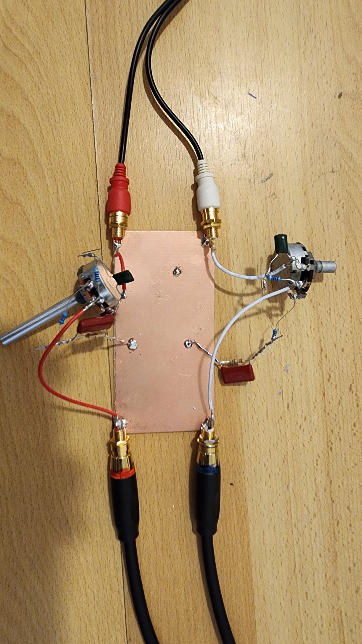

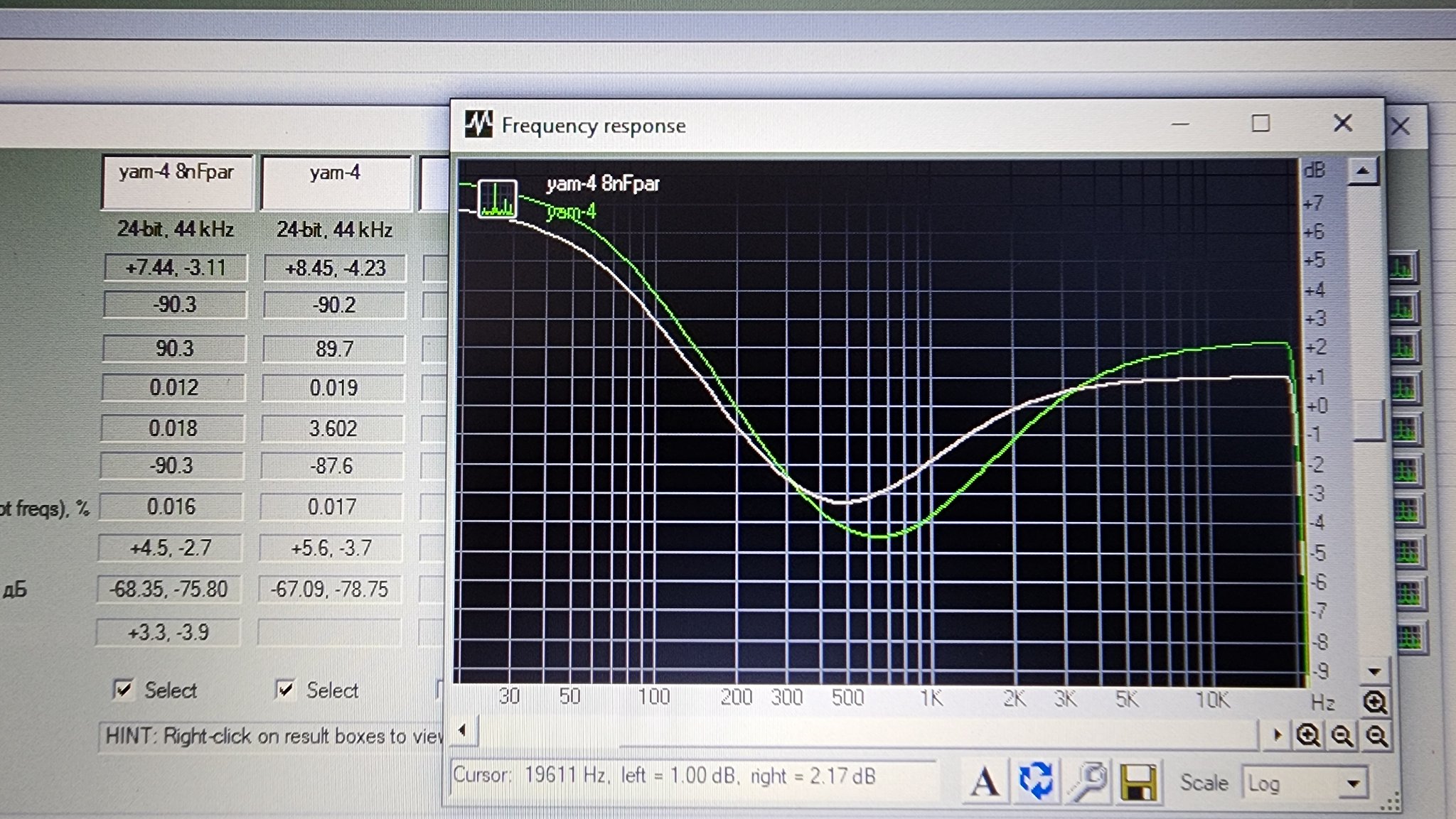

Partial success with loudness from yamaha. Well, its not exactly centered where i want, but i used 20k linear pot, because i did not have lin 10k.
First i measured with right mark audio software without readjusting the level, but as passive loudness works, it decreases midrange, so eventually right mark failed as 1kHz tone it uses for calibration was too low.
Remeasured with readjusting volume similar at 1kHz.

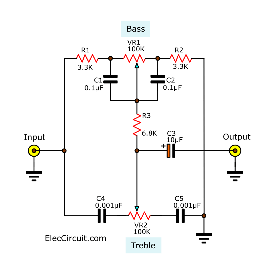

It will work, if output load is high impedance - 1 Mohm preferably. Input impedance of (phone) amplifiers usually are much lower.Well, i did the circuit i posted and its total bust. The way its drawn treble does not even work, the output has to come from the wiper of second pot. Plus both controls work only in the negative, so not for me.
Of course tone controls work only in negative - it is passive circuit.
Well, loudness works in negative too, by supressing midrange, it boosts lows and highs.
So its a matter of semantics.
Yes, that is correct.So its a matter of semantics.
Just bear in mind that most (or all - I didn't look at all of them) of the circuits here need high impedance load to work properly.
Yes, i am aware of high impedance requirement, i can easily put jfet buffer after with few hundred Mohm.
