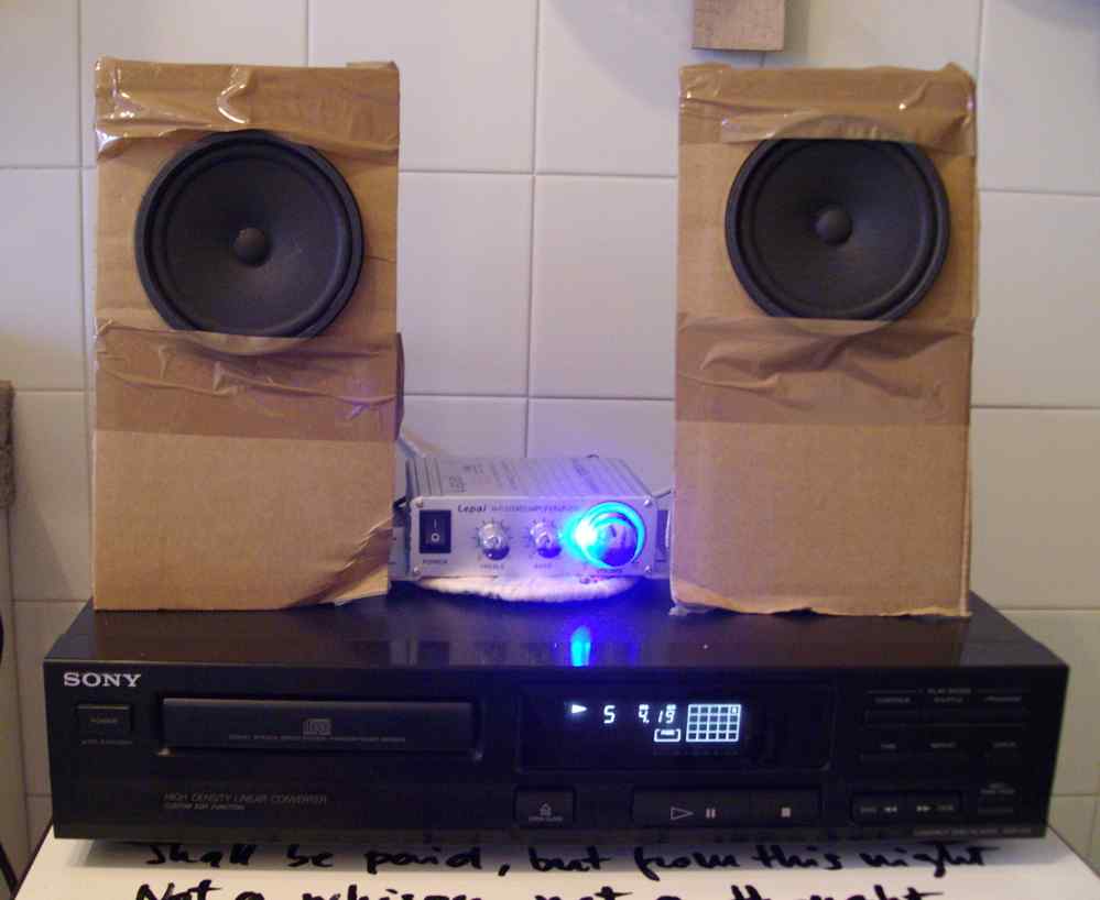

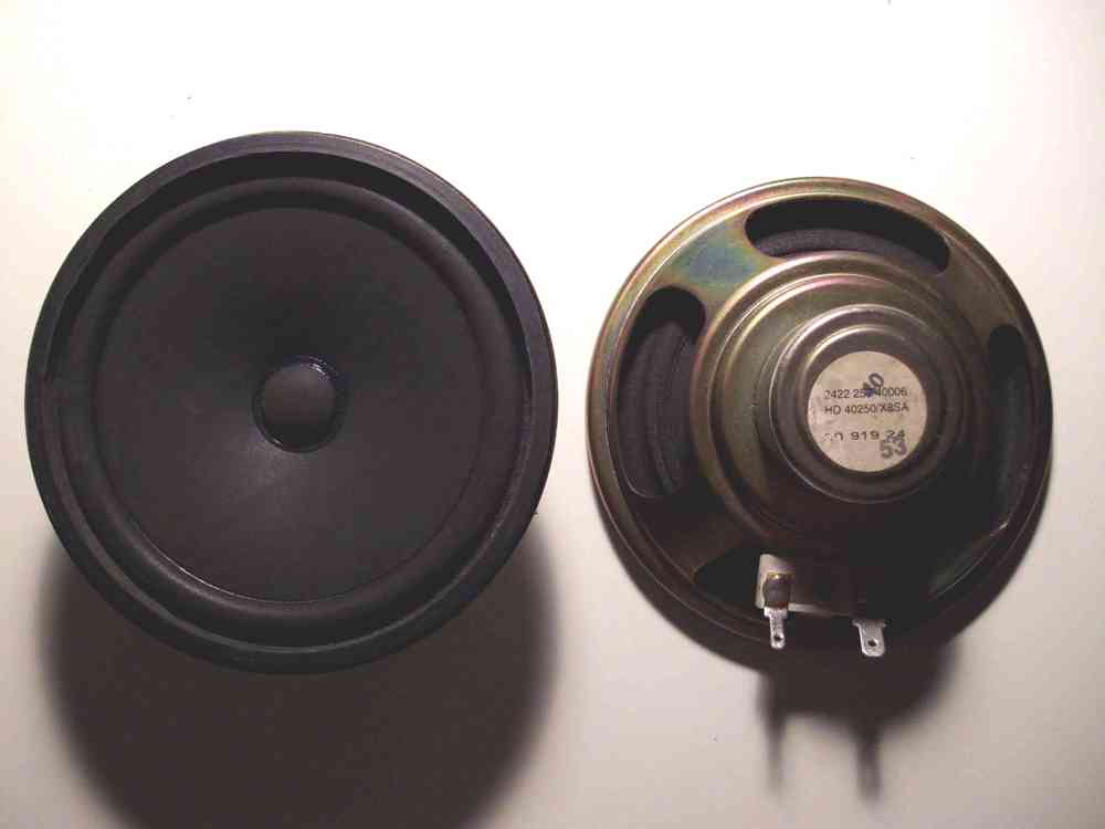

Just had these tiny (4") vintage speakers for near to nothing (2 euros). They have an alnico magnet but no mounting holes. Maybe they come from an old compact radiorecorder? Anyway, I gave them a chance with a simple cardboard open baffle (40cm x 40cm). I know you can't believe it but they sound amazingly well.
So I would like to build a little, supersimple (sealed?) bookshelf and I wonder if someone could suggest me an easy enclosure project.

OK, then fold the baffle up to make a box with no back and line the insides.

?? Folding up the baffle makes a pretty small box already and the fact that it sounds so good on a simple open baffle (OB) tells us that its T/S specs requires a relatively huge box if sealed or ported and why I recommended leaving the back open. If your nephew is at an age where he's likely to handle/play with the speaker, then of course the driver and back will need a durable grill to protect both the driver and him from damage. If you make the box smaller, then consider making the sides and back of the box out of pegboard or similar with the baffle, bottom and top being solid pieces.
Rather than stuffing the box with loose polyfil or similar, line (cover) the inside of all panels except the baffle with felt, open cell foam or similar. What type and how thick has to be found by experimentation to find what sounds best to you, though due to a female's generally more acute hearing I recommend you let his mother decide what sounds acceptable. Remember, if mom isn't happy, nobody is happy.

This morning I tried a little open box. Hmmm...
Then I made some holes on sides. Hmmm...
Then I filled the box with some fabric. Hmmm...
Then I tried some smaller baffles and... I feel imbarassed but the little speakers sound stunningly EVEN on these. Highs are so clean. I also hear very nice basses.
So I'll definitely go for OBs, maybe 40cm x30.

Fabric? Actually I put a T-shirt in the box as I were disappointed by speakers sound! 😱
Anyway, I see we all agree that OBs are the best option.
