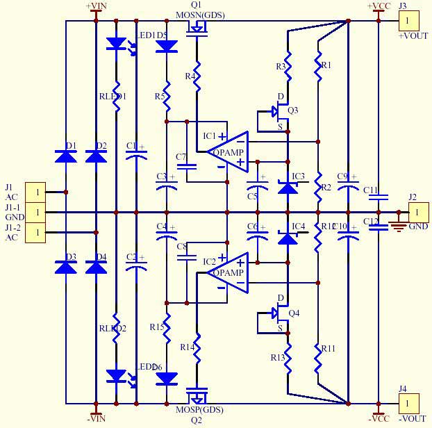

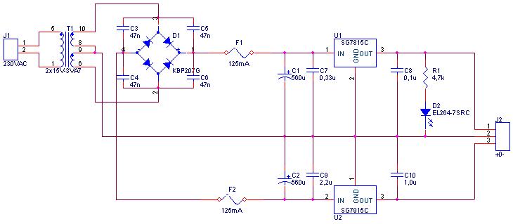

how would a powersupply look in that case?
I use a small PCB transformer -- be careful to keep the a.c. line inputs away from the phono inputs. for the power supply I use a pair of LM317's and a pair of LM337's -- for the + and - rails.
the first regulator is set to 19 volts, the second to 15 volts -- the two regulators in series seem to prevent "turn-on" thump.

for a first diy project you might want to avoid line power (esp european 230 VAC)
a pair of 9V alkaline batteries should last several days cont powering just 2 op amps
in the US i know many "wall wart" linear supplies are isolated from line/gnd so 2 "12 VDC" @ < US$ 5 ea could be a simple +/- 12 V supply
too many multi output supplies are switchers nowadays but some linears with +/-12 can be found for less than you can buy the parts - additional local RC filtering internal to your box could clean them up some
RC modelers use NiCd packs that are relatively cheap and I belive that NiCd can be indefinitely "trickle charged" so if your average use duty cycle is low enough this is a very simple and high quality option (the "on" switch disconnects the charger and connects the op amps)
