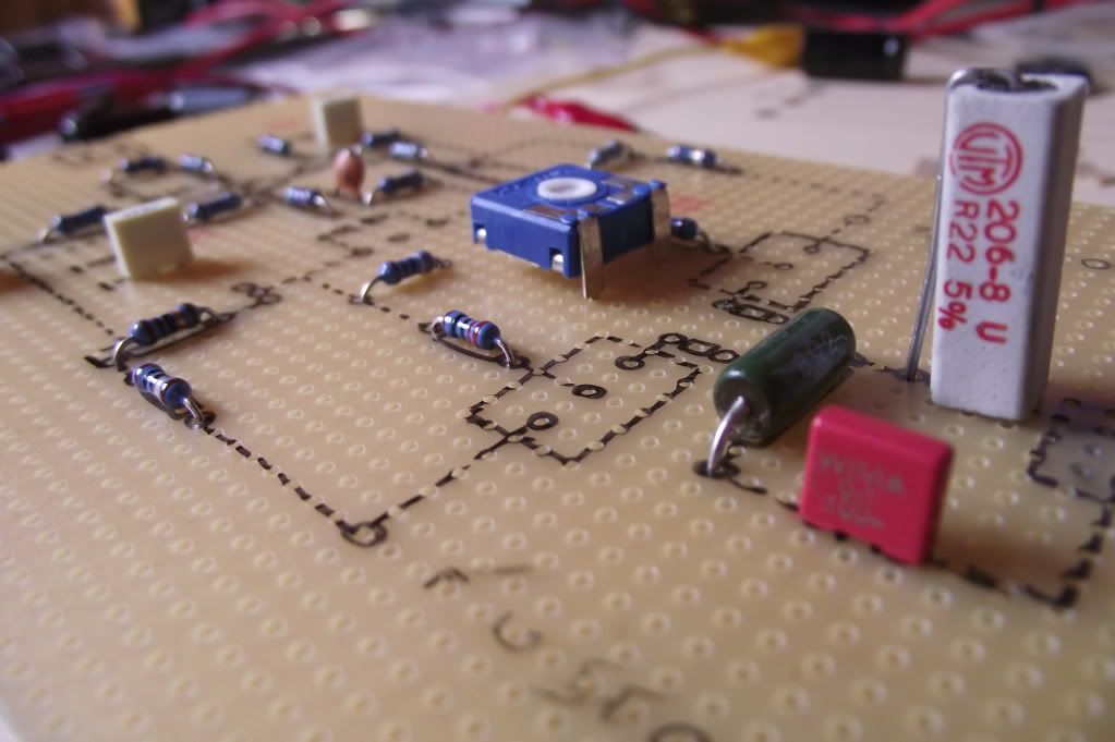

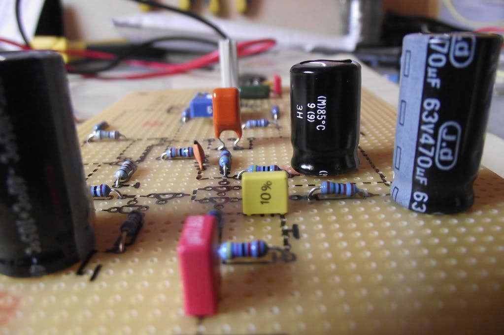

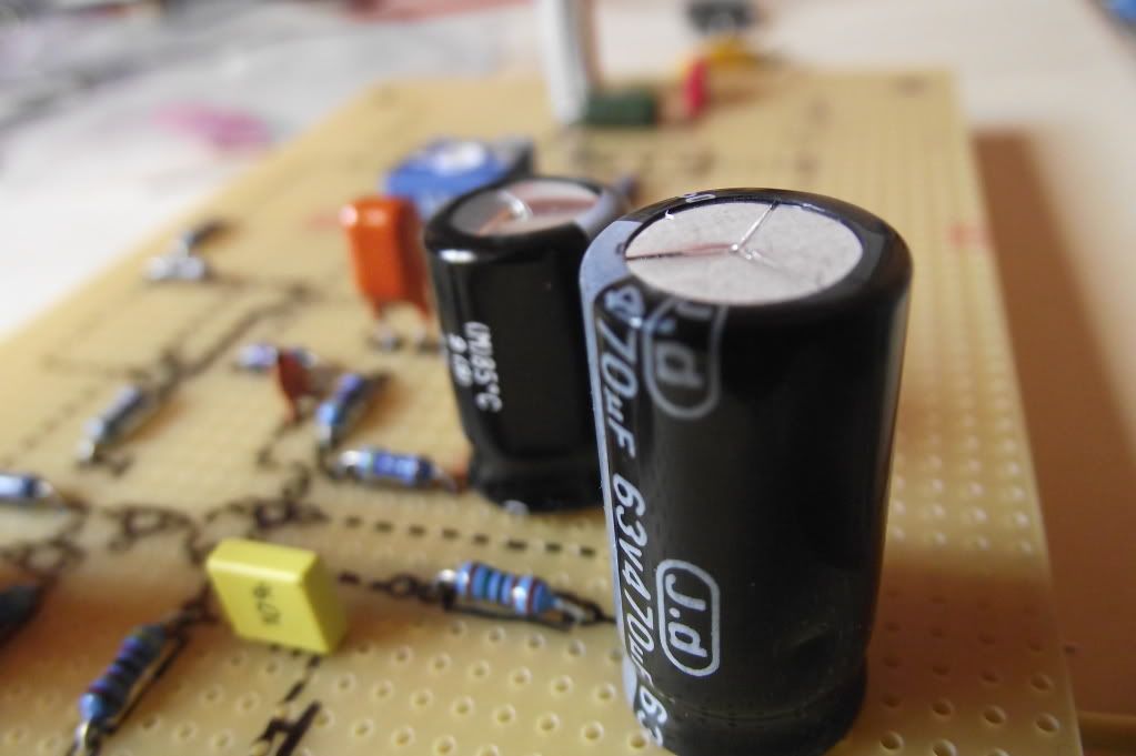

I just ordered the components for 1 channel. I'm going to solder it all to a protoboard, do some measurements, try to improve things. And most important, listen to it.
How should I mount the temperature sensing Fet on the heatsink? Right on top of an output transistor of in between the two?
Some pictures
Working on prototype this weekend, I call it 'RedFet'
It seems that the amp is VERY sensitive to noise.
I have to play loud otherwise the only thing you hear is noise and clicking noises, very strange. Grounding is one big antenna right now.
From every point where a ground needs to be, a wire is connected, then all wires are connected on PSU. The wires are 30cm long right now.
But it works 🙂
