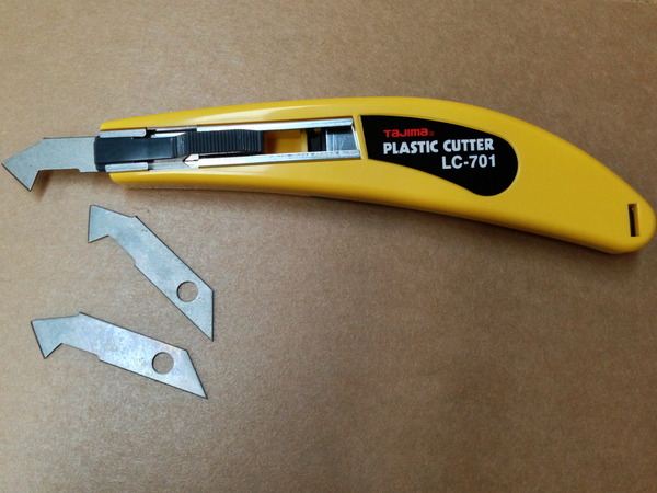

Acrylic cutter
Reviving old thread. Saw some people recommended acrylic cutters but did not specify PCB material. Have anyone tried this method, is it viable for FR4 boards? Recommendations on specific models?
As a side question what would be the recommended spacing between sub-boards for manual cutting?
