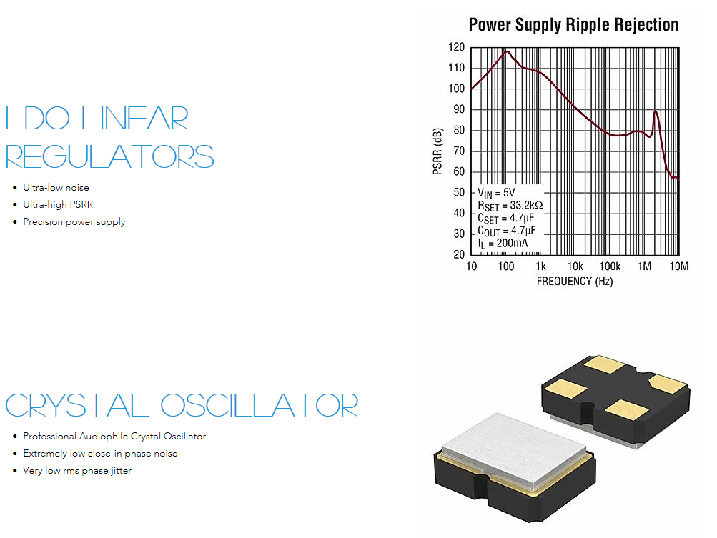

The Khadas Tone Board claims to have LDO linear regulators and high performance crystal oscillator built in.
Does that mean that in theory the DAC should address the shortcomings of a less than perfect power supply and poor quality crystal of the RPI? Or is jitter still dictated by the SBC that it is connected to?
There is no point in me powering the DAC separately (rather than via the RPI USB port) unless it will likely improve the sound quality.
"Ultra-low Phase Noise Clock Jitter: The SiTime ultra performance oscillator SiT820&8209 series with just 0.5ps phase jitter and output frequency stability as low as ± 10PPM. We chose it as a reference clock in our audio system so that the data clock jitter < 30ps."
