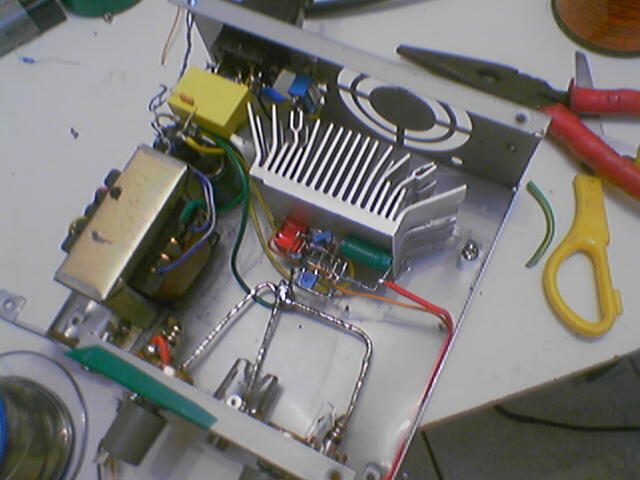

The amplifier is a great LM3886 implementation, with a serious star ground, no eletrolytic caps, and everything that make it a good amp. It's DEAD QUIET, no noise at all.

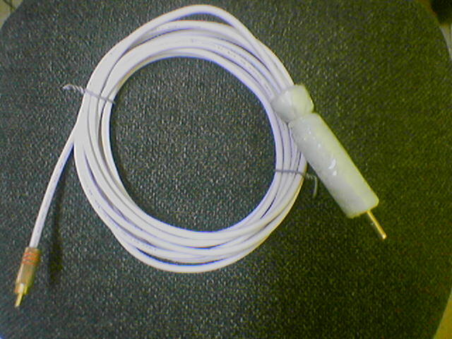

The mic is WM-61A, conected to the pre amp trough a new coaxial cable, with gold plated conector.

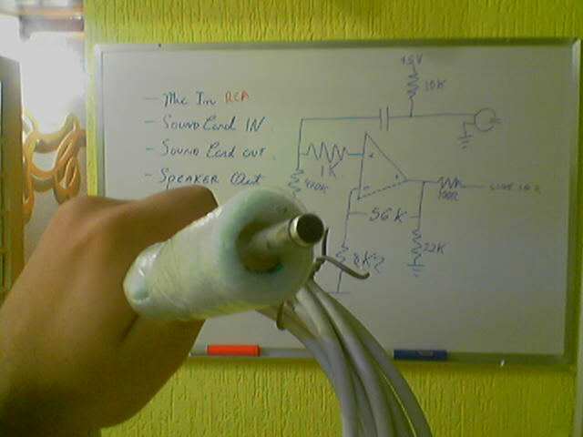

What voltage do you recommend to run the microphone, and with which resistor ?

At the moment, the microphone is running at 5v trough a 10K resistor. The DC coupling capacitors are 2x Wima 1uF MKS3 (2uF).
I'm asking myself, Is the resistor impedance high enough not to loose the top end of the microphone's frequency response?

I've seen the wm-61 driven by different voltages, perhaps if you look though the data sheet, you will find the resistor and voltage used to generate the data.-_nando-_ said:Amp + Mic Pre + Amp feedback with 1:10 voltage divider + Volume Control (amp and mic).
The mic amp is missing yet, because I don't know what voltage and resistor to use to drive the microphone ! See my post above. 😀

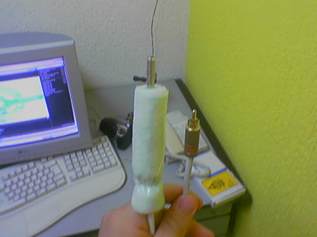

I would keep the cable between mic and preamp as little as possible. Not sure what the cable capacitance does to the response.-_nando-_ said:I don't know what size is the cable. 3 ~ 5m I guess
-_nando-_ said:Foam body to avoid vibrations
The foam is so close to the tip of the mic, I wonder if reflected waves will effect the measurement results.
Great observations.
So I'll make the cable much more short, and extend the cables from PC to the JIG box, what you think?
But, the Coaxial have a very low capacitance as I know.
I'll also move the foam away from the tip of the microphone
