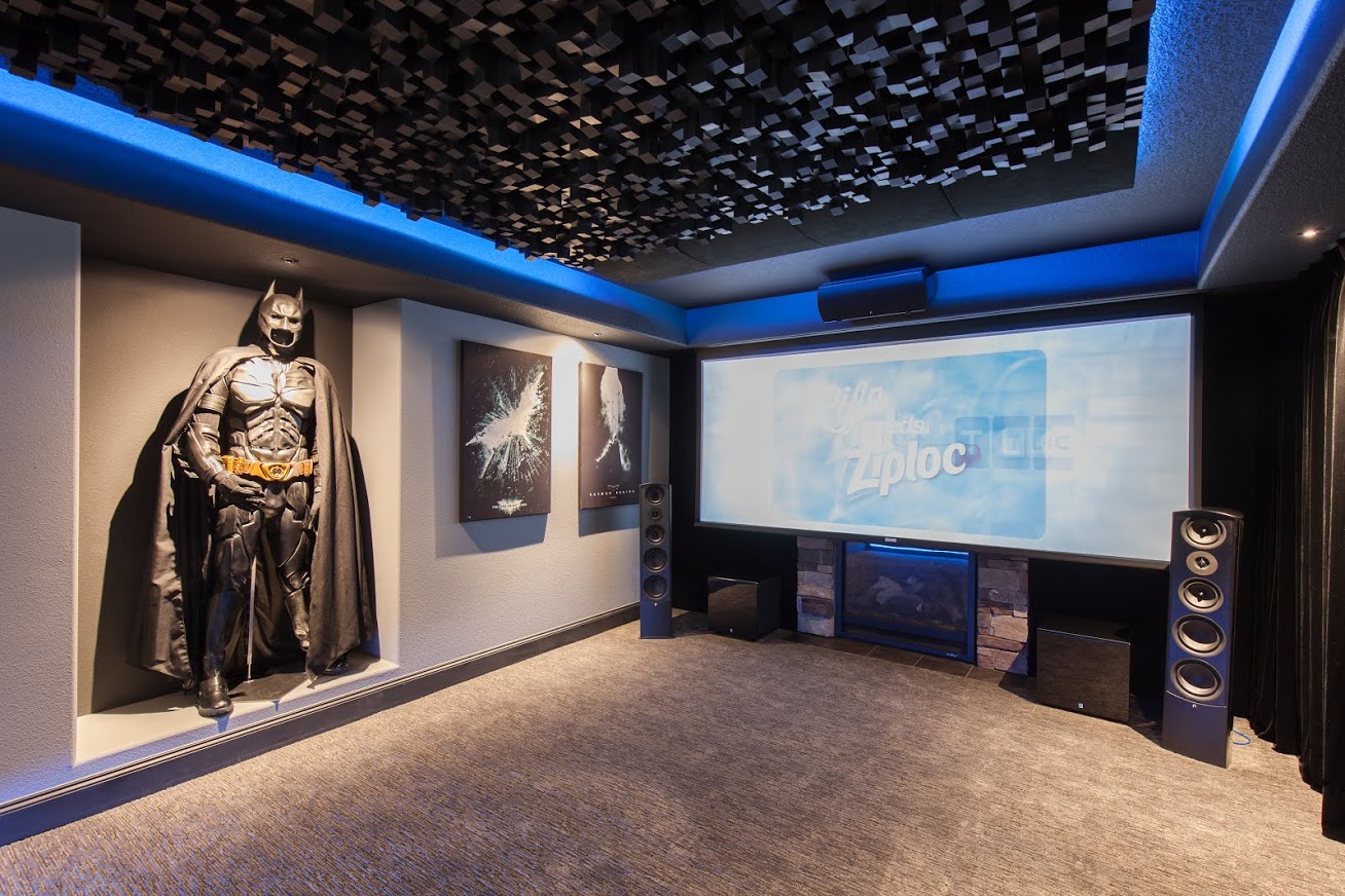

This is a room that I built for a customer. I installed the panels in the exact manner that I mentioned.
You can do this!
