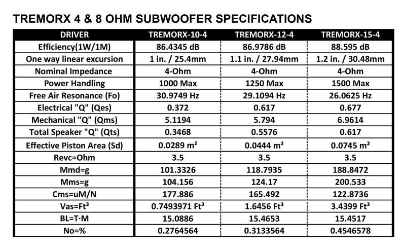

I was looking for subwoofers on the dutch amazon and came across the Earthquake Sound TREMORX-10-4 and found an users manual on the website and the specs seemed to be quite nice. so i wend ahead and entered the ts parameters into winisd and it said that the woofer failed the data integrity check. this usually means that there's a small error somewhere so i go and reset some of the values and check if it still fails the data integrity check. i came to the conclusion that winisd thinks that the mms should be 147.4 grams while the manual says it should be 104.156 grams. to me this seems quite an big difference and makes me wonder if this woofer is even any good.
next i go and try to model with this woofer (with the mms from winisd) and seem to get not quite what i want with an f3 at 37 hertz at the standard configuration.
those 2 factors make me wonder if i'm doing something wrong or this woofer is indeed not any good (for me). that's why i decided to post here.

i got the specs from here: https://www.earthquakesound.dk/wp-content/uploads/2016/05/TremorX_manual_EU.pdf
I have looked a bit further than my nose length and came to the conclusion that the manual found on the american earthquake website has other and less specifications. This one doesn't even mention the mms and has an higher fs and an higher qts... I don't know which one of these two i need to follow now...

If a driver has T/S-parameters published that's usually a good sign. T/S-parameters for driver models are subject to change without notification from the manufacturer. The other one is quite a different driver, so I would go with these specs. I would forget about mms for now and just keep simming untill something decent comes from it.

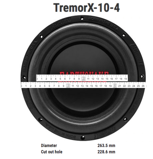

ok. i entered the Mms, the BL and the Re and left the Sd open. it is saying that the sd should be 0.0222 m^2 instead of 0.289. i think that this could very well be a measurement error because a slight error in diameter/radius can lead to quite an big error in surface area since to calculate surface area it is r^2π. is this a possibility? btw thank you all for responding!
oh and i needed to reset the fs to not fail the integrity check. it is 36.9 hertz which is just within 20% of 30.9 hertz
Generally, 1/3 to 1/2 of the surround diameter is included when determining Sd.ok. i entered the Mms, the BL and the Re and left the Sd open. it is saying that the sd should be 0.0222 m^2 instead of 0.289. i think that this could very well be a measurement error because a slight error in diameter/radius can lead to quite an big error in surface area since to calculate surface area it is r^2π. is this a possibility? btw thank you all for responding!
The Sd of the TremorX-10-4 is specified as 0.289 m^2, making the effective cone area diameter only 192mm (7.56 inches), while the the driver frame diameter is 263.5mm (10.37 inches).
With that small of an Sd, appears almost none of the surround was considered part of the Sd.
Anyway you look at it the specs seem suspect..
