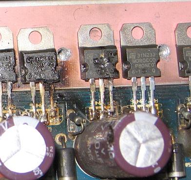

The 3-legged devices under the clamps in your photo are MOSFETs. They are likely RFP70N06s. When these fail, the MIC4424/TC4424 driver IC (IC8) and the 10 ohm gate resistors often fail also.
It's likely that you also have shorted output transistors.

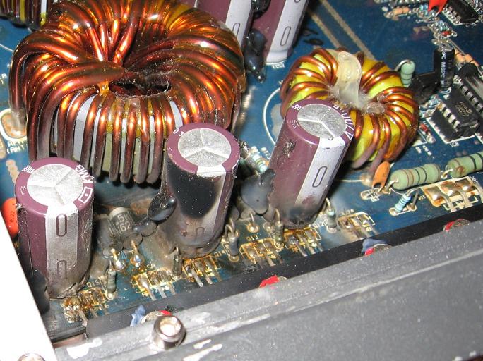

Im learning as i go along in this so i appreciate the help....Thank you...Did you think i should be concerned about the capacitors any?
Im thinking my plan of action is going to be is to replace as you said the MIC4424/TC4424 driver IC and then, All Mosfets, output transistors and resistors just to be on the safe side.

You need to check the output transistors. If they're not defective, do NOT replace them.
I wouldn't use the 85c caps on the primary side of the power supply but if they didn't fail, they have been OK for many years. If you are going to replace them, I'd recommend the FC series sold by Digikey.

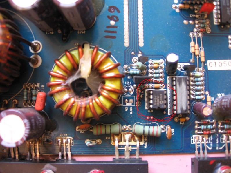

3)I could not locate the MIC4424/TC4424 driver IC and 10 ohm gate resistors but i did locate the "IC8" chip. See pic below

1. You should have had the meter set to diode-check mode.
2. I don't know how you got those readings. Where were the probes for each of the numbers you posted?
3. IC8 is the TC4424. The 10 ohm gate resistors are connected to the first leg of each of the power supply FETs.

The chip you have circled in the pic is definately the tc4424cpa chip which is indeed IC8, as for the gate resistors they are located near the powerfets a 10ohms color code would be :brown:black:black

The capacitors look OK. If they're not swollen on the top and aren't leaking, they're 'generally' OK.

Set it to diode check (diode symbol) and touch the probes together. It should read all zeros. If you read anything similar between any two legs of any individual output transistor (FET), the transistor likely defective. If all readings are above ~0.4, they're likely OK.
