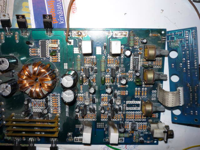

I'd like to repair this amplifier. I fixed power supply succesfully,but
the amplifier hasn't work yet.It is too complicated,that's why I need the shematic diagram. All the transistors are ok. Main components are
the following:2xTIP35/36, 2xBD911/912, 2xLF347.

I measured some voltages.
1.The 12V drop down about 8V when powered on with remote control, and it takes more then 2 amps. (I've to mention that I
try it with a current limited power supply) By the way I have a question. About how many amps are expectable normaly without
AF driving? Perhaps is it more than 2amps?
2.So there are +/-11V on rails.
3.Inotice that the NPN part of the amlifier (TIP35 and their drivers
BD911) get warm, but the other side (PNP) stand (or stay?) cold.
4.There is DC level at the speaker output!(about 1,6 V)
These happen both 2 chanels. I think that it is important.

HI
My power supply can achieve max. 3 amps.
At the output there is positive 1,6v
The voltages between B-E are 0,65 V at TIP35 so they are open.
At TIP36 are 0,4V
The rail voltages are +/-11v instead of +/-28v, and +/-3v are
on 4 and 11 pins of the op-amps.
I'll send a photo about the PA latter.

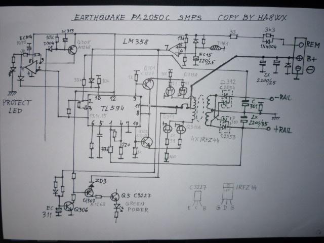

In the meantime Idrew the circuit diagram of the power supply.
It is not 100% complete.
Well I removed all the components from the rails except capacitors
(2200uF) and feedback resistors. When I applied B+ and power on
the rail voltages was +/- 28,1 Volts. Then, the idle current was
0,35A at B+. After that I applied 2X 24V 5W bulbs at dummy load.
Than the current was 1,5A and voltages +/-28V.
I was happy. It ment that the power supply section is OK.
