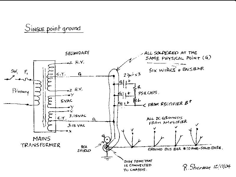

On the S.P. ground approach...
Here's my sketch (my marker was a bit rough!) I attached the file but can't seem to copy into the message (how do I copy and paste into the post?)
It gives the general idea of what I said.
I ground all PSU cap negatives, the center taps from the HV
secondary and the Signal Tube filament secondary and the RCA shield and one end of the Busbar to the same physical point on the chassis.
Should the RCA be located away from this, then the shield must be installed insulated from the chassis and a wire run to the single point ground.
This has worked for me every time.
The grounds from the actual amplifier circuitry can be also soldered directly to the same physical point as the S.P., but I typically run a #10 AWG Bare Solid wire (from leftover Romex) as long as I need and leave one end floating (insulated from chassis) and the other end connected to the S.P. Ground location.

@rich
Very nice schem!
Some questions:
Can I connect all the DC grounds from the amplifier at one point (not chassis point) and then connect this point at SP?
If I have two channels, can I use two bas bars? Or two points, one at each channel, and then connect them at the SP?

Yes in both cases.
You can collect the DC Grounds from the amp circuitry at one point on a tag board and then run a wire to the SP ground point.
This would be an 'equivalent' approach and help with the wiring layout and # of wires to be soldered together at the same node.
On a stereo amp you can run two Busses tied together at the SP point and then aggregate the grounds independently for each channel.
The most important ground connections for the lowest hum are made by soldering at one single point all of the Power Supply capacitor negatives, the HV Center Tap and the Filament center tap and finally the Bus Bar.

One connection that I have omitted in my diagram that should be included is the (P.E.) or Protective Earth. In my country, our electrical system uses a 3rd wire that is connected to the chassis as well as having it's own independent wire that connecting back to the electrical panel earthing rod tie block.
The purpose of this ground is to prevent the creation of shock hazard on a metal chassis. The 117VAC mains consists of 3 wires. Black = HOT, White = Neutral and Green = P.E.
It is this 3rd P.E. wire that is connected directly to the metal chassis (not necessarily at the same SP gound location, but highly recommended to do so) wire that can cause ground loops to occur in relation to the mains and other stereo equipment that may have different grounding schemes incompatible with one another.
Some Guitar amplifiers implement a 'ground lift' circuit that consists of a Single Pole 120 VAC, 3A switch in parallel with a 0.01 uF /1000 Volt ceramic disk capacitor tied to the chassis.
If by any chance one gets a ground loop at a venue or at home, the switch can be opened and the 3rd wire is AC coupled or lifted from the chassis via the capacitor. This can also be found on some Stereo Tube Amps i.e. the Caztech SE 5881 amp from Canada offered this option.
Ground Lifts eliminate the AC shock protection, but can solve some ground loops issues.
