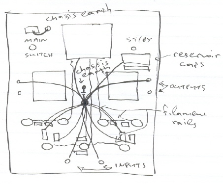

I would run a star type earthing system. Use a single point on the chassis for earthing. Run one earth wire from the input jacks and volume control, one wire from the preamp tube cathodes resistors, one wire from the power tube cathodes resistors, one wire from all power supply earths, and one from the output transformer ground.
This kills earth hum in 99% of all my amps...

Things got better when I change the wire that connects the input tube with the phase splitter with a shield wire. So, I believe my problem is on wiring. I think I’ll try star earth. What do you say to try something like this in the attached foto.
Now I use a bus bar from the RCA inputs and follow the signal until the OPT. And I grounded them between the RCA at the chassis.
The supply starts from the first caps of the PSU and continues with a twisted wire until the last cap near the input tube. This ground is taken from the first cap of PSU and goes to chassis with the main earth and CT of filament windings.
Please help me guys ‘cause I love the sound of this 6L6GC UL amp. And I haven’t use feedback, yet. Also, not any matching of the signals at the outputs of the phase splitter. I haven’t tested different bias at the 6L6. Now I’m at 65mA and Va at 420V.

I think u should look at residents picture but earth only at "ONE" point to ur chassis and the second thing is... ur main transformer is he screwed directly to the chassis because u can better use some rubber rings between the transformer and the chassis so they will absorbe the 50Hz from the main trafo so it wount be shaiking ur OTP no more and reduce the hummmm in ur speakers !

Do you agree with my pic?My next movement is to build it like this.
I would definitely connect the chassis to ground for reasons of safety. If you have to, use a 100 ohm resistor instead of the capacitor. You really don't want a chassis to be many volts above ground.

Does your 6V filament winding on your mains transformer have a centre-tap to earth, (i.e. three wires, 3.15 - 0 - 3.15 Volts), or are there only two wires from the LT supply (i.e. 0 - 6.3V)? If there is a centre tap winding, ensure it is, in fact, earthed. If there are only two wires, then take two 100-ohm resistors and connect them in series across the 6.3v winding. Then earth the centre point of the two resistors to your single chassis earth.
Please note that this is only to be used for your amplifier tubes and NOT the tube rectifier filaments if you're using a tube rectifier.

SAFETY! Never, ever, remove the mains earth from the chassis! If you have a hum loop because of two earth connections, break the connection between the signal earth and the chassis, NEVER the mains earth. We don't want people missing from the forum because of an electrical accident.
Star earth is ready. I use only one chassis earth point with 100R resistor.
Things become too much better!!
