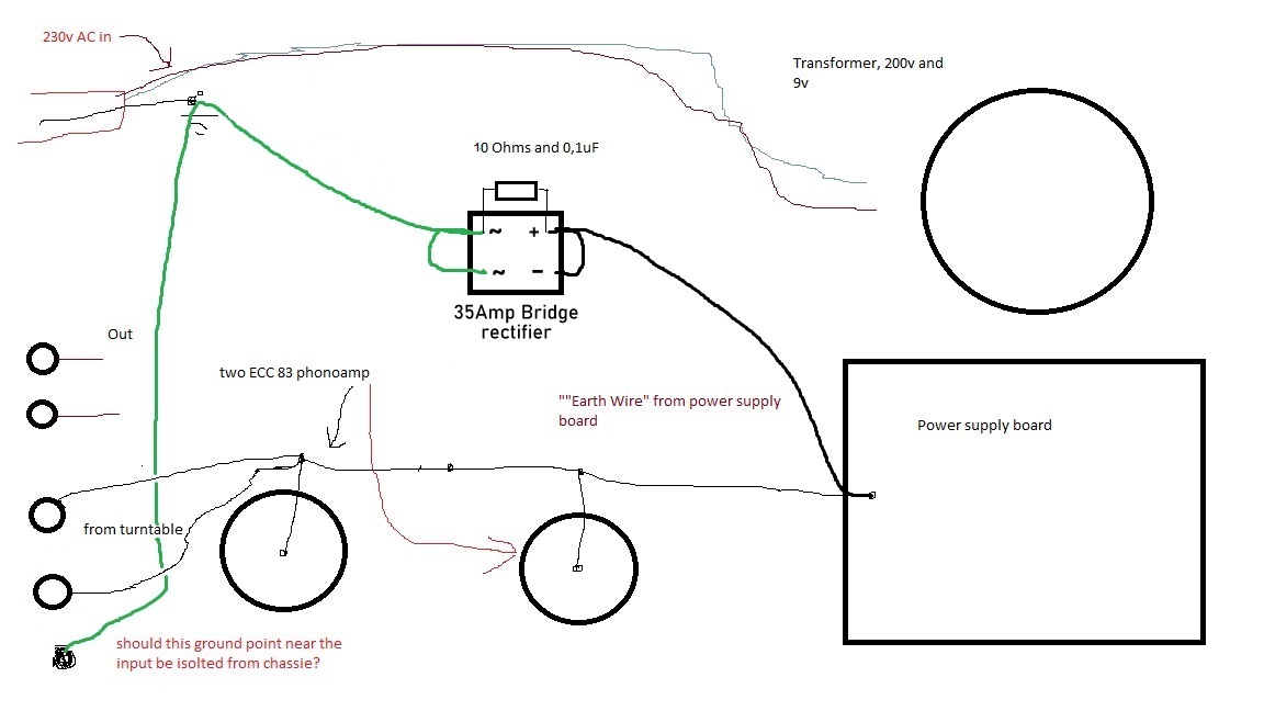

Building myself a tube phonoamp, and I have some questions about earthing/grounding. In phonoamps we have the grounding screw close by where the phono chassie socket are, were the plugs from the TT are connected.
I wonder if this earth/gound point must be isolated from the chassie?
Se my bad drawing...And thanks for a great forum!

It looks like you have the signal ground lifted from chassis ground with the 150 ohm resistor? You should have for safety 2 high current diodes in parallel with that resistor and cap, one in each orientation. To answer your question, yes grounding post direct to the chassis, and not connected to the separate circuit ground. I did something similar and added RF shunting caps from each RCA input common to chassis, I think it was 0.01uF maybe.
Yes, what Alan said is how I do it. The link to the ESP page describes it well. The bridge rectifier makes assembling easy, the resistor and cap can be mounted on the rectifier pins, and it's all mounted with a single bolt, which can be used for the chassis grounding (wall power safety ground should be separate.)
The purpose of the cap is to shunt any RF garbage to chassis. It's effect may or may not be noticeable on its own, but I've found RF mitigation to be worthwhile in general, and this particular use of the cap is pretty standard in this application.
