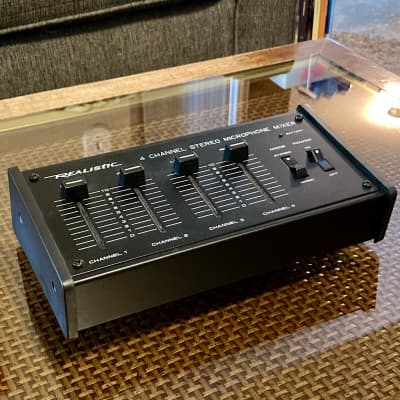

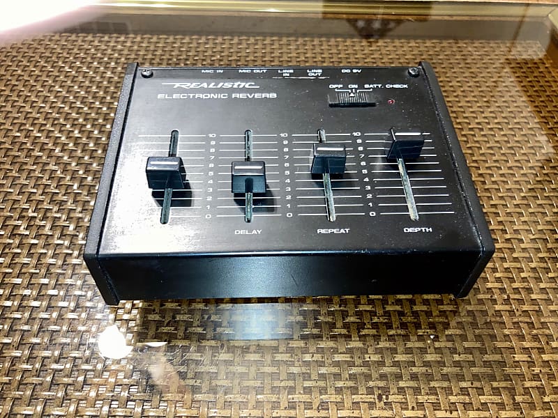

I've got a Tandy stereo mic mixer languishing in the loft, as well as a (Soundlab?) disco mixer with MM inputs. Given the extremes of temperatures they have experienced in the loft over the years, they probably don't work anymore! I've also got a Tandy reverb unit that I used to have a lot of fun with on both mic and guitar in my younger, more experimental days!
Ditto but my old reverb unit is Sony/Pioneer or somesuch. I should drag it out and insert it somewhere in the chain. My Tandy Mike mixer unit is even older than that and tales 12V DC from a wall wart. Old gear can be fun, if it still works
