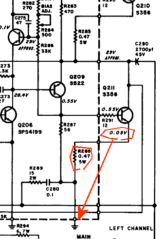

struggling with the BIAS adjustment though. I understand this is done with a volt meter but the service manual for this particular amp gives no instructions as to where to measure from or what the voltage should be.
No, the manual tells you to use an oscilloscope.
That needs some practice and can be very wrong if the amplifier is still sick. There is a voltmeter clue on the schematic.

If I'm reading it correctly, I take a reading between R288 and Q211 referenced to chassis ground and adjust the Bias pot until I get 0.03V (AC ?)
Is this correct?
It's 0.05V, it is DC, and good luck.
I connected dummy loads to both channels and let the amp warm up for about 20 minutes, volume at minimum, and as per the service manual, both bias pots fully counter-clockwise.
Left channel...only had to turn the pot less than 1/4 turn to reach .05 v dc
Right channel...had to turn pot about 3/4 turn to reach the same
Checking other voltages in the amp section I found the following,..... Note: spec'd voltages from schematic are in (parenthesis)

BIAS voltages match to a T : 0.05V across emitter resistors
ONE Rail voltage is grossly wrong (36V vs 29V).
Only possible way to have that is amplifier is a dual monobloc with separate supplies, which I doubt, so remaining possibility is measuring error.
As nareshbd suggested, trace voltages backwards and forward from collectors to supply big capacitors, step by step, use always the same point as ground reference for both channels, you are making some measuring error.
Rail voltage difference is NOT a Bias problem.
