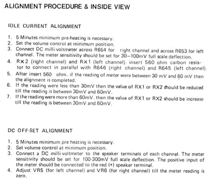

I then installed 1R 3w resistors in place of the strap on r653/654 to measure and set bias, I also substitued RX1 and RX2 for 2K trimmer resistors.
The bias setting went smoothly and I was able to get 30mV on both sides (I controlled temperatures of all the fets and no one where higher than 36°). I let the amp warm for 15min or so to fine tune the bias. I also set the output offset to virtually 0 (0.2mV/0.4mV).

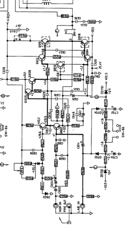

R652 as burnt, destroying c634 in the process, I tested the semi and Q610/612/614 and both the power trans Q616/618 where fried.
The left channel is intact.
Looks like some kind of oscillation destroyed the right channel, as the runaway started when signal was present.

Never use a resistor instead of the link, always close the solder bridge when 30mA is flowing normally.

With Q610 thermally coupled to the output heat sink, it will track the temperature changes. DO NOT fit the bodge emitter resistor, there is no advantage.
C634 is part of the output stage HF load network and only fails when the amplifier oscillates above 50kHZ, just before it destroys itself. Nothing to do with bias settings.

So If I understand well I got to insert a resistor between the base of the power trans and the emitter of the driver (after R651/652 and C633/634).
Will a 4r7 res be ok as emitter res?
I'll also change Q611/612 to BD139/140 as the original one are not easily abtainable...

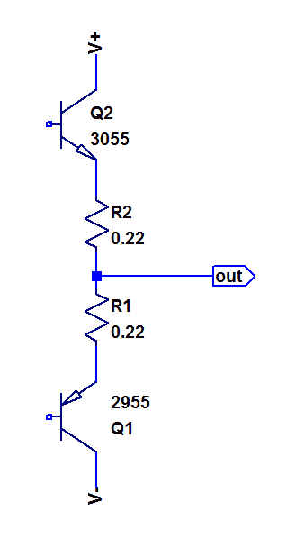

Nope. The amplifier is missing these guys, found on just about any other similar construction known to man:
attachment.php
Typically 0.22 ohms 5 W.
The ones you mean also come in handy at times, but let's start with the basics.
As said above you need to add some resistance to the EMITTERS of the output transistors. 0.22-0.33 ohms will work. I find vitreous enamelled resistors rated for 3W work well for this.
