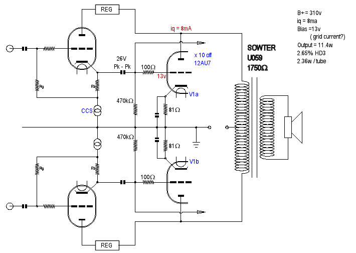

How do you get that output from ECC83's???
You dont. at least not in anyway I can see (which isn't saying much) but you can get it from ECC82's
Problem is ECC83 / 12AX7 has Va Max of 300v and Ik max of 8ma the ECC82 OTOH is Va Max 300v but Ik is 20ma rating at 2.75w
I can't get it to come with any sort of compromises I'd willingly take on. Its simpler to do it with the 12AU7 / ECC82. I *must* be missing a trick.
What is "Tim’s highly developed Balanced Bridge Mode ultra-wide-bandwidth output transformer"?
Marketing.... "highly developed" 🙂 who would claim otherwise?
I wonder if balanced bridge is another way of saying distributed load? a la Quad 2? Somewhat different to what I've drawn. Its equally possible that the thing is completely off the wall
kevinkr said:I believe so, if just barely. The idea of running 12AX7A into the grid current region of operation is disturbing..![]()
Indeed, I ran like a scared puppy, disregarding that restriction (and Peak Ik to some extent) you can get 20 watts with the grid at +4v
As asked, I've fleshed out the schematic I was tinkering with, please note this is the result of a simulation rather than any serious soul searching.
(incidentally I recommend the P-P calculator for this, its a sight easier than actually thinking about it...)
Yes, it is. More of a McIntosh than a Quad II because Tim de P uses equal loads in anode and cathode.
I seem to recall reading that Tim had some of the output transformer windings on the cathode side as well as the anode side of the tubes. I suppose if you floated the grids to about 1/3 of B+ with a cathode resistor and a bypass cap and then had your transformer windings in the same place that you would normally have the load resistors on a Concertina phase splitter you could have a lot less voltage across the tubes.
