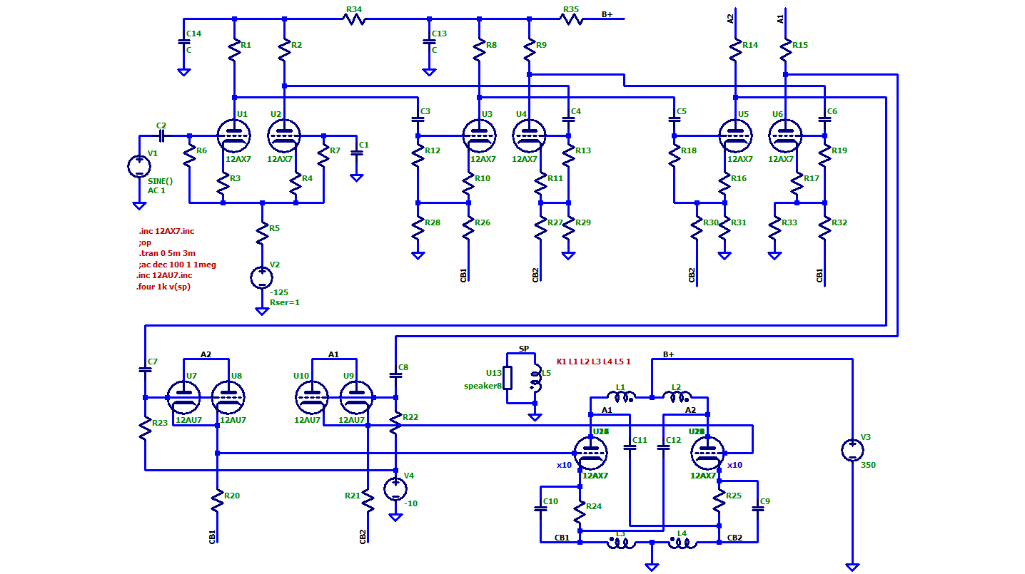

It uses ten 12AX7 / ECC83 tubes (!) per channel as outputs in a PP configuration, five tubes or 10 small signal triode sections per phase.
This caught my attention and so I took the description from the article and tried my best to convert it to a drawing of the circuits. I may not have figured every detail and of course I do not have any actual component values. A spice simulation with arbitrary numbers seems to work and I get reasonable signals from it.
The output stage is unity coupled, so the OPT requires dual primaries, one in plate circuits and one in cathode circuits similar to MAC but no bifilar windings are being used. The author of the article however erred when he assumes that this means cathode degeneration. As in the MAC and also in Norman Crowhurst's "Twin-Coupled Amplifier" this local negative feedback is cancelled by the positive feedback from bootstrapping the driver stage. The author also incorrectly describes the use of cross coupled capacitors in the output stage to make up for the lack of coupling between the primaries caused by not using bifilar windings as "devised by Mr. Paravicini". But Norman Crowhurst's article "Twin-Coupled Amplifier" from 1957 already described these capacitors as necessary to take care of the middle and high frequencies. https://www.audiofaidate.org/articoli/Crowth-twincoupled.pdf

Reading the description given in the EAR publication I get the sense that the output is simply a PP set of 10 or 20 12AX7s. So driven hard there could be some 10-20 watts of audio. Better results are usually got with low or medium mu triodes, 12AU7s would probably be a better choice.

or 6n1p 's ...Reading the description given in the EAR publication I get the sense that the output is simply a PP set of 10 or 20 12AX7s. So driven hard there could be some 10-20 watts of audio. Better results are usually got with low or medium mu triodes, 12AU7s would probably be a better choice.
I got 13 watts from my sim, which is guesswork from the description.
But the major issue seems to be to find a solution not to over-steer the 3rd amplification stage. In my sim total THD stays under 0.03% until about 3.5 watts, above that it quickly rises to 0.3% at 5W and 0.8% at 10W. The sudden rise in THD happens exactly when the 3rd stage enters grid current. The two nested FB loops struggle to tame that, after all the open loop gain is actually 60dB and FB drops that to about 30dB. So the art seems to be to prevent the 3rd stage to draw grid current.
Or maybe that is the reason why in the original there are "resistors across the coupling caps adding a tough of DC coupling". I haven't found out yet how to do that though without disturbing bias altogether ...

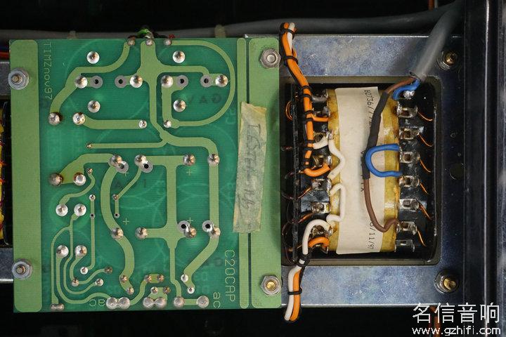

It is necessary to replace all 40 cathode caps. The tiny specimen used
here, albeit printed 105°C, are located close to the tube sockets and
deteriorate quickly. Leaking electrolyte can cause corrosion in some
places on copper side also. I recommend to solder replacements on
the other side of the board and used professional sealed mil types.
There is just one other radial lead cap, 47 µF 50 V which should be
replaced. All axial lead caps (Siemens etc) and all resistors except one
tested fine.

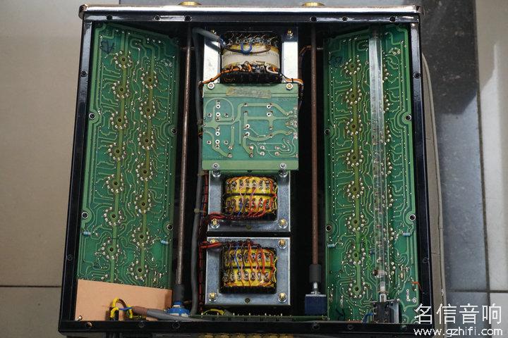

It is possible to unscrew and move the boards up for changing parts
without removing the wiring. Doing this and other work you can see
though that this construction is unnecessarily clumsy.
Filament wiring is on board with copper traces. Some of the traces are
too small, only 1 .. 2 mm here and there. Have a look for local signs of
overheating.

Input switch board and especially volume board interconnects to RCA
board can be damaged by rough handling of the respective rotary knobs.
This can be hard to repair. Missing signal ground is no pleasure here.

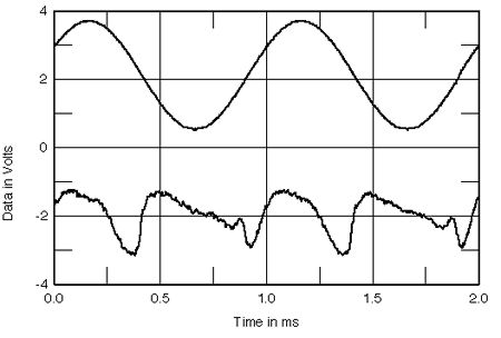

the residual distortion character (fundamental notched out) don't looks good - diagram of image No 9 and under
EAR V20 integrated amplifier Measurements | Stereophile.com
What could be therefore the reason ? Maybe not good matching ?
some images in the attachment.

Distortion in Fig. 5 of this test report is taken at high power
