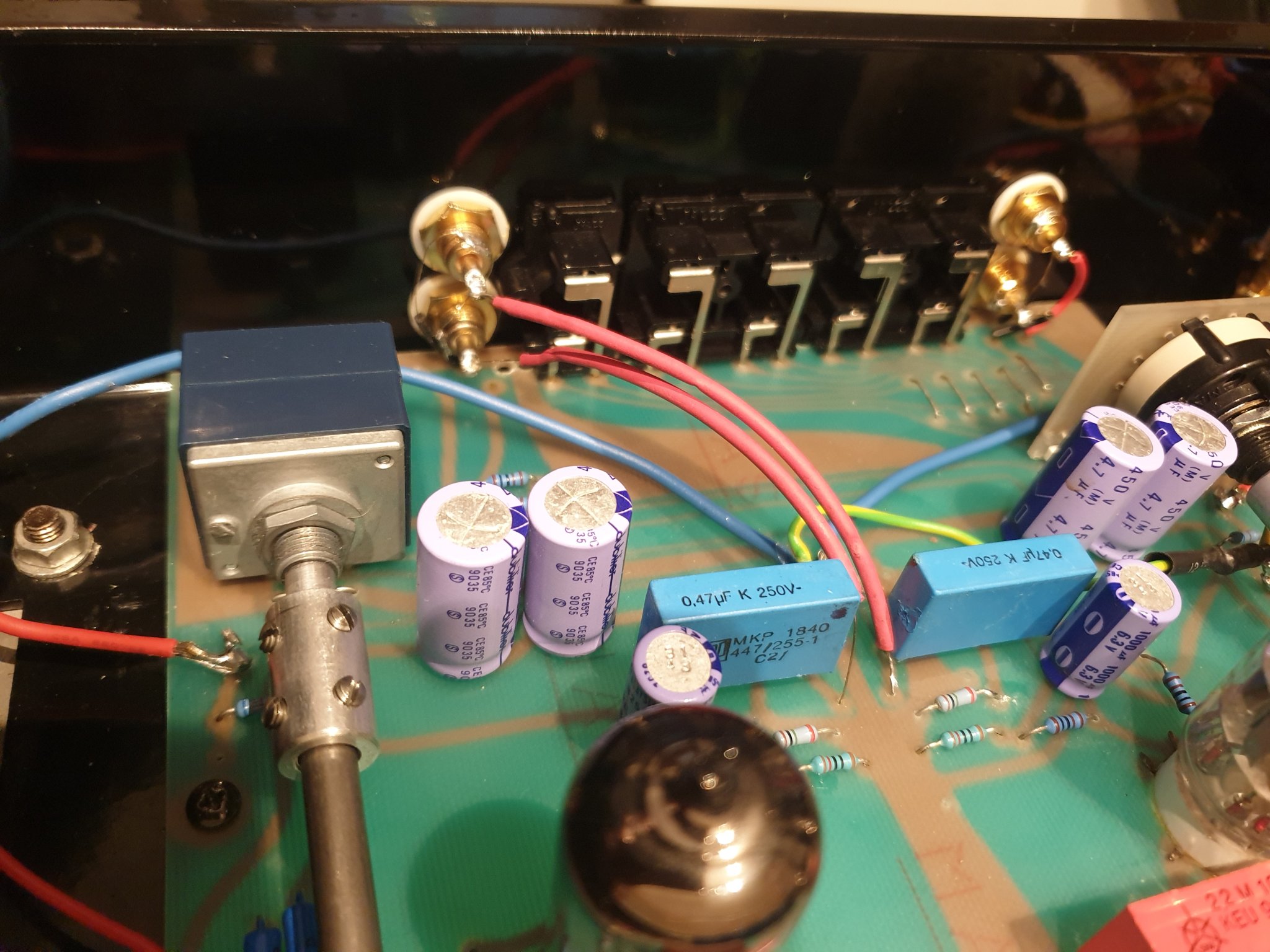

Out of curiosity I measured some resistor values which measured differenttly in there from the schematics, a couple were measuring correctly out of the circuit and were put back in but I found and substituted a 1,2K resistor for a 120ohm resistor as per supplied schematic (at the cathode of upper valve section of the input cascode).
There is also what I think is a big mismatch in the output pcbs as pin 7 of the output valve appears NOT connected... I'd like to possibly figure this out too.

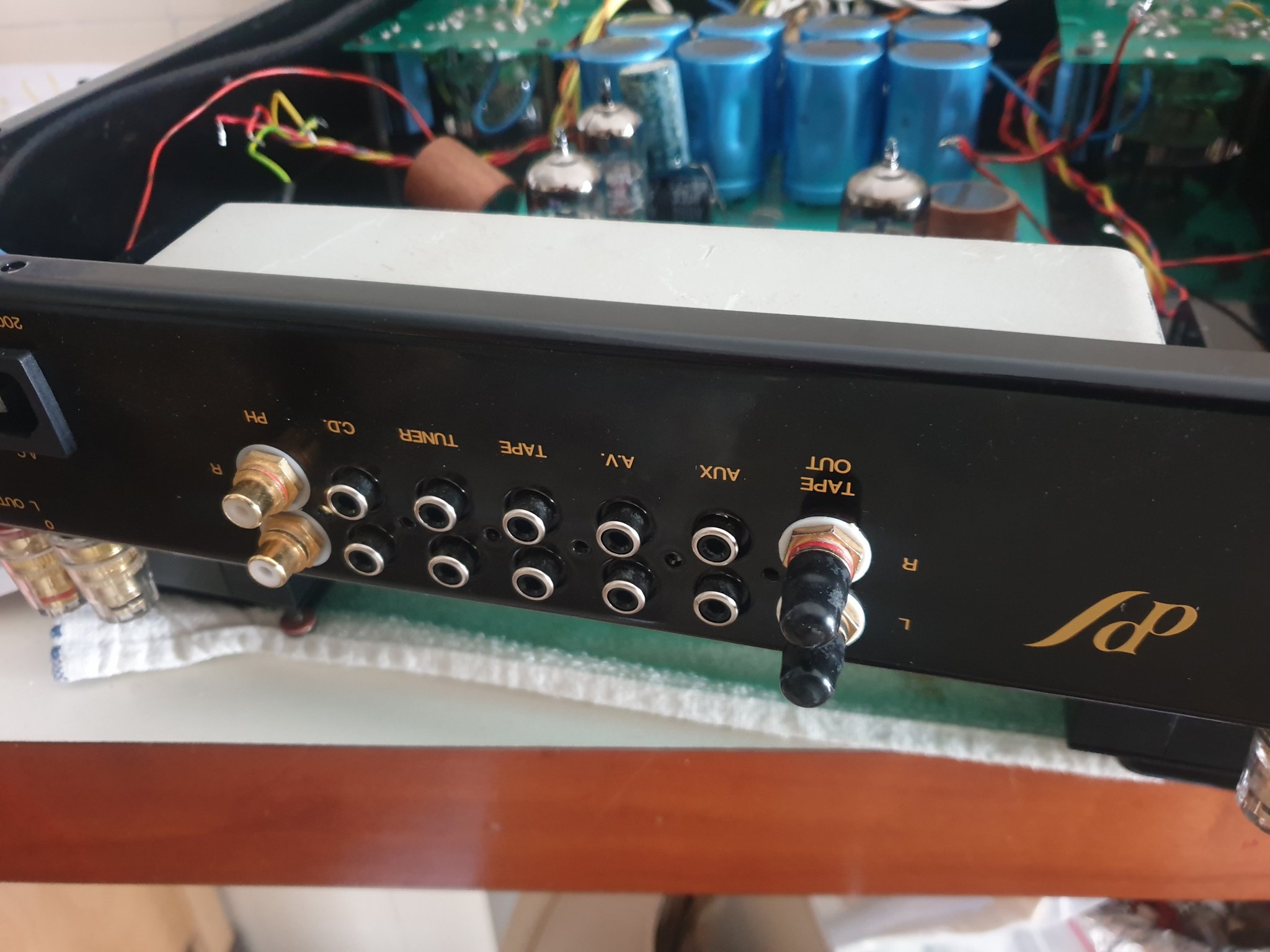

Will try to mod the fixed tape output to have volume controlled output for a subwoofer section..

Wondering why pin 7 was not connected.. I made a connection now b/w pin 7 and 2 and spatial information in the output sound seems much improved, for good! I am at the 4ohm output tap, will want to go back to the 8ohm to check if this would have been best in the first place with my speakers (Pawel Ensemble Reference monitors, which are specced at 4ohm, due to a couple of 4 ohm dips in impedance at low frequencies).
As for resistors (apart from an added 1k resistor at grid of first valve which is not noted on the schematic), the 10M value of resistor in parallel with 0,022uF cap is "only" 3,3M.. not sure what this does but wondering whether I am loosing some/too much bottom end.. will add a pair of 10M resistors in the next order in any case.. btw measured voltage of upper first valve cathode is about 150VDC whilst this should be 120-50VDC (from 70VDC to 120VDC iirc) according to specs.. also wondering whether the 10M resistor is participating to first valve bias?

In the meanwhile I temporarily installed an Alps 100Klog pot and modified the tape output to have volume controlled tape output for subwoofer duties.
