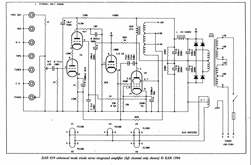

hi all
i thought i would try to resserect this thread as i have built a ear 859 se clone but i need some help/advice.
i find the top end very rolled off,i noticed that someone mentions a printing error in the schematic regarding the feedback loop,ive built using 47pf x2 per channel in the feedback loop,is this my problem and should they be infact 4.7pf,would this re -address the treble issue? also i wanted to use silver micra in this postion but they only seem to go up to 500volts rating as in the diagram its showing 600+? is that right or can i get away with 500v rating.
would love to hear anyones views/experiences regarding building and using this amp along with ideas and tweaks,and ideas and surgesstions regarding output transformers as im using r-cores of unknown make quality or specs.

I found 4.7pF worked well and assumed this was one of the errors referred to.
As for voltage rating, the peak on the anode could theoretically reach twice the HT volts, so I would use high voltage components to be on the safe side. I think the OPT primary was about 6k8 gapped for 90mA, but I might be wrong about that as it was a long time ago.

The roll-off capacitors will not be working within the audio range, so I personally would have no problem using high voltage ceramics from Cricklewood Electronics.
Although the curves are triode-like, screen drive gives a pentode-like ra so I would not make the load too low. Whatever you use is very unlikely to perform as well as the original, and I think I got my figure by measuring the voltage ratio of one of these.

The output Transformer impedance on the primary is nominally 5K Ohm.
The capacitors used in my product are 47 pf and are 500 volt Mica or were Philips 630 volt Polyprop (now discontinued) Ceramics produce non linear distortion, I never use them if I can help it.
The combined 23.5 pf was for stability with capacitance load on the speaker side. You might have reduced the value due to a poor output transformer and wishing to make 20 KHz ruler flat, Not my minus a half dB,
Farnell do have some 47 pf at 1000 volt polyprop capacitors now.
As an alternative, you could as I have done in the past use a piece of RG178
coax at 103 pf per metre, good for 3KV peak.

Obi Wan, There is no error, I stated 47 pf with two in series making 23.5 pf.
Please I did this to make good stability into high capacitance loads such as QUAD ELS speakers.
I did state minus half dB at 20 KHz Of which I am sure you golden ears lot can hear perfectly every time?

Not an upgrade in the home. KT88 can be made to work but requires way to much drive to be able to get full output. I stated 20 years ago that the EL509 or PL509/519 are ideal for this, Oh and linearity is superb thank you.
My later version with an added extra valve to make it bias accurately without selecting valves added cost to original.
It was made to an affordable price point, Hence the world wide success.
My question is "How long is a piece of string?"
Finally, trying to add motional feedback is not very clever as there is precious little spare gain. The feedback in the original is only 7 dB.
All deliberate in the original design of mine.
