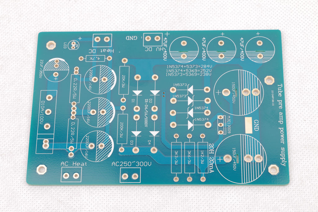

I've ordered these two boards to make an EAR 834 clone but I can't work out from the PSU board whether it's designed to produce 6.3 or 12.6v heater voltage. The seller isn't responding and I want to get a transformer ordered. Can anyone shed any light on this please?

Actually you can do both 6.3V and 12.6V with this board - it's just a rectifier with a CRCRC filter.
However the design this was cloned from is intended to get 6.3VDC from the 6.3V/2A transformer winding. And given that 16V rating of the capacitors is a bit too low for 12.6V application, and that you'll have to play with R values in the filter to get to the desired voltage in this case, I'd go for 6.3V option.
