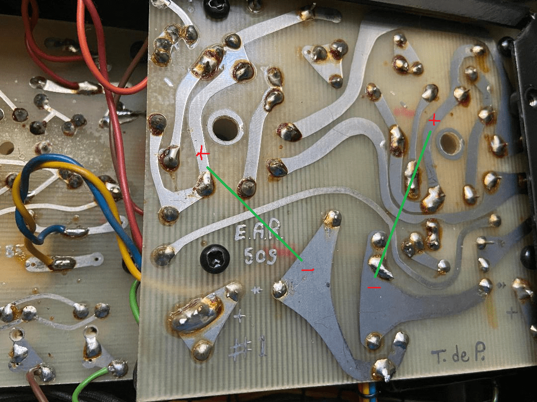

I've been staring at the schematic trying to figure out how to bias the amp. I see the two trimmers, and the two + points on the output tube board. Nothing is labled though. The schematic I'm looking at suggests 600mw across the test points. What?
According to my schematics, there are resistors of 15 ohms between the cathode and the OPT connections. 600 mV across 15 ohms means 40 mA cathode current, which seems to be reasonable.

Hi Kay,According to my schematics, there are resistors of 15 ohms between the cathode and the OPT connections. 600 mV across 15 ohms means 40 mA cathode current, which seems to be reasonable.

Where are your test points? It would seem one would be on the OPT?

They're across both 15R resistors, the positive one at the cathode, the negative one at the cathode winding terminal.Where are your test points?

600mV read directly through the 15 ohm resistorHi Kay,

Ok Ok. I must be doing something wrong because I'm getting voltages that seem too high. I need to figure out the PCB layout. Once I figure it out I'm going to add better test points!
Well, that shouldn't be too difficult. Cathode pin is #9, which is also connected to the beam plate pins #2 and #7. Easy to find at the PCB, the trace to these three pins is clearly shown at your pic. The cathode resistor most probably is a big
wirewound one, due to it's 4 W rating.
I'd do the following: First pull both PL509's and power the unit. Measure the control grid voltages (pins #1 and #8) and adjust the bias trimpots to their maximum values. Power off. Insert the PL509's (don' forget the plate caps!), turn the unit on again and adjust the bias potentiometers for 600 mV across the cathode resistors. Repeat the last step at least twice. Done.
